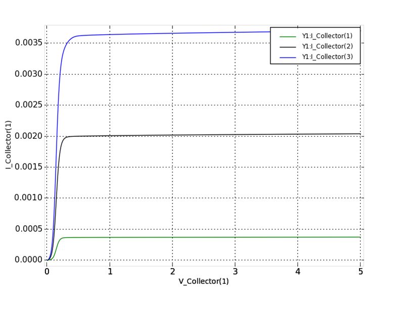

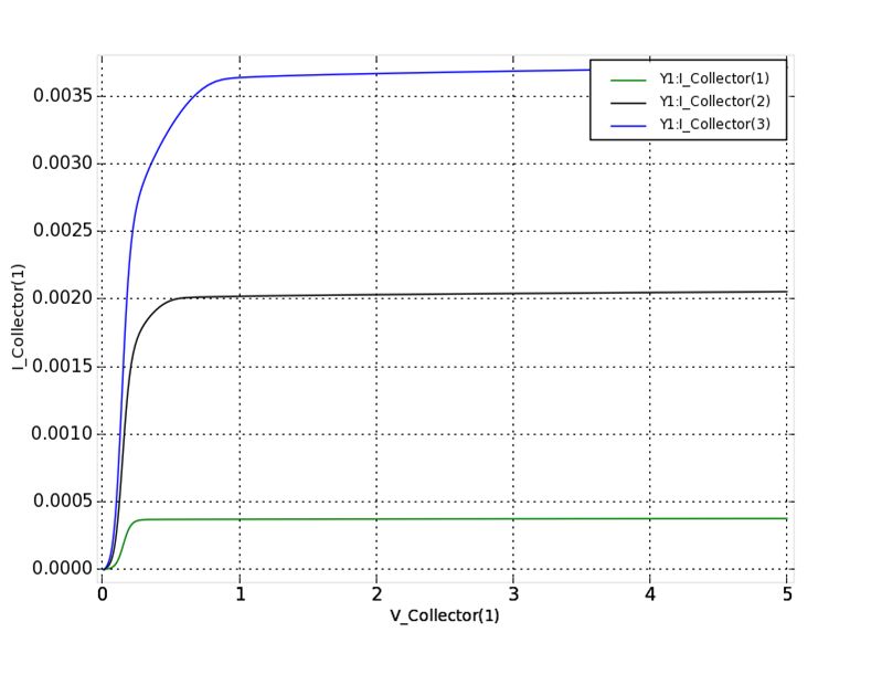

I am working on a preamp project with + / - 35V rails. The output transistors are KSA3503E and KSA1381E. Near clipping, with a triangle wave, there is crossover distortion and some other visible nasty traces.
After finding this thread, I performed a curve trace of the KSA3503E and the quasi-sat looks rather horrible. Curves are attached.
Then I rummaged in my stash and traced the curves for a BD139 which look much better for quasi sat. Curves are attached.
The preamp deserves a build with the BD139/140.

Quasi-saturation appears to be the compromise you make for low capacitance in the 3503/1381.
The BD139/140 is hard to specify for any DIY project due to the fact that it's completely different depending on which manufacturer you use.

They are Fairchild BD139-16 parts purchased from Mouser probably 6 years ago.
Looking at the static bag markings, I purchased 25 pcs each of the 139/140.
Beta for the 139 traced is 200.6 at 30V at 10mA. Beta is higher than the typical KSC3503E, but the BD139 cannot be used at high rail voltages. Not a problem for this project as I will use it to drive a low-ish voltage MOSFET OPS.

For the KSC3503E/KSA1381E, I suppose that I could add 10V to each rail and stay 10V away from clipping at each rail.
1. I assume you realize that KSC... and 2SC... are ~ the same thing. 2SC3503 are available from other makers.
2. You don't need a 300V transistor for +-35V rails. (70V)
3. BD139 has "better quasi-sat voltages" largely because it's a higher current device, but that generally means slower.
4. IE, look for a 1~4Amp transistor in the same package: My choice would be mje243, mje253, which has real low "on" voltage.
5. mje340/350 are much like the xSC3503/xSA1381, but seem to have better saturation voltages.

Thanks for the reply. Good points.1. I assume you realize that KSC... and 2SC... are ~ the same thing. 2SC3503 are available from other makers.
1. From a cursory search, they appear to be obsolete, at least according to Mouser and Digikey. I have enough for my builds.
2. Agreed. Once I am happy with +/- 35V rails operation, I may have a desire to use higher voltage rails. Direct driving Stax headphones is on the list.
3. Slower is ok.
4. 5. I will probably order some of both and run the curves and build up a channel to characterize.

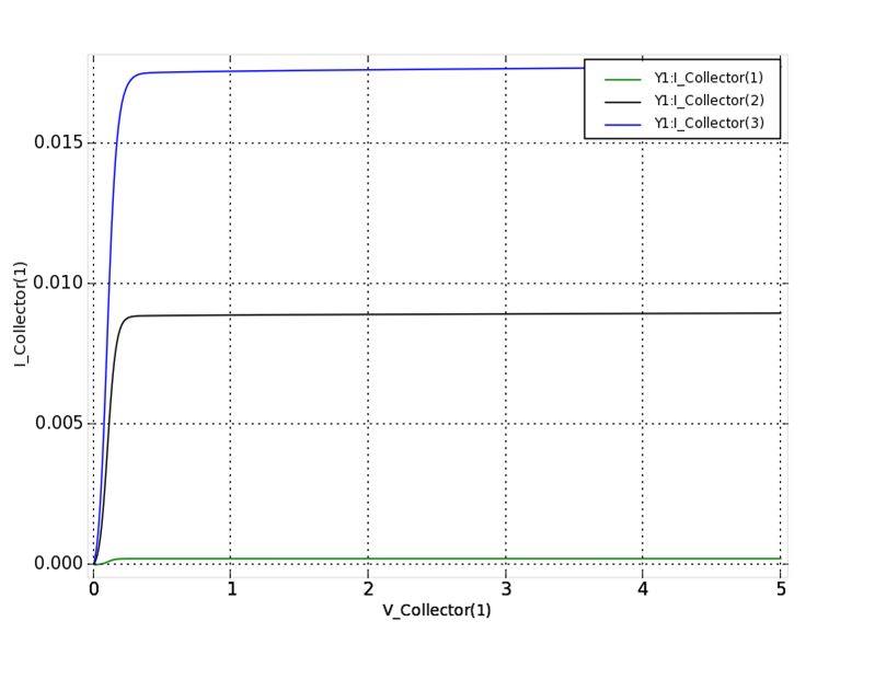

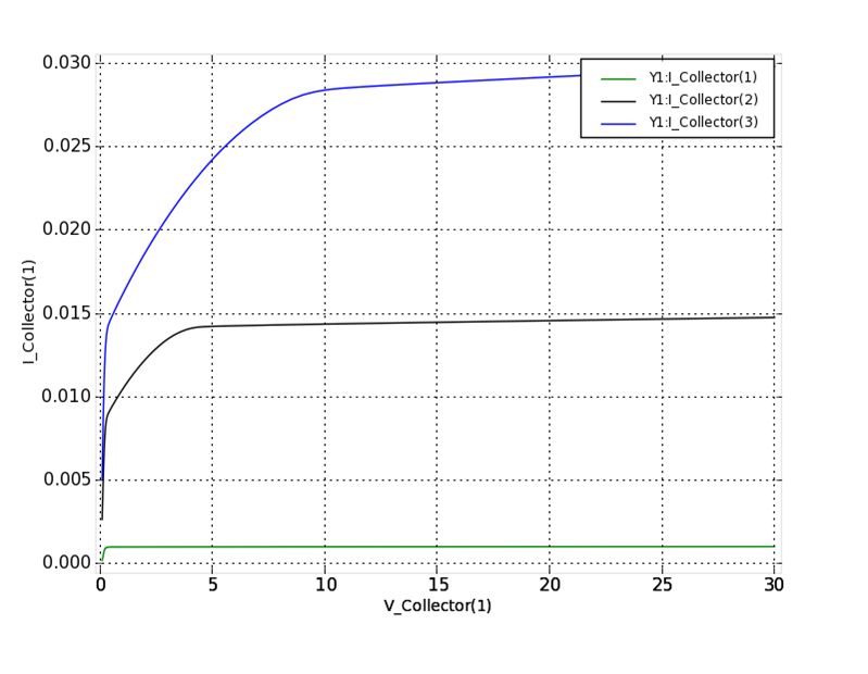

If you look at post #16 of this thread you'll see a 2SC3503 (admittedly not a KSC3503) exhibiting loads of quasisaturation.
If you look at post #55 of this thread you'll see a medium-power TO-126 device with none whatsoever. I learned about it by reading a book (AoE 3ed)

Hi Mark. Thanks for the pointer. Yes the BD437 looks excellent from a quasi sat standpoint. The downside of the BD437 is only 45V Vceo max. ...and... it looks like ST is end-of-life on that part. The big brother, BD441, is obsolete from ST. On Semi, has the BD441 in production.
So, using the 3503E/1381E, I could crank the rails to + / - 45v and possibly get 60v p-p output without the quasi sat problem. I would have to live with the extra heat.
At the moment, My power supplies run out of gas at + / - 35V. Time to buy a new power supply!
The great advantage of higher voltage power supplies is: you can buy them today, from multiple sellers! This may not be true of super deluxe wonderful non-quasisaturating transistors.

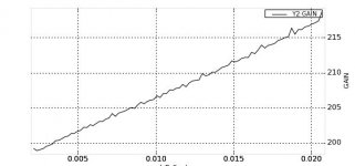

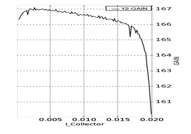

BD139 gain vs KSC3503E gain
The gain of the KSC3503E is flatter compared to the BD139.
It appears for this limited comparison that the good quasi-sat behavior comes at the cost of less good gain flatness.
Which behavior is more important?
For the circuit I am experimenting with, the square wave distortion begins long before the peak voltage comes within 10V of the rails.
I will build a version with the BD139/140 and see if the square wave behavior is improved.
