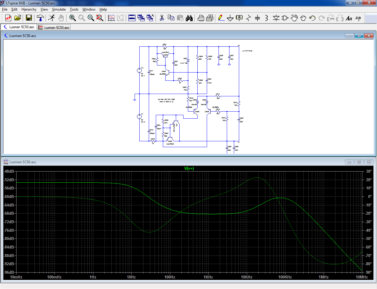

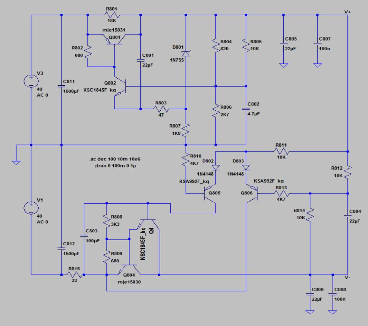

As one of the preamps I will be building is based on the Luxman 5C50 discrete preamp, let's start with the original manufacturer's PS for it.
Those shown are the original transistors, which do not exist anymore. So I started by looking for modern replacements and try to simulate it in LTSpice.
My LTS simulation only shows the output regulated voltage, but the curve is not right. Perhaps someone can correct what is wrong and fix it.
The idea is to simulate as much specs as possible.

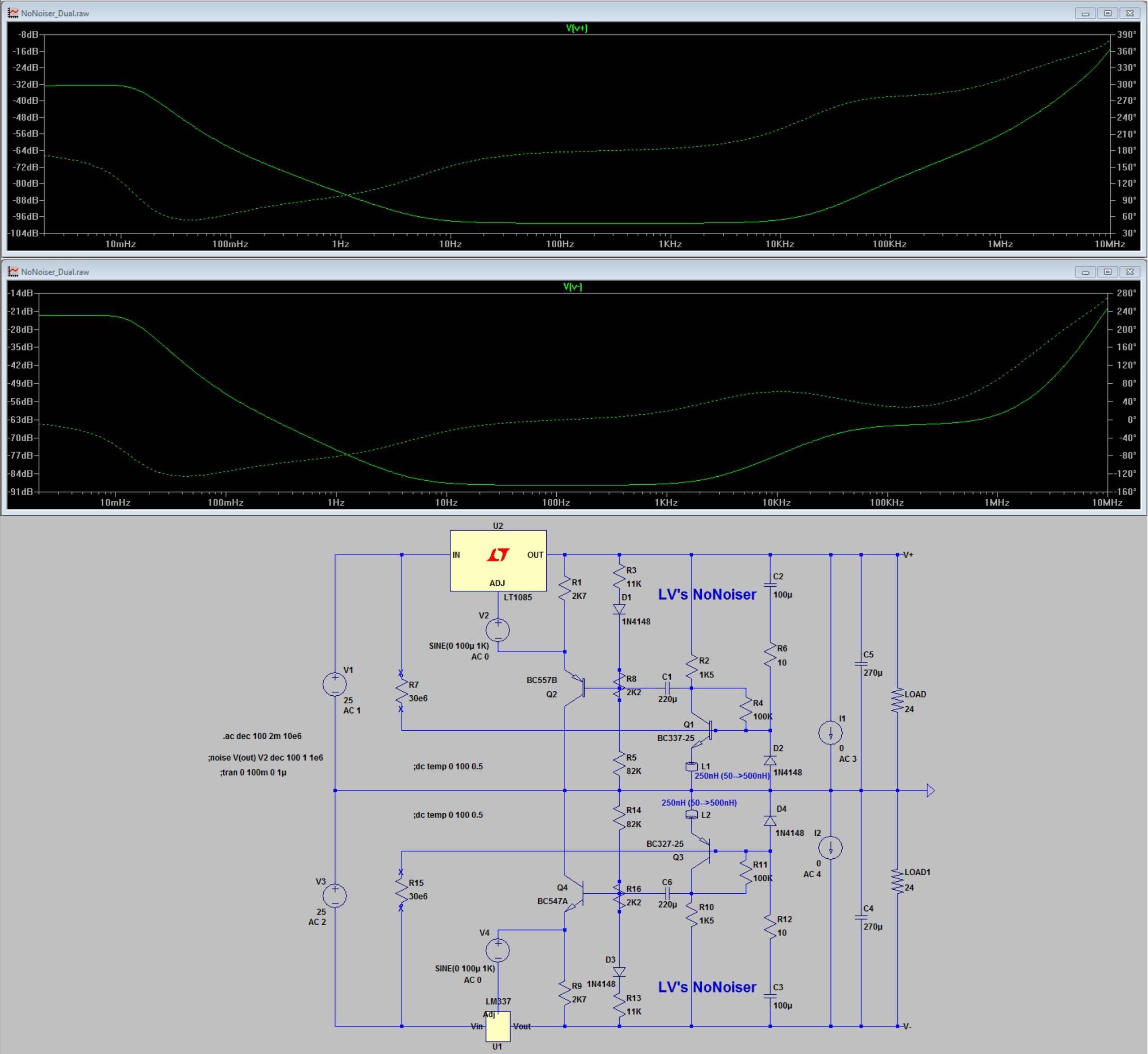

Next in line are the Jung/Didden superregulator and LV's Dnoisator and NoNoiser. And perhaps some other one someone may suggest.
You need to make the source you test AC1:
attachment.php
The circuit is basically a 2-transistor reg + a negative slave.
The startup method using R801 as a shunt is not very subtle or effective: it injects some of the raw input into the output and will degrade the DC/LF PSRR, and if the load is a bit difficult, it will fail to start
I think you don't understand the way ACx works: ACx is the small signal stimulus, x being its amplitude.
Normally, we use AC1, because the graph is plotted wrt. that amplitude.
Sometimes, in transmission lines system for example, it is convenient to use AC2 to renormalize the graph after going through a line and its terminating impedances, but when there is no particular reason, 1 should be used.
In principle, we use one stimulus at a time, because injecting multiple stimuli here and there results in an incomprehensible mess.
Sometimes, multiple stimuli can be used: for example if V+ and V- have no circuit in common, making the two input sources AC1 allows the simultaneous testing of both channels in a single pass.
You might also want to examine the combined effect of synchronous input and output perturbations (not very realistic, but why not).
Otherwise, test one parameter at a time: input source for PSRR, output current for Zout, and switch off any other unused stimulus.
Your results will look more appealing
You are right that I do not understand how ACx works.
Can you please modify the asc file adding these changes? Perhaps then I can learn how to work with it.
If I'm going to compare regulators simulations, the variables have to be the same.
I already simulated the Dnoiser that's being analyzed on the Noizator thread, but it's quite certain the variables and other stuff are not right in order to make a comparison.
OK. 337 added and working.
What resistors do I trim to get to the output voltages I want?
I thought that splitting R8 and R16 in two resistors each, up and below Q2 and Q4 base, would give me that. But my try with my other sim didn't work.
Or is it that way and some other thing was wrong?
Yes R8 and R16 should be adjustable potentiometers, but in the sim the three terminals are shorted to yield the nominal output (=midrange).
They are usable for fine-tuning only. The initial dimensioning should be based on R5 and R14.
Somewhere in the thread, I have given the formula's to compute the value: one is simplified, the other is unabridged.
In order to understand this, you need to know the following:
The voltage between LM317 OUT and ADJ is ~1.25 V.
A BC557 E-B will drop another 0.65 V or so.
This gets us ~1.9 V down from the output.
Now this voltage will also appear across R3 + D1. (Assume R8 shorted.) If we approximate V(D1) ~= Veb(Q2) and Ib(Q2) negligible vs. Vout / (R3 + R5), then V(R3) ~= 1.25 V and
1.25 V / Vout = R3 / (R3 + R5)
Or in plain German,
Vout ~= 1.25 V * (1 + R5 / R3)
Which in turn you might recognize from the plain Jane LM317 circuit.
If you say you want to keep the current in this resistor divider constant, that means R3 = const, and Vout can be adjusted via R5, like Elvee says.

OK. As the Luxman will need +/-30v regulated, I entered 40V into each input V and got +29.97 and -30.87. That would have to be trimmed on the actual regulator, apparently with R8 and R16.
Can't R8 and R16 be fixed values, instead of a trimpot? Then paralleling larger resistors with R5 and R14 would do the trimming.
If you don't need a continuous trimming and use paralleling for adjustment, you can delete completely R8 and R16, make R3 and R13 a more convenient E12 value, like 10K or 12K and adjust the voltage by paralleling R5/R14 with a high value, suitable resistor.
It will be less noisy, and more stable in the long-term than a trimmer.
Note that unlike the regular LM317 circuit, this one is much less sensitive to trimmer imperfections, because it is used in potentiometer mode and the wiper current is very low, thanks to the buffer transistor

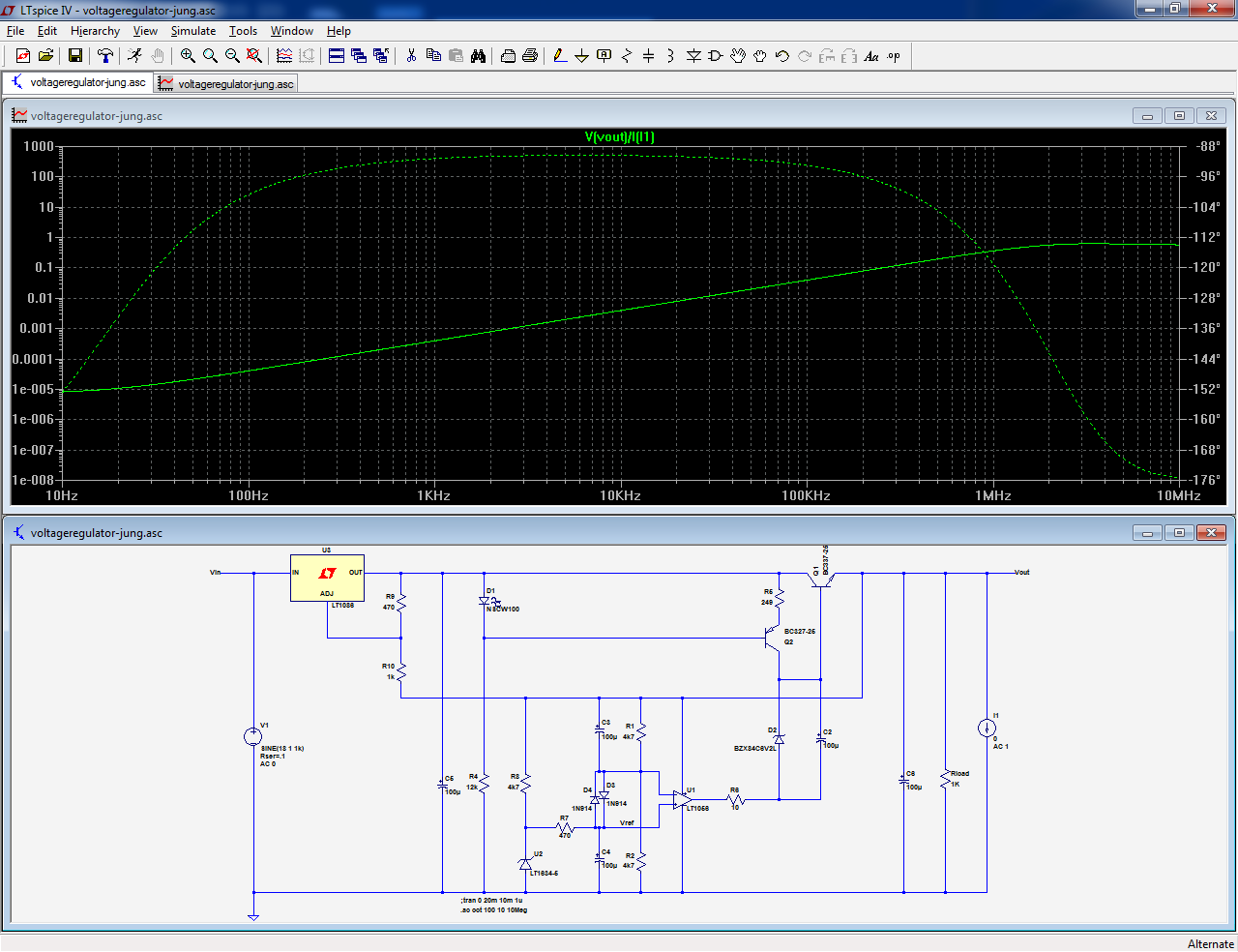

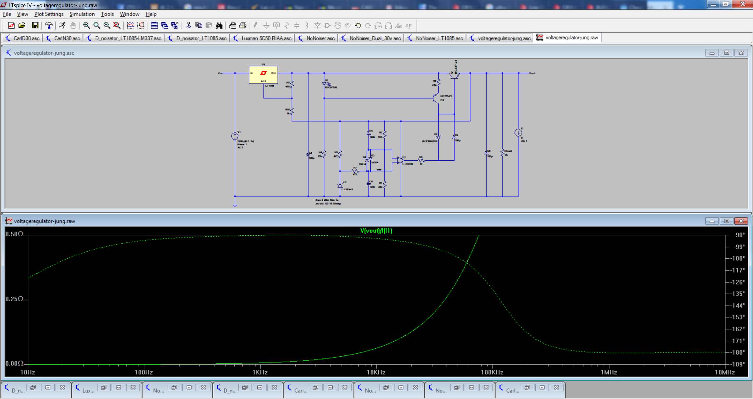

Uploaded is a superregulator simulation I found here in DIYAudio. There might be others.
In this case none of the important parts, opamp and main transistor are those recommended by Walt Jung or Jan Didden. The right models were not available.
Now I would like to learn to use LTSpice to run PSSR, noise and impedance, and also compare with other regulators.
It's not correct because a)the regulator is broken, for some reason it does not work with the opamp you have selected, and b)you didn't turn off the AC1 input stimulus for the impedance measurement.
Using a more normal opamp like the LT1056 yields more realistic results:
