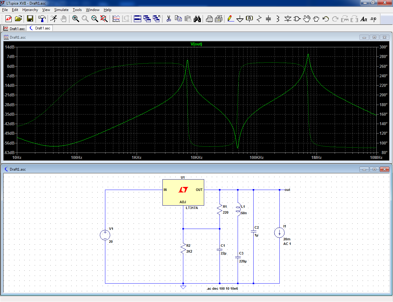

Like I said before : after seeing Elektor putting ceramics with E cap's at the output of LM and 78xx regulators for decades , I did the same , I didn't think the DN could get upset by a mere 1uF or even 100nF.
Elektor is what it is, but paralleling capacitors can sometimes make sense: one E-cap directly at the output of the regulator, and a ceramic bypassing the point of load: logic circuit, opamp, etc.
Sometimes, adding a small series damping resistor (1 ohm f.e.) can help a lot.
As a picture is worth a thousand words, here is an example of how a regular 317 behaves with just a good ceramic at its output.
The graph shows the output impedance with a static load of 20mA:
attachment.php
You can see an obvious peak at ~100kHz. Not too nasty, but the reality is somewhat harsher.
Now, use something like your combination (an inductance of 50nH is realistic for the tracks+internal cap inductance):
attachment.php
You see immediately that the situation has been degraded and complexified, with 3 resonances.

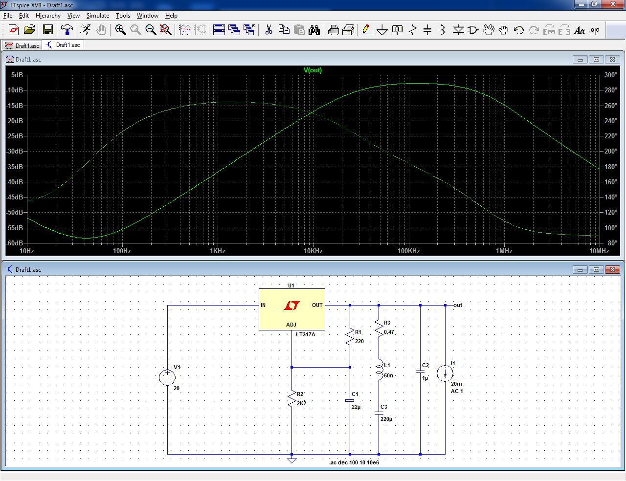

With just a 0.47 ohm damping added somewhere, things become much more relaxed (note the vertical scale):
attachment.php
You could think that all this is simulation and is not reflected in reality, but somewhere on this forum I have posted real VNA screenshots showing exactly the same thing.

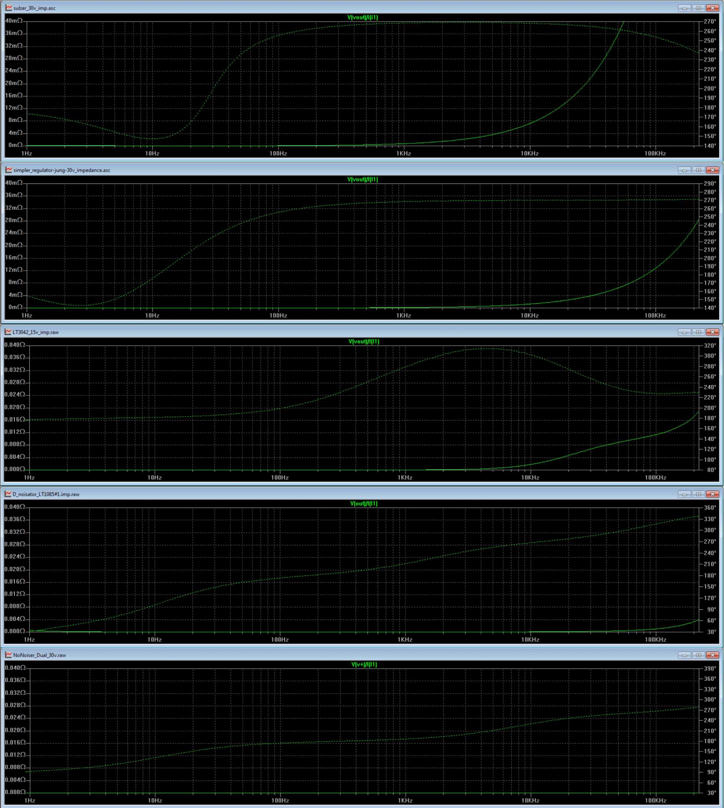

Following my research between top notch regulators, this time I compared output impedances.
The name of each regulator is on the upper right.
Some similar limits were introduced to make the comparison valid, in horizontal frequency and in vertical mili ohms.
Some results were so low, that a new comparison might necessary to raise them somehow, or adding the numbers in characters for comparisons.
The NoNoiser seemed to take the maximum honors in Lowest impedance for the bandwidth chosen.
Schematics and asc files are available for checking.

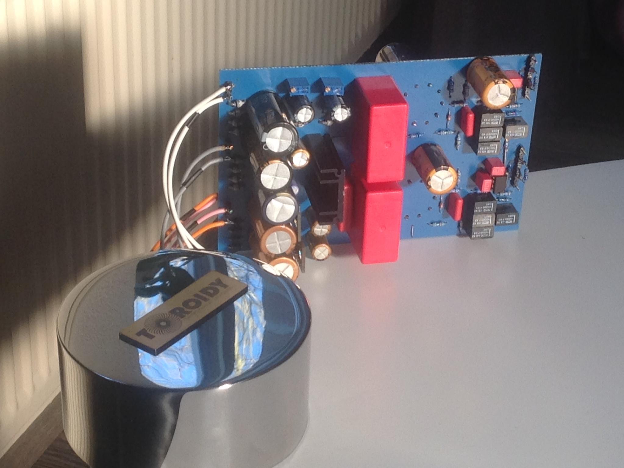

I use also TPS regulators for my riaa hybride preamp. They are super.
