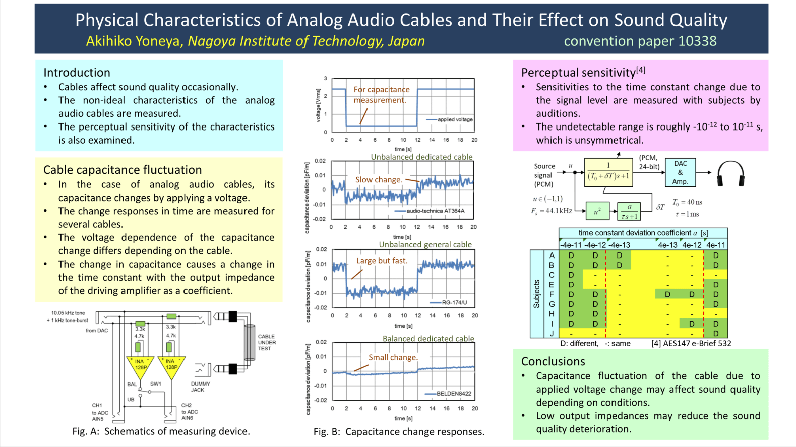

Regarding speaker cable, if you haven't seen it before an interesting document attached below. Again, RF type considerations are involved.

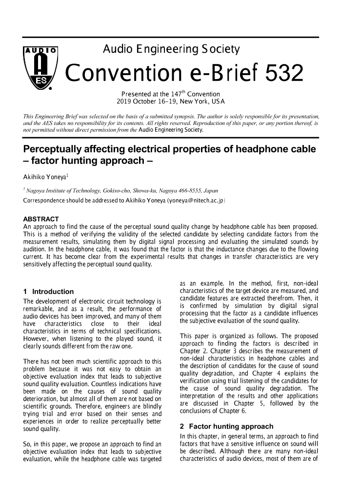

Also some published work on line level cables and headphone cables. The latter article is behind a paywall: https://www.aes.org/e-lib/browse.cfm?elib=20555
  • Bateman_Speaker_Amp_Interaction.pdf
  • Physical characteristics of analog audio cables and their effect - AES.pdf

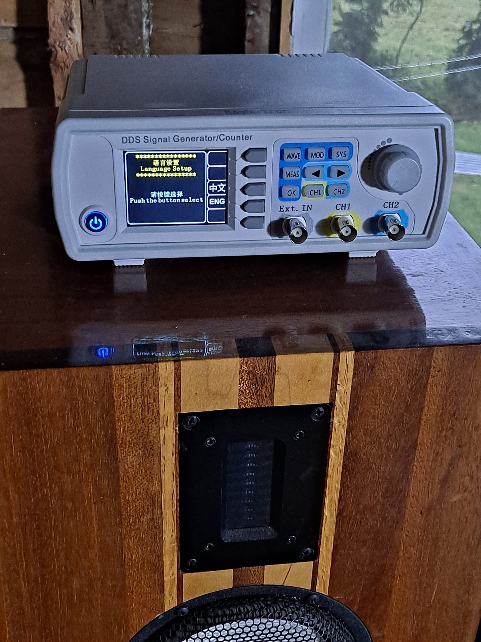

I wanted to share that I received the little Koolertron GH-CJDS66-A today. Hopefully within the next couple days I'll have some time to play around with it. My initial impressions are that it is very lightweight, and there's not very much going on inside of it. However, the screen seems to be easy to read, the interface seems nice and the buttons feel good.
I will post my impressions hopefully within the next couple days after getting a chance to use it. Thank you for all of your suggestions. Don't mind the dirty speaker and the gutted wall. I am in the middle of a remodel.
