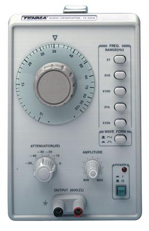

So I ended up getting the signal generator that I ordered quite a while ago. The unit I received had an issue with the main board. They sent out another and I replaced it. I finally got around to using it and It works great!
So I am happy to finally have a nice clear square wave to check for oscillations. Thank you for the recommendations guys.
