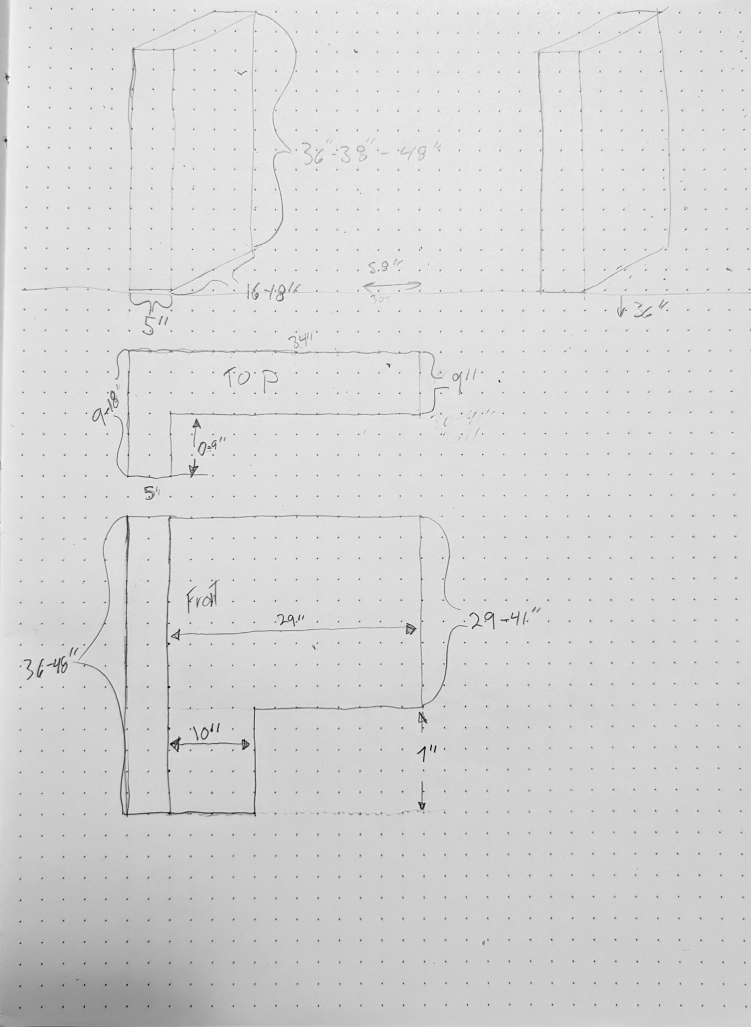

The wife has decided a tv is needed in the bedroom. So the large 12" pioneers wont fit anymore. Due to drawers, doors, etc I have only 5" both sides, and ~16" deep, but 36-48" tall.
There is an additional 9" behind the tv as well. Ive added a sketch of the working volume.
Would like to get close to the ol 20hz-20k (a sub is allowed if it fits) normal volume is only 60-70,db. But 85-95 db would be nice at 10-50watts for special occasions. No DSP, passive crossover.
Have built 3 sets of 2way ported+CD horn, and a cornscala type build, and half dozen sealed subs. Would like something different! But not too crazy.
Been checking out the Cyburgs-Needle, Perry's shaded array, the bourbon barrel, frugal array etc... all slim stuff.But would love to use more of the space behind the TV. Would love todo some horn stuff.
Budget wise 500usd max 250usd preferable, cheaper with an upgrade path is nice.
Thanks for your thoughts!

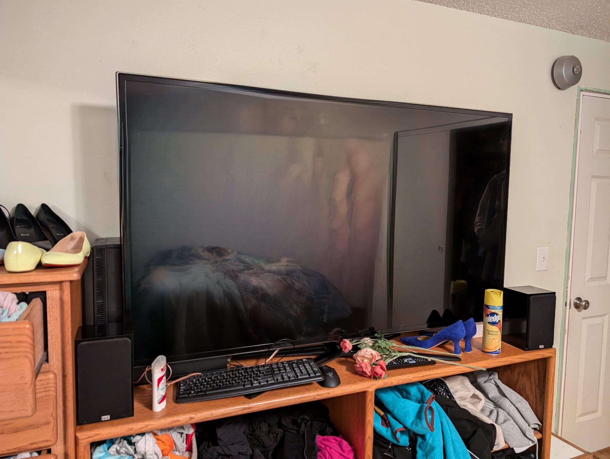

Sorry but I can’t envision what you’re asking here from the included drawing or text. My best guess is a stand mounted TV (how big of a screen?) mounted on top of some kind of existing dresser or something that’s against a wall in your bedroom?

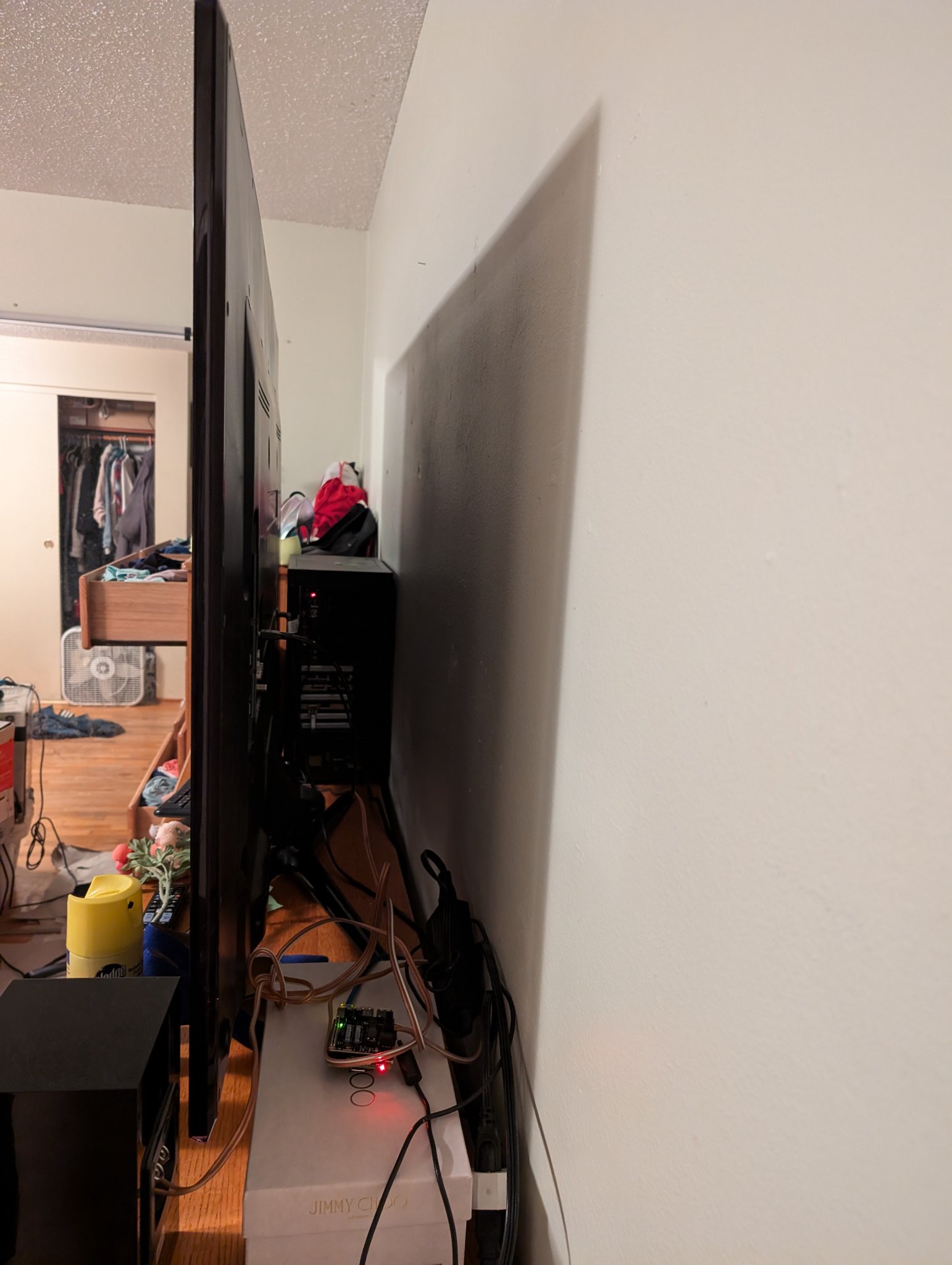

Mayhem, your vision was pretty much perfect, the the tv is sitting ontop a book case, to the left is dresser, to the right, the doorway
I've attached a pair of pictures for the space i have to work with for full contex. The dimensions on paper in prior post reflect the space beside, behind and around the TV i have to work with.
Hot off the press! Apparently the space above has also been approved for speaker use! But uh, no boundaries provided....

I dont expect much down low, almost nothing if i use the 5" limit.
But ive got 29x29x9" behind the TV... Sure its gotta work around the TV, but below 100hz it might not be an issue? Down firing exit under the TV?
