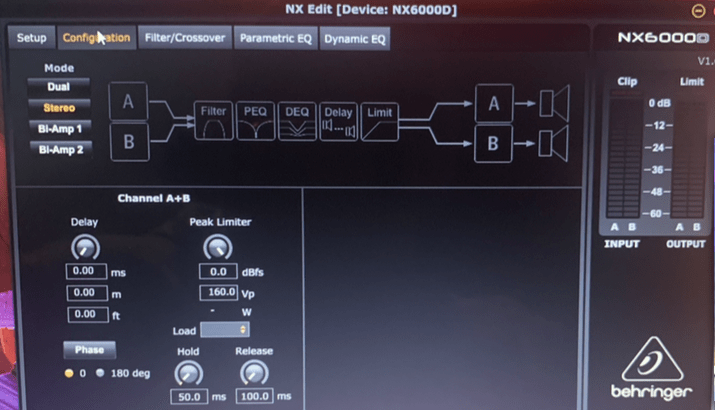

Hello,
i wanna finally dive into subwoofers and wanna build my first pair
i probably will still be using studio monitors for a while as main speakers, studio subwoofer and some diy subwoofer pair quite nice with studio monitors because they include a crossover to implement the subwoofer
i was looking at the Crown XTI series, probably my best bet if i wanna have an external amp where i can easly implement subwoofers in my setup
but i was wondering... are there any alternatives? specially class AB would intrique me, i basicly need an amp with an lowpass... and preferably XLR passtrough
Thanks in advance
Class AB is only about half as efficient as class D, so twice the heat and fan noise (and weight) and double the draw from the mains power.
The Behringer NX 1000D (2 x 500 Watts @2 Ohms; 2 x 300 Watts @4 Ohms; 1000 Watts into 4 Ohms bridge mode)
3000D (2 x 1500 Watts @ 2 Ohms; 2 x 900 Watts @ 4 Ohms; 3000 Watts into 4 Ohms bridge mode) 6000D (2 x 3000 Watts @ 4 Ohms; 2 x 1600 Watts @ 8 Ohms) all have built in DSP:

You could use female to dual XLR male XLR "Y" cords for pass through.
i mean i found something like the Avantone CLA-200 .... but i would need an additional active crossover, which i kinda wanna avoid unless its analog
dps inside the amp has the benefit of the DPS chain only applied to this specific channel, so its probably the way to go
i also found the Crown XLS series which is well regarded (but class D)
in regards to these dsp amps im most curious about new implementations of like new hypex/purifier modules if these even exist

well the crown XLS doesnt measure "that well" are there new pro audio designs in the hypex nilai direction with dsp?
but im probably landing on the same conclusion here... go with active crossover and use whatever amp, but i heared what different dacs and opamps can sound like... i kinda wanna avoid your usual active (digital) crossovers including dacs/adcs
I'd use any stereo amp of your choice together with a very basic line-level low-pass filter. For me, the key to a good system is to limit the points of adjustment.
Pick a filter frequency, e.g. 60Hz. Set the volume control on your sub amp . . . and leave it alone. All eq can be adjusted from the console.
Personally I like to set filter frequency close to the bottom of the full-range monitor response. This ensures the full-range capability of the system with subs switched off.
