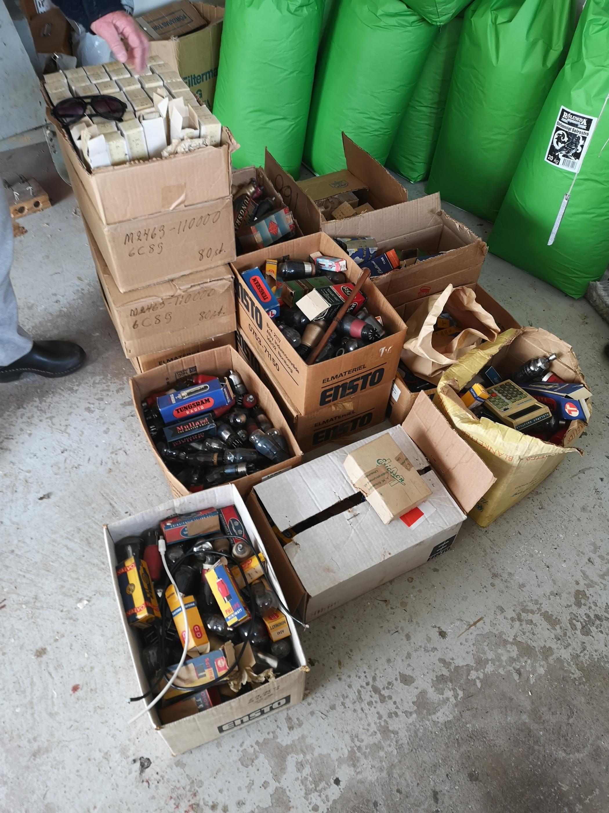

Hi, my dad called me up and asked if I could have a look at some old "radio tubes".
I asked him just to tell me what it said on the boxes.
"Well, you better get in the car and drive over here instead".
So I drove, and then my jaw struck the garage floor.
There where thousands of them.
A few hundred in boxes and far more just mixed in cardboard boxes. No info regarding if they are used, new or broken.
So, I guess that I have some sorting to do and I might as well look for a way to separate the bad from the good so I can sell them.
So.... What do I need?
There is a sub 100$ machine on eBay which has its own thread here and then there are DIY versions.
But I have far to much to do and expenses to go with them.
So budget and time is in short demand.
So advice is appreciated.
Kind regards!

Looking at your stash, you will require an older type of valve tester for the old valves.
A lot of the newer testers have not got the bases to fit.
If you want to build one, grab a known good design, select the bases you require, the pin outs you need and put it together.
If you were in the UK I have an AVO 160 that I can test them all for you but knowing the Swedish Customs people, they will charge you tax on any returns from testing.

One thing about testers. They can tell you a tube is bad, but they really are not good at telling us a tube is good. If a tester says bad tube, I believe it. But testers rarely put real world voltages and currents through a tube. And testers rarely test for noisy or for microphonics.

The actual cheapest way is to get an old amplifier and try them out --making sure non have shorts to the elements first.
