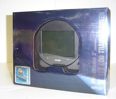

Look what i just won on Ebay :-)
ebay link
This thing has better stats then the PS1 screen and cost me half the amount.
Total is $82.82 Canadian or $68.66 US
I can't wait to get it😎
I am going to mount it directly to my delta 78 lens and then use a 100watt MH bulb as a light engine. The the whole assembly will go back into my Sony 46" rear screen projection TV and can be watched any time of day:d:d:d
I'll take pics as soon as i get the lcd here.

That is the exact same screen/controller as the PS1 when you strip it you will see. I have one too, just the game cube verge version. look at the circuit board and you will see on the input connectors circuit traces labelled PS1 and PS2 😉 . Just a note I made a couple of mods I removed the jumper for the video that is inserted into the middle of the circuit, and directly inserted it into the correct connection. You can also do the same for the power, but I didn'd notice ant improvements. It uses a multipin connector to connect to the housing and power supply it is a pain to strip so I suggest getting a 7.5v 1 amp powersupply to power the the screen and insert the power directly into the controller board.

Well, the 5" lcd is actually too big to fit the delta 78 lens assembly. When installed to the lens it cuts off the picture around the edges. The delta 78 also has a condenser lens that was used when it had a crt tube in it but then it just blurs the edges. I tried moving the lcd back away from the lens but then the whole thing goes outta focus. I'm sure if i had more room that i could put a fresnel lens in there and it would work but no room 🙁
I already had the thought of building a custom box for it but there is only about 6" of room to spare in the TV's cabinet so no luck there.
If no one wants it then i'll just build a custom enclosure and use it as a projector or slap it in my van for the kids to watch movies on.
