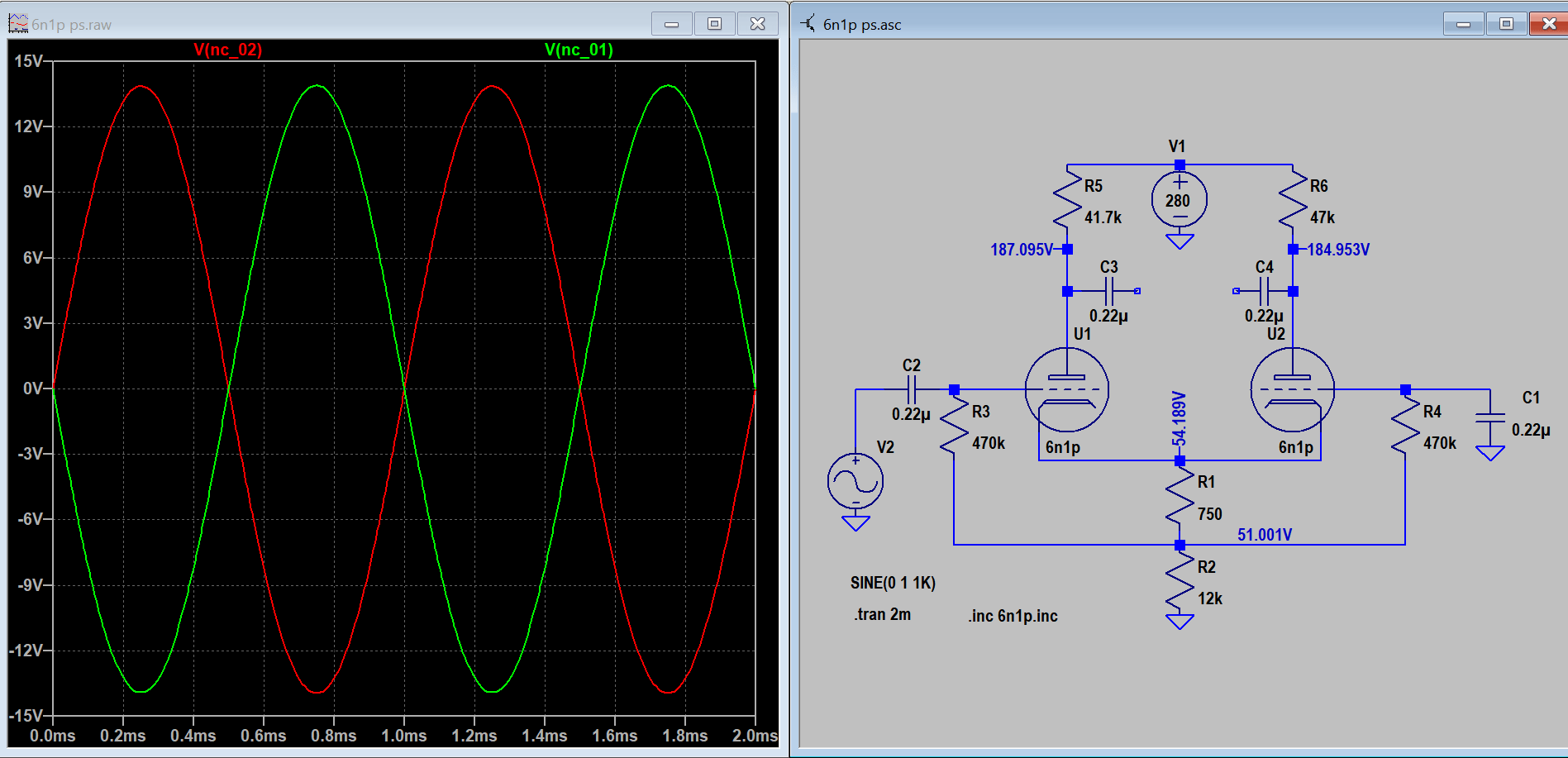

As was said before the voltages 290V - 280V - 270V are too close , only 330ohm resistor is not enough between the output stage and phase inverter and then 1K for input stage is not enough either
Look at other schematics , something like 290V - 250V - 200V is normal
Thank you for the suggestion. Ok, I added 1k to the 330r. Voltages now 284, 253, 237. Same issue. I used similar voltage range differences before for driver-cathodyne-power tubes without issue.
It's only when I connect the non-inverting section does the oscillation occur.
So both channels oscillate. You might want to disconnect the 1st tube (unplug) and inject signal into LTP and see what happens.
I have use LM317 with 6n1p, maybe it's the mismatch of impedance of the plate causing oscillation as plate resistor value is too far apart when 6n1p is used. Also the bias for LTP is only about 3V, with the gain of 14, the max. undistorted output is 52V. Try CCS approach if you can.
I tried the LM317 CCS. Should have started out with that from the beginning. It works, and like you say, about 52V before clipping and oscillation. At the speaker terminals max output voltage is 16vpp, Only about 4.5 watts output for 12W6 in triode push-pull. I was hoping for more. Anyway, I know when I'm beat, and I'm beat.

Well, from reading diyaudio threads actually. Used as a CCS it presents an almost horizontal load line for maximum voltage swing. I've used it as the load for a 6N1P driver for my 12W6 PSE amp, and also for the 6J9P driver for my 2A3 direct coupled amp. Works great.
