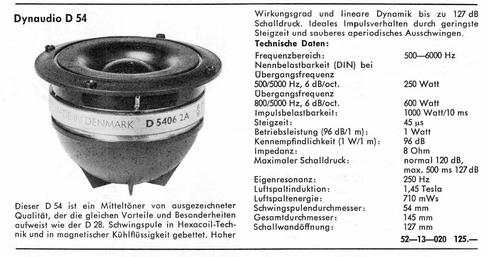

Are you sure you have Dynaudio D54 AF midranges?
From your pictures it looks like D54. Not exactly the same thing.
Some more data here:
https://site.diy-loudspeakers.com/images/datasheets/loudspeakers/dynaudio/MIDRANGE/DYNAUDIO_D54.pdf

According to post 27, dynaudio D54 has watt limit for 800-5000 hz of 600 W. I don't read that language well enough to know if it is music watts or AES watts. More than I need in a living room IMHO. sensitivity is 96 db 1w1m which could work well with a 97 db 1w1m woofer. No frequency response chart there. The eminence kappapro-12a cabinet design post 28 topped out at 800 hz. Note the eminence suggested designs maintain their rated watts. Kappapro-12a is 500 w AES. If one accepts a lower wattage limit to avoid exceeding Xmax at low frequencies, one can use a bigger box. Also a lower F3. My main music room amp tops out at 70 watts, another is 35 watts.
