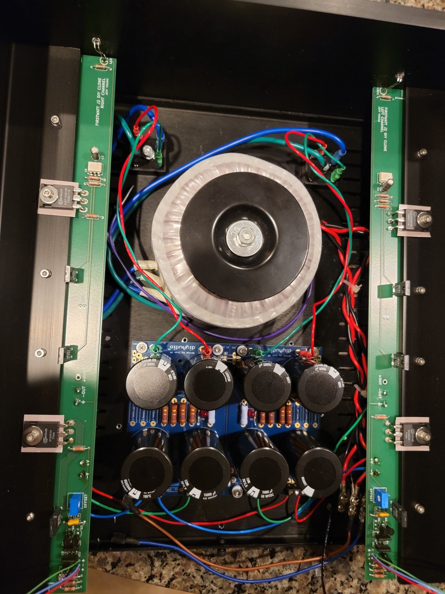

Yes I trimmed my J2 boards near the LED and cut off the portion and then made sure that the traces do not touch any of the chassis portion as I had used the 300mm depth chassis.@ meanie and manniraj

Finally finished the PSU, I am getting +-23.8V. It has been quite a while since I started this project, the end is now in sight.

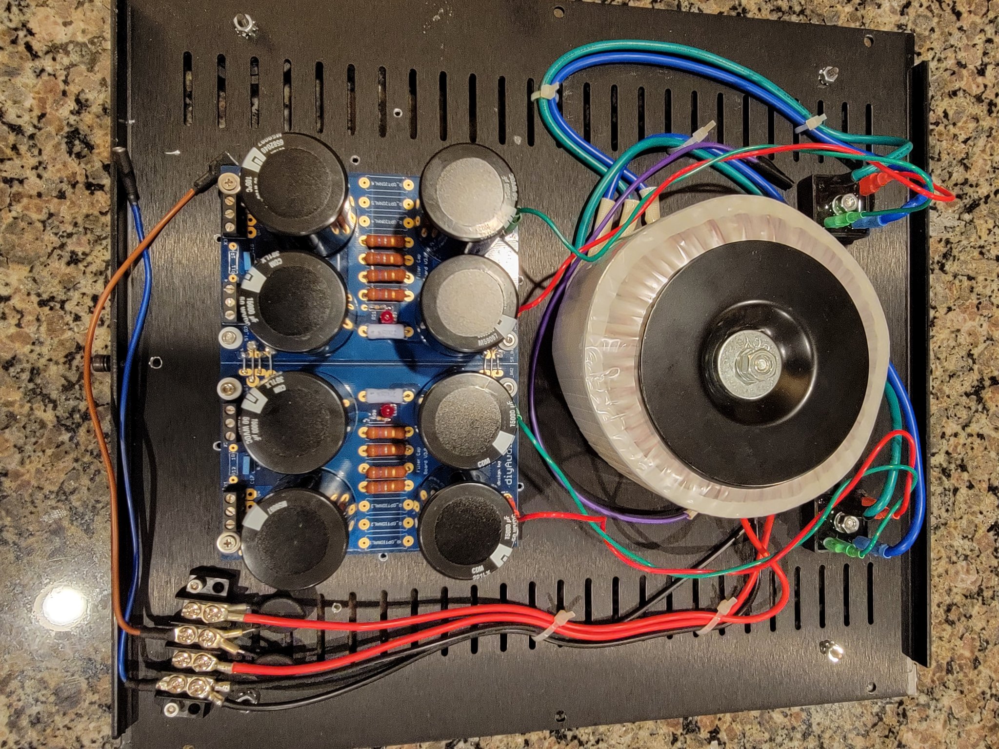

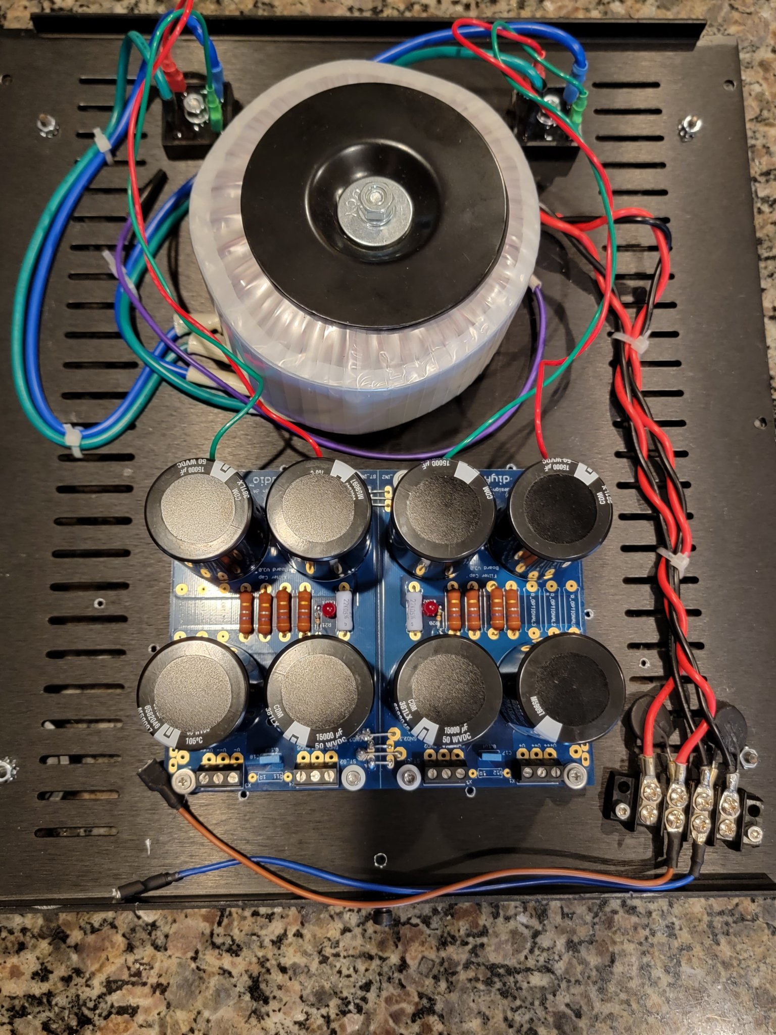

Reima - double check your thermistor hookups at the primaries against the schematic. I would also consider twisting the primary pairs together to avoid any potential noise issues.
According to the schematic (F6 PSU) there is a thermistor in series with each transformer primary coil (120V). Does it matter if the thermistor is on the live leg or neutral leg as long as there is one in series with each coil?
It will absolutely work the way you have it, but I believe splitting the thermistors between Line and Neutral is preferred.

I decided to bring the J2 to where I am spending most of my time. Today I finished the wiring and checked the offset. I got 0.001V on both channels. Tomorrow I will let it soak for a while and then recheck the offset.
Suggested to have the thermistors "laying" on the top side of the primary wires with the bodies bent up into the air. They will get warm with operation and shouldn't be in contact with anything.
