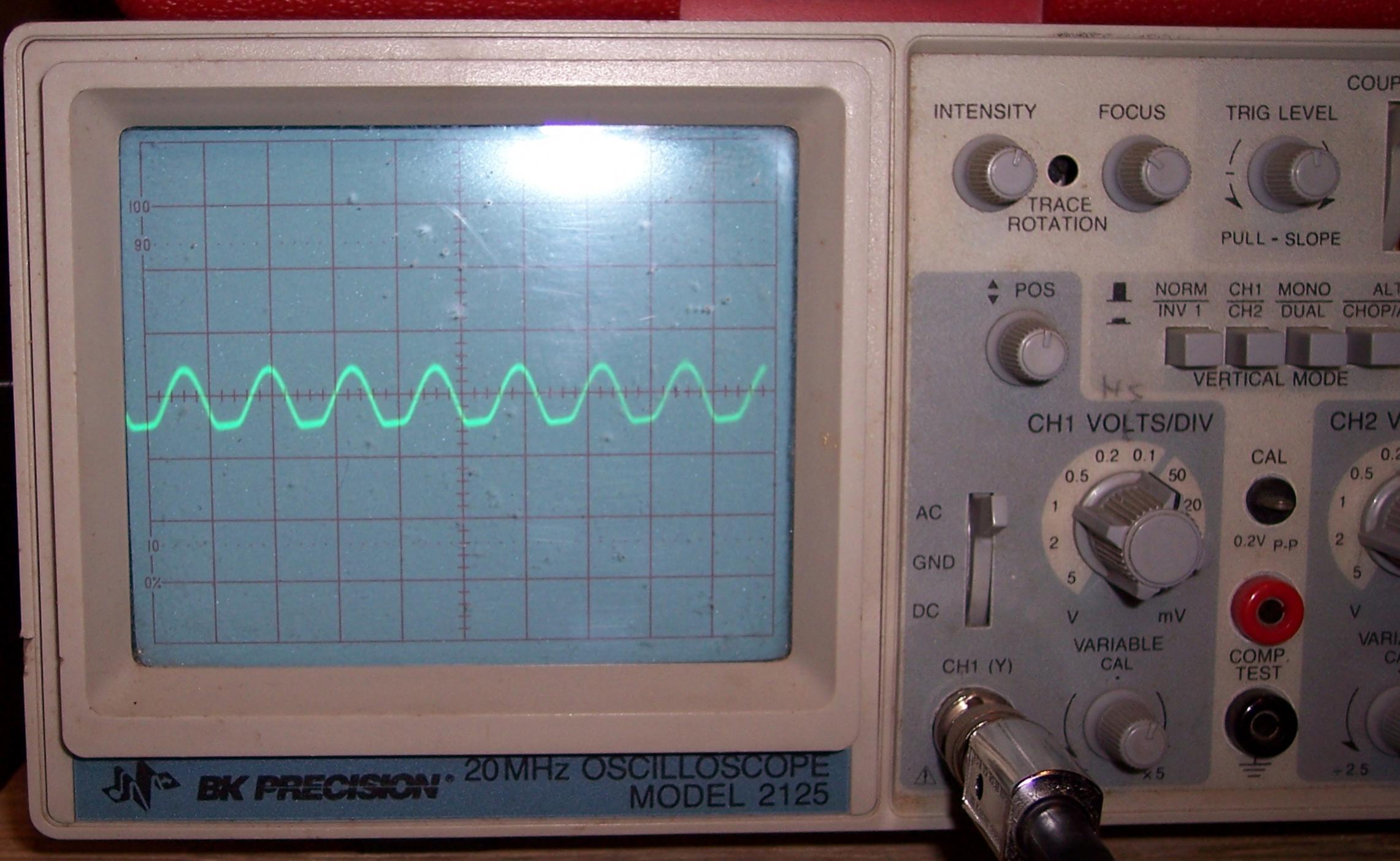

With scope set at .1V/div and .5mS, 1KHz tone, I increased the amplifiers gain slightly to get good clip on the emitter. First picture is at the base second is at the emitter.

I'm assuming that the probe is a 10x probe and the scope was displaying 1v/div.
In the top half of the waveform, you can see that the base deflects about 1/2v more than the emitter. That's normal.
In the bottom half, you can see that the waveform extends well below the emitter (more than 1/2v) but the emitter doesn't follow. If the collector of the PNP transistor has constant rail voltage well beyond what's needed to produce this waveform, the transistor looks like it's defective.
I would expect the base to be much greater (off of the top of the display) on the NPN with a vertical amp setting of 0.1v/div. Are you sure they're identical?
Is that a 10k ohm resistor connected to the two 51 ohm resistors? If so, if you have another 10k-20k ohm resistor, touch it across the 10k resistor. Does that clean up the bottom half of the waveform?

I held another 10K ohm resistor accross R104 and tested Q109's emitter (the PNP), it cleaned up the bottom of the signal. I have not checked any thing further.
