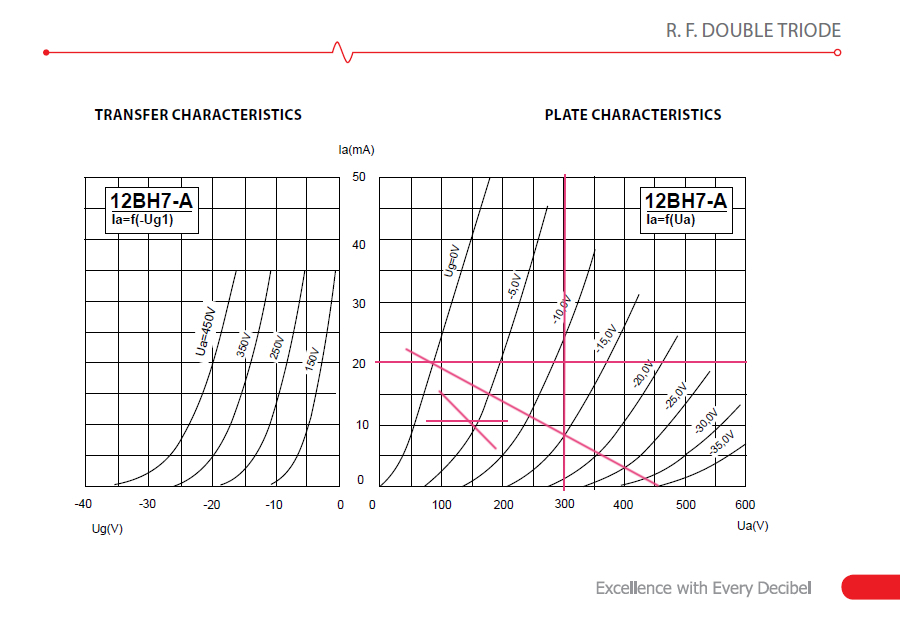

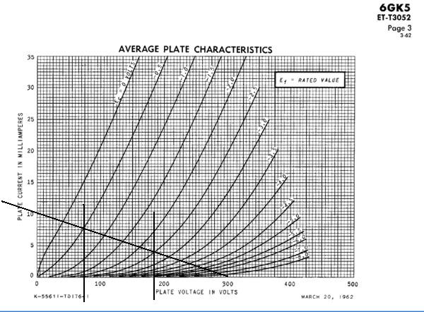

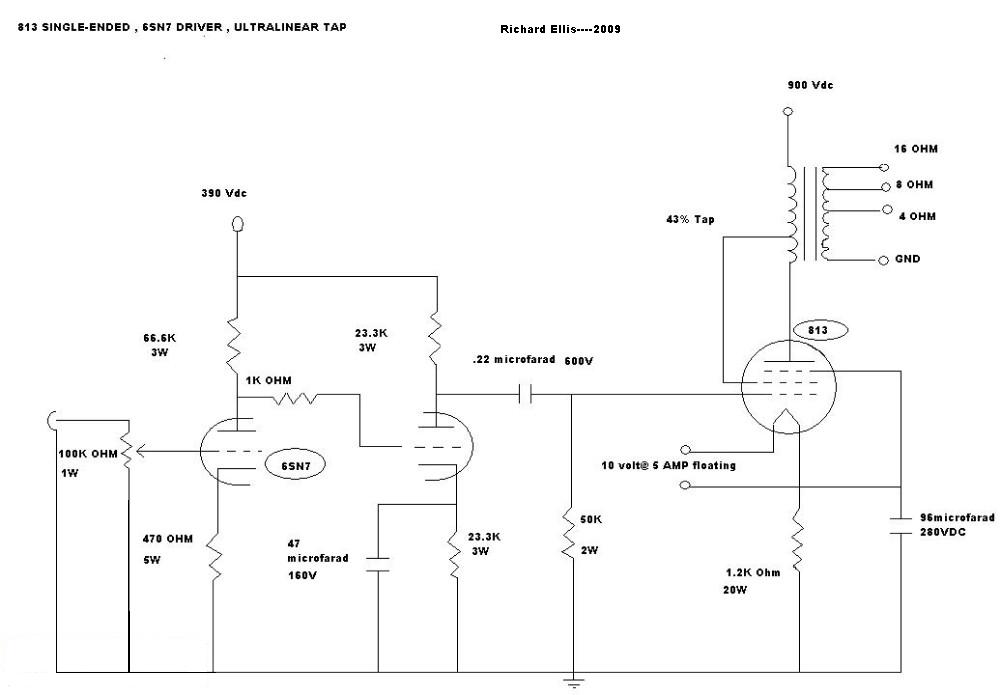

This may be painfully obvious to most tech heads here but its kinda cool, (I think so.) and might be helpful to others. Rather than photocopy a load line graph and use a ruler and pencil, use paint. Its that usually overlooked drawing program in Windows accessories. Do an image search for a loadline graph. My example is a 6GK5. Save it as an image file. Then you can draw as many lines as you like. Screw up? Just exit the file and open your original and start over. No more wearing out erasers on your pencils.

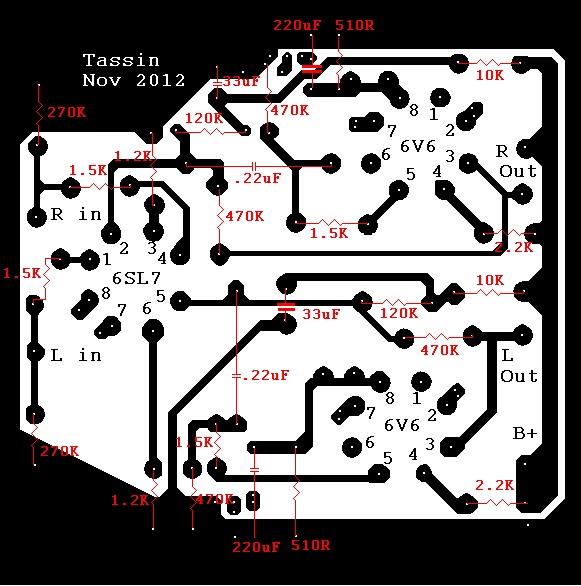

Also, if you find an image of a schematic, download it and save as an image file. Then you can edit it and redesign it as much as you like. You can cut and paste symbols for valves and parts from other schematics.
I'm sure there is some kind of CAD program out there that does this, probably even better. But this is FREE! I hope this helps.

I use it all the time! Perhaps it is a little slower than other programs with "preset" symbols and such but I can crank out a drawing just fine when words just won't do.

Yes, I use Paint for doing simple drawing. The nice thing about it is that it is so crude that it never tries to second-guess what I am trying to do. I hate smart software! (Especially Microsoft smart software). I have used proper drawing programs (such as Autocad) and find that only the really expensive ones (which I can't afford for home use) are any good; cheaper ones are always buggy.

I also find it helpful to color code the various loadlines. Red for the DC loadline, blue for AC loadlines where there is enough difference to make a difference, and green for determining gm and u-factor.

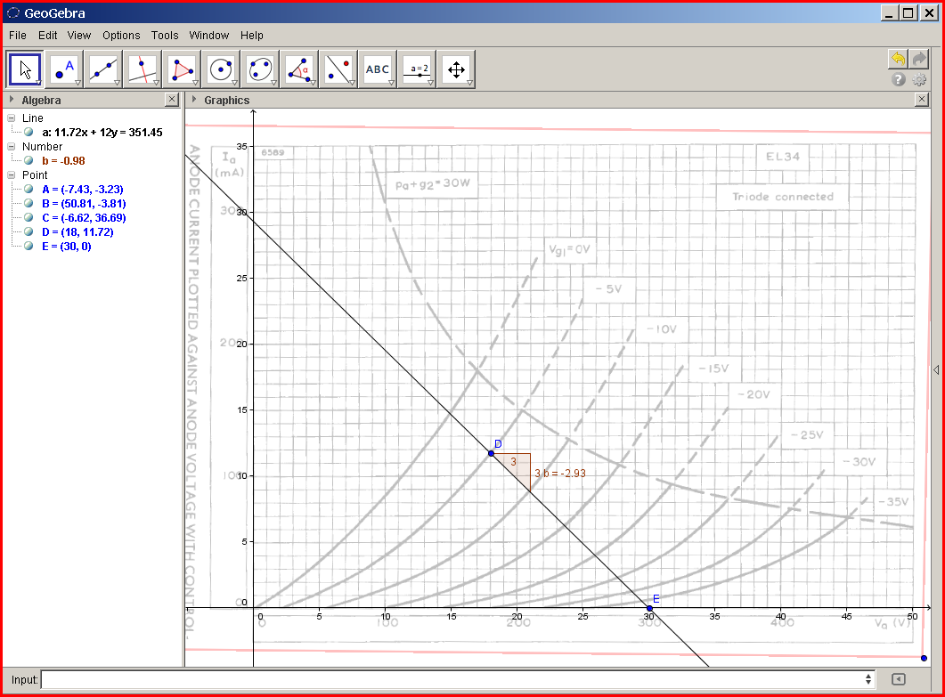

I've only been playing with (free) GeoGebra for a few days but it looks good for this
GeoGebra
requires Java - you did update to the 7 security fix release, remove old versions - right?
GeoGebra is a plane geometry tool but can also import, manipulate graphics
you can set object colors, transparancy to layer your added eyball fit lines, axis projection, quadratics on top of the datasheet graphic
if you scale, rotate imported load line graphics object to the drawing reference axis your added points, lines, coordinates, conics equations show in a sidebar, update "live" as you drag the points, or add slider buttons for formula defintions that get drawn "live" - and would be easily translated to electrical units

Snip Tool capture of tube datasheet pdf output charateristic graph as png (or gif, jpg...)
import to Geogebra, add control points, adjust transparancy, drag control points to allign graph axis with Geogebra's axis, even line up with "nice" scale factor of 10x
(control points being corners of graphic its a bit fiddly but adjustments converge quickly - but also works when the plot isn't lined up with the pdf page/snip edges)
zoom axis more 1st and could resize graphic to 1:1 V, mA scale factors
then put 2 points on graph, line thru points - display slope, numeric result
alternatively could have placed point at supply V, speced slope from resistor Ohm value.. ..diddle slope 'til you like looks of load line
has easy to add slider controls for point coordinates, slopes...
could draw parallels to load line, put points on grid V intersections, fit parabola...
