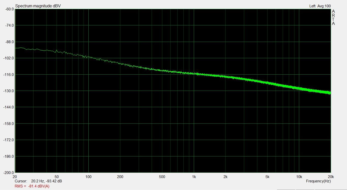

Does it make sense that I see a noise floor at around -106 dBV in graph 2 when the expected SNR should be around 76 dBA?
When I look at graph 3, the measurement seems OK, as the cart is specified for 5,5 mV @ 1 kHz, the pre-amp gain is 34 = 187 mV and -15 dBV = 138 mV.
The plots appear to have a frequency point every 6 Hz. The noise is about -108 dBV at 1 kHz. Assuming the noise bandwidth to be 6 Hz, that's -115.8 dBV in 1 Hz, or 1.625 μV/√Hz. Divided by the gain of about 31.6 at 1 kHz, that's 51.4 nV/√Hz equivalent at the input, including the terms due to the amplifier's noise voltage and current and cartridge thermal noise. It is actually higher than I would expect.

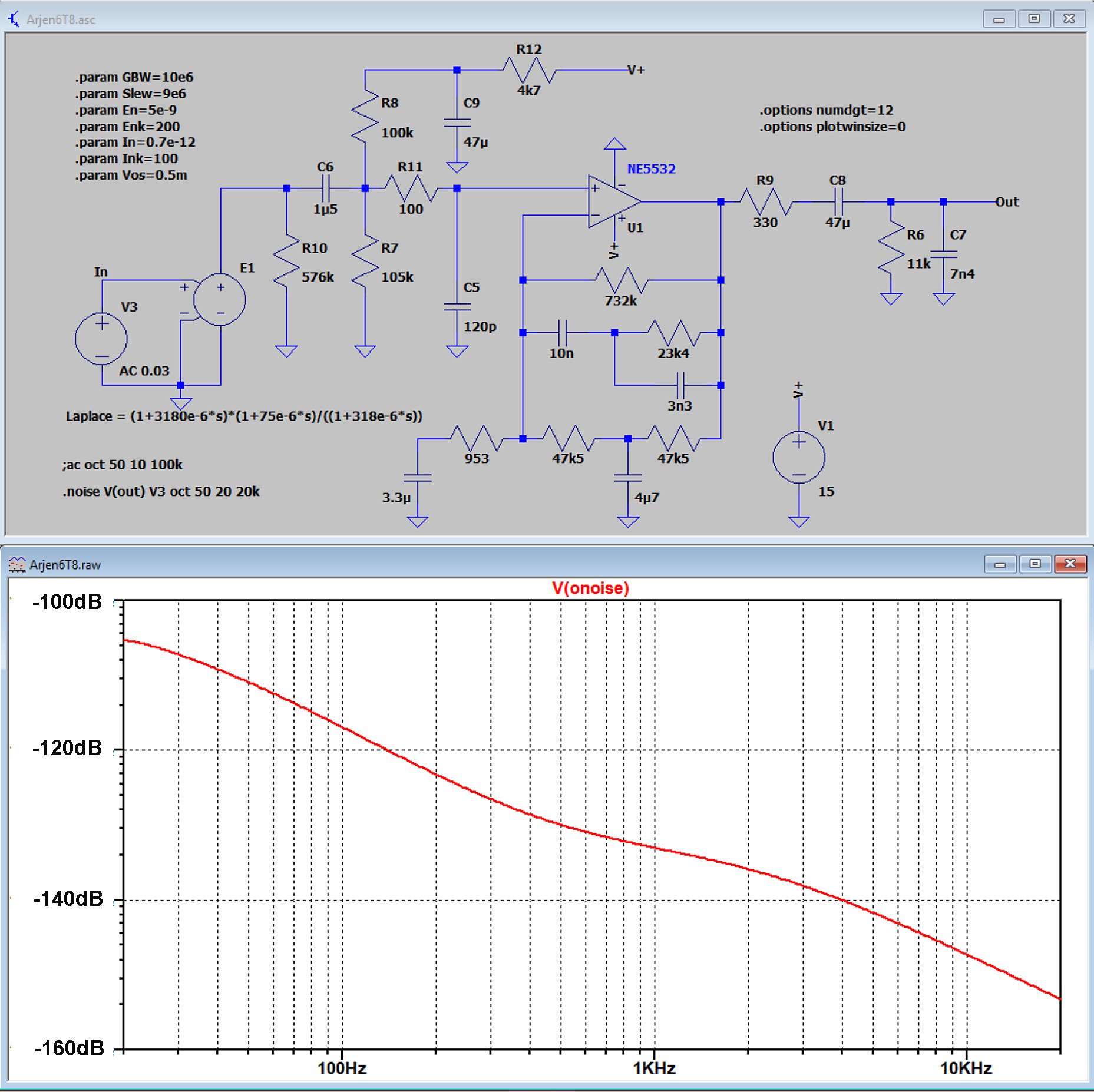

When translating the simmed version from nV/rtHz into dBV fot a 1Hz filter bin, we get the figure in the attachment.

I must say I'm a bit sceptical about the aliasing hypothesis, because the phono amplifier's output noise density is supposed to drop with frequency and should keep dropping up to a very high frequency thanks to the passive filter at its output. That is, there is not much to alias. Then again, I don't have a better hypothesis.

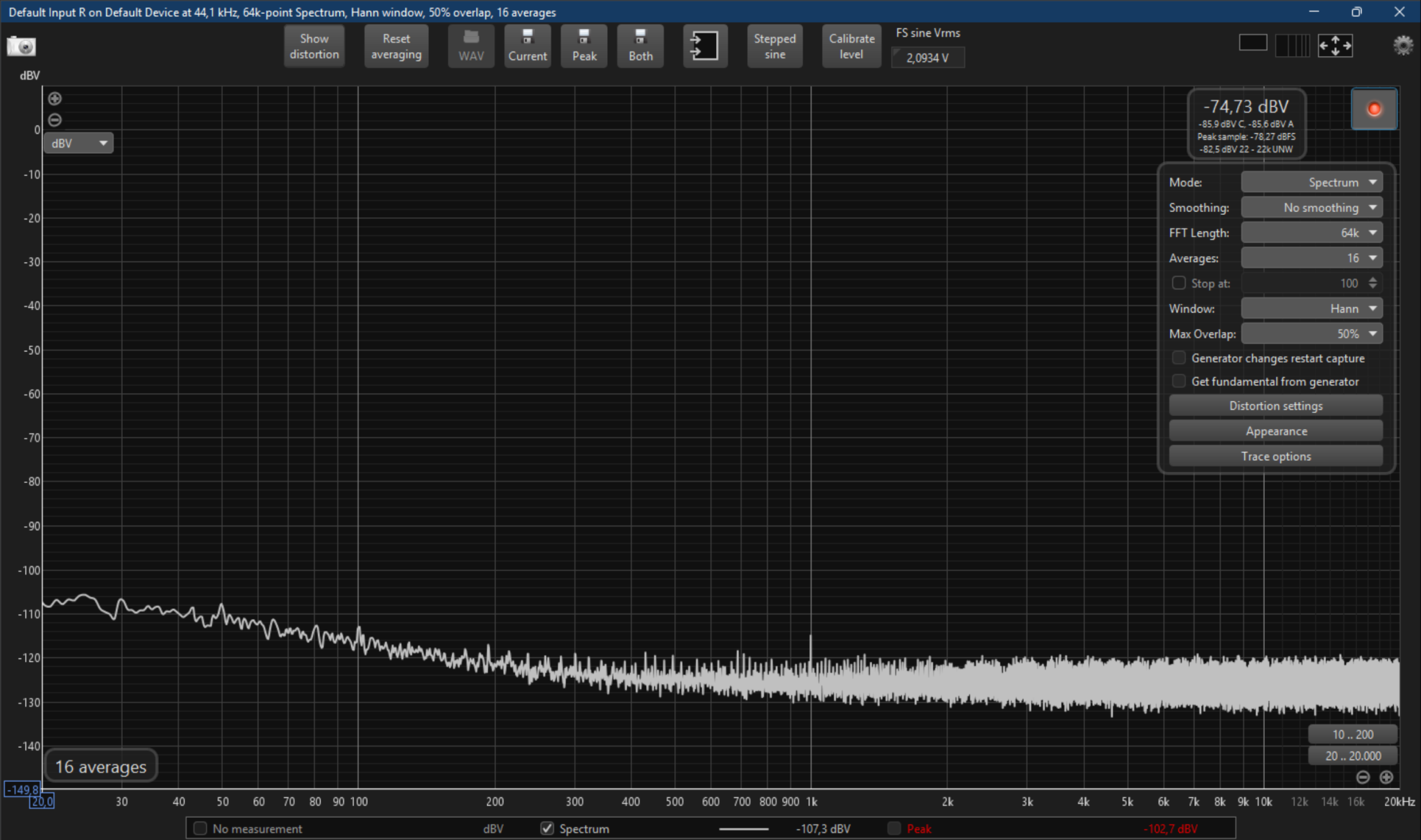

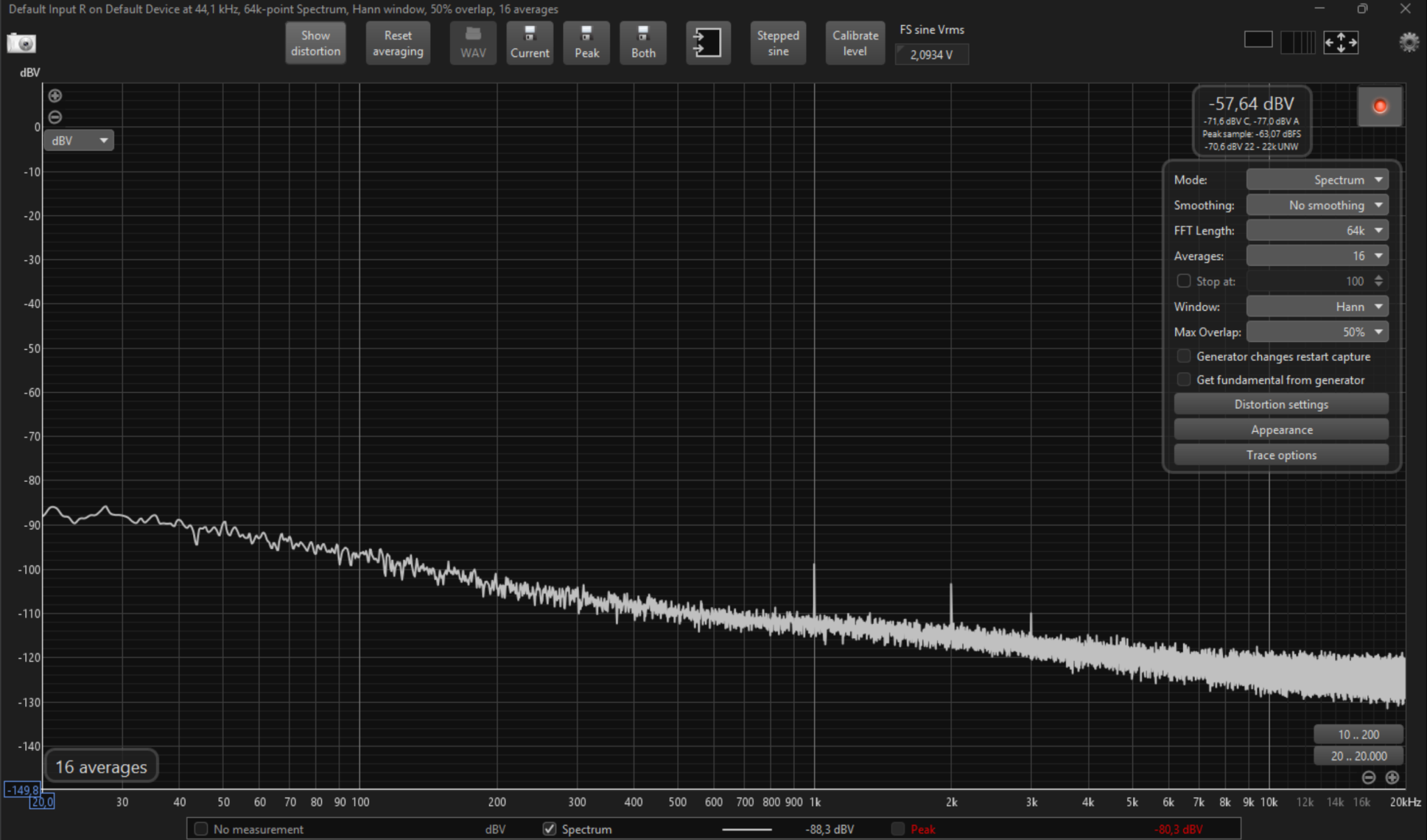

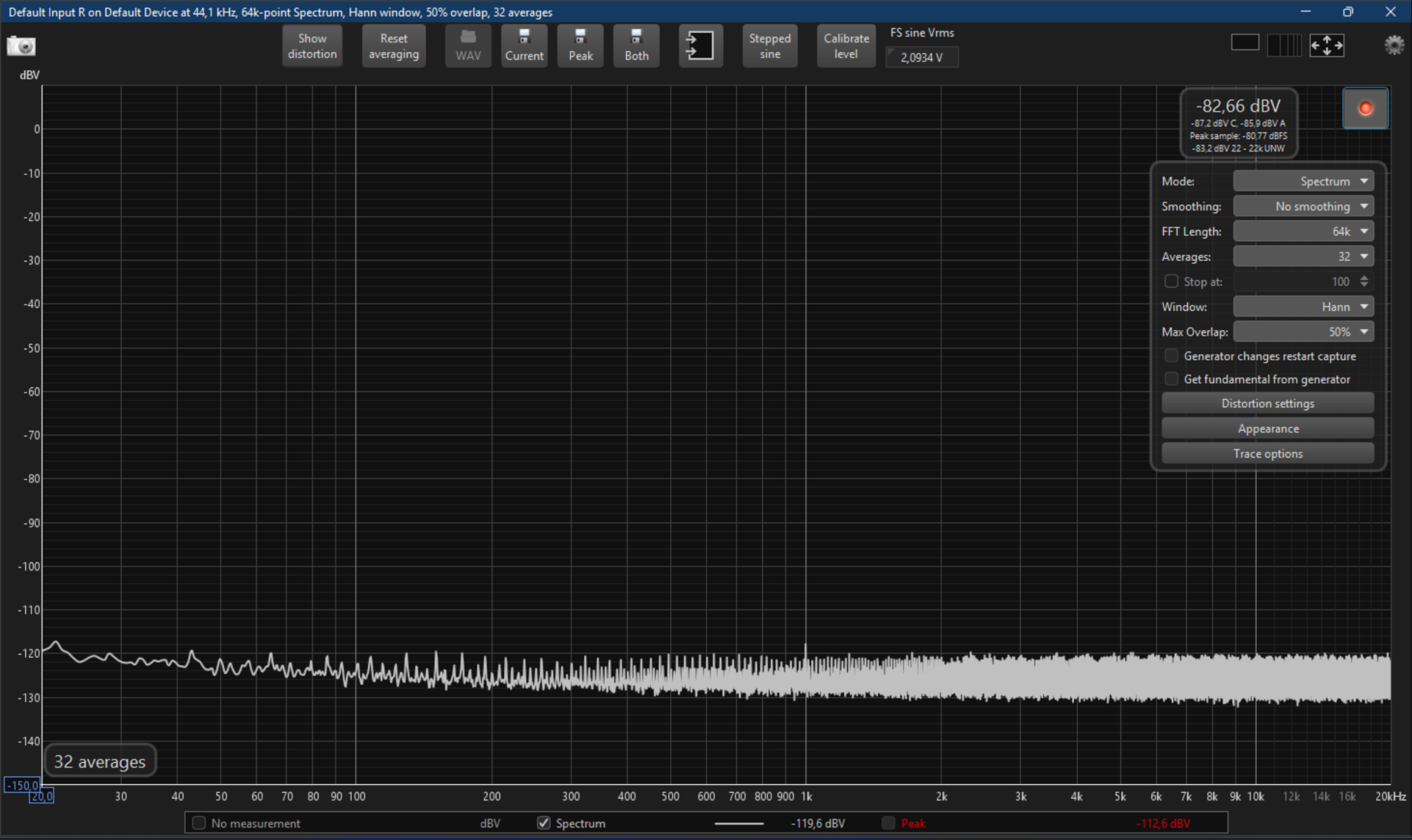

I have decided to first only show results taken with my soundcard/REW for now. To begin, I would like to show four graphs, to see if these are OK to be used for measurement. The straight option (without 20 dB head-amp) looks not good enough, and I have doubts that the ones with 20 dB headamp are acceptable. The head-amp I am using is a Vanderveen / Tentlabs unit, which is a buffer / attenuator / amplifier with a battery fed single OPA2134 circuit. My soundcard is an ESI U22 XT. I think the latter may be the bottleneck.
1. Soundcard with shorted input
2. Input RIAA amp shorted
3. Soundcard + 20 dB head-amp, input soundcard shorted
4. Input RIAA-amp shorted + 20 dB headamp
No probe was used in either of these four measurements. Line cable from RIAA-amp output to +20 dB pre-amp input and Coax cable from +20 dB pre-amp output to soundcard input.
