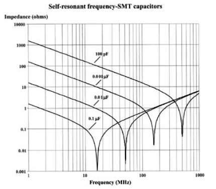

1. The Zobel network is there to stabilize CFP output stages and has almost nothing to do with RF interference.
2. The self resonance of even small capacitors is well below typical RF radio frequencies so even 100nF is an inductor at FM radio frequencies, more so for say 1uF.
3. The RF impedance of a speaker cable can be very low making it impossible to "short" with a capacitor.
1. Indeed, that's precisely why you can better use Thiele's series filters instead of Zobel networks.
2. True but irrelevant; as long as the impedance is low enough, it doesn't matter whether it is capacitive, inductive or resistive.
3. Your plot shows 8 ohm at 1 GHz and less than 1 ohm at 100 MHz for sufficiently large-valued, small-size capacitors, while cable characteristic impedances are usually in the 50 ohm to 300 ohm range, so I think this statement is incorrect except when the cable happens to resonate at the interfering frequency.
By the way, 8 ohm at 1 GHz corresponds to about 1.3 nH and a common rule of thumb is that 1 mm of wire at a large distance from any ground plane is about 1 nH. Hence, those capacitors must be physically small and must be connected such that there is as little common wire as possible between the parts to the left and to the right of it.
