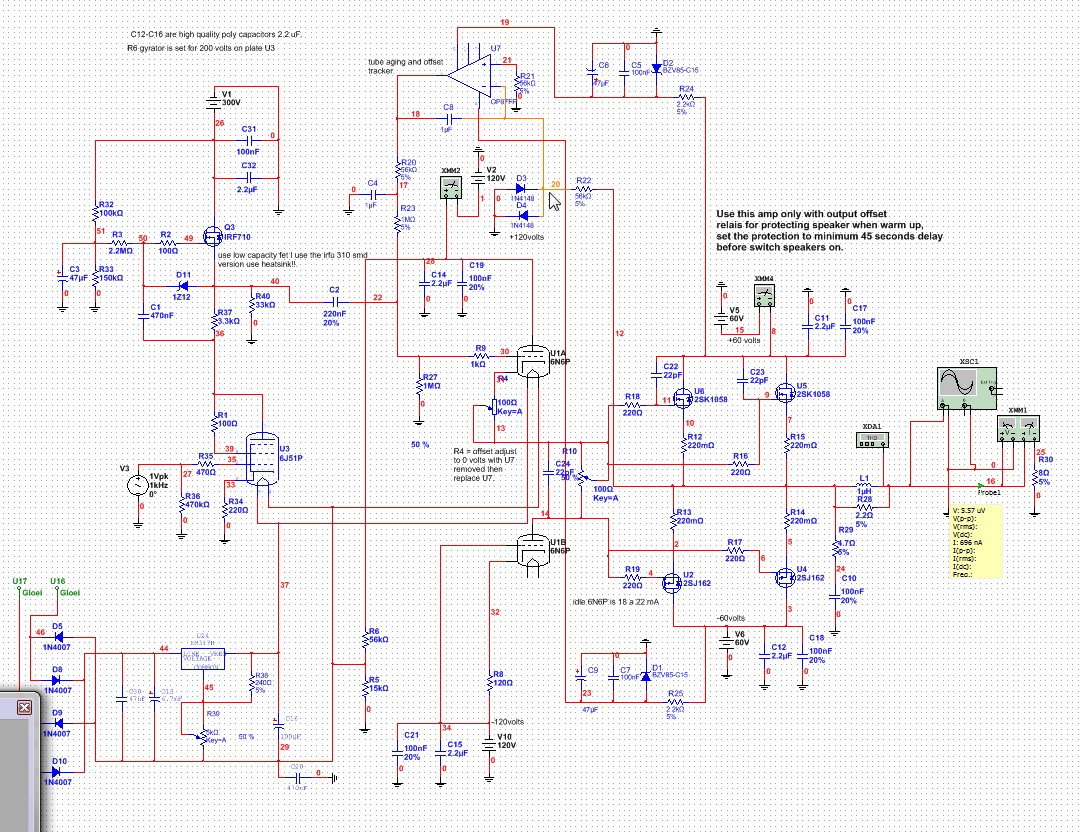

Little old here but I have the same problem with the hybrid with 2sk1058 and 2sj162.
What helps for me is put a small cap 220p between gate and source of the 2sk1058 alone, and i get rid of all oscilations, did not try lowering the resistors
this problem I did now al some years..
It starts oscilating when go higher then 6 volts output with speaker connected (give some induction).
It is known about this problem because of differencies capacity between the fets. use as high capacity as needed, I have now use 47pF each fet, 220 pF is to high, limitting bandwith for hybride..

Well I did try it with the resistors, for hybrid don,t work, I have use a cap on gate to source of the 2sk1058 this did solved always all that years, also elector did this.
I have dome a 33 pF cap, just try it how much you need, less capacity is alway better.

Hi jackinnj
I have no Ccomp, because i have a self designed hybrid amplifier, dc coupled tube driver to mosfets, I say this because I have no feedback, the little C between source and gate of 2sk1058 did always the trick for me, but I wil try soon what I gain when correct the capacity between the two. because of the tube driver who has idle of 20 mA the trick with a square wave wil not work, tube drives is a cathode follower so low impedance.
If I have a C comp the things get more easy for remove ringing, I did this a while ago with a C trimmer and then measure and place the cap.
regards
kees

Well a single little cap (22pF styro no ceramic) between drain and gate of the 2sk1058 cure all oscillations.
The same can be reached with gate resistors close to the case of mosfet of sudden value.
Caps are easy ones, it make the amp stable whatever there is on the output like loudspeaker filters.

Hehehe no it is not 220pF but 22 pF, that is a error in the schematic, cap needs as high to prevent oscillating, even 15 pF or 10pF if it works is enough.
