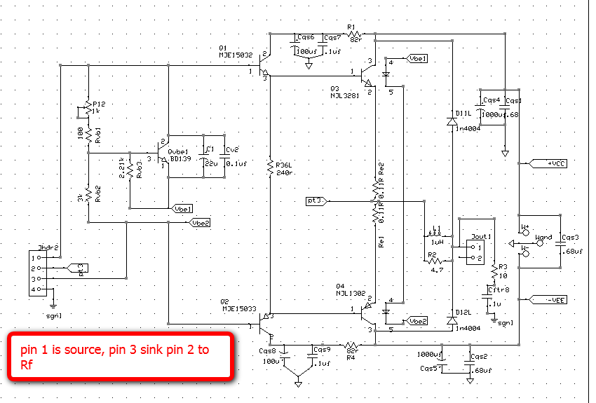

I haven't preformed a full power test yet. But just recorded .0024% Thd with my LME49811 driving my Allison output stage - no predrivers and 15032/33 as the drive transistors.
and what were the peak currents from the 811, the drivers and the outputs?
What was the load resistance?
The big problem that seems to be getting ignored here is what happens in the ealier stages when the output current demand increases.
If the output is 1Apk (8Vpk & 4W into 8r0) then the actual amp can be measured to find the earlier stage currents.
Now increase the output by 20%. What are the INCREASES in each of the earlier stages?
Try for +50%, +100%, +200%, +300%.
The earlier stages will pass much more current than simply applying the same factor as was used for the output current. It gets much worse as the output current approaches values required to drive reactive speakers with fast starting and fast stopping transient signals that are still with the clipping range of the amplifier's output.
The earlier stages will rapidly run into overload as the output current increases.

Dear Ken,
You have them running? Normally with faster pre driver transistors I put between 47p and 220p between collector and base to kill oscillation. I don't know the formula for the right value, I do it on the workbench with trial and error 😉 😀
With kind regards,
Bas
Bas,
Yes they are running. I started with 100pf and reduced that to 56pf. I haven't tried going any lower than 56pf. Works on my EF output configuration and my Allison output configuration.
Ken

First measured THD at low power with the 2sc4793 2sa1837 as drivers with 56pf btwn collector and base in the EF output (with Thermal Traks as output transistors) in lieu of the 15032/33's jumped way up lots harmonics 0.228THD.
Attached is schematic of the EF output stage.
