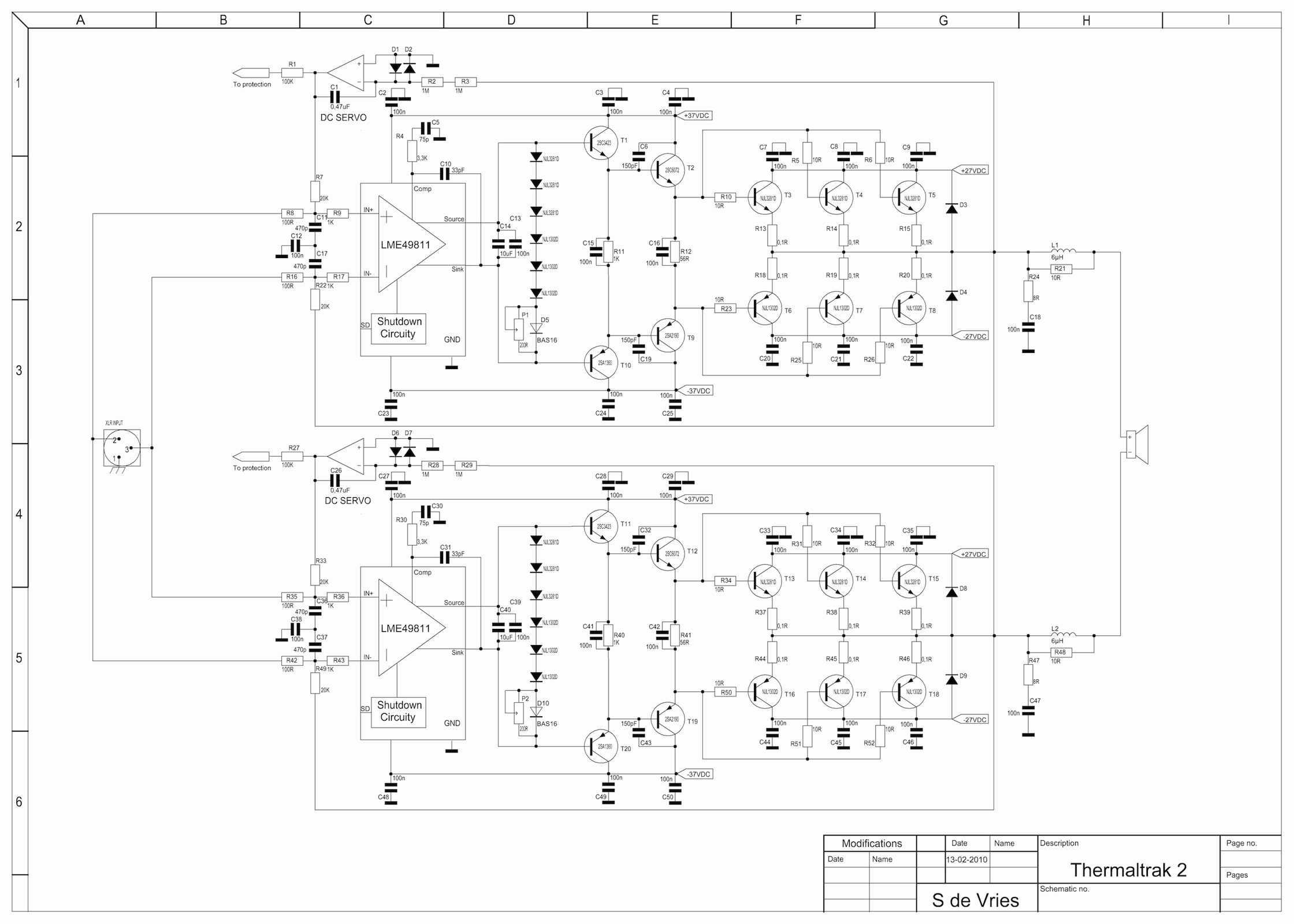

Dear Ken,
Here the schematic attached.
I got you about the NLJ3281D. You took the worst case scenario with -25 degrees celsius which indeed gives an hFE of about 85.
One reason to go with multiple drivers is to give the system more current headroom, but most important, the distortion of the LME49811 rise excessive above 1,2mA remember measurements from Panson.

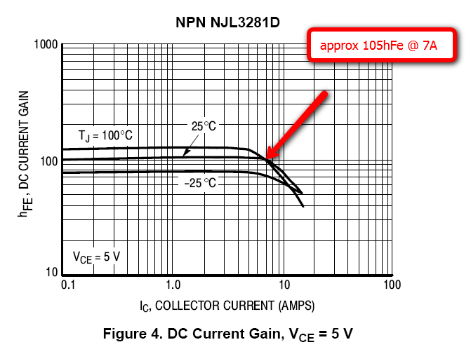

I don't know what data or graphs you two are using.
NJL3281 is specified at gain 75 @ 5A @ and at 45 @ 8A both at 25degC.
The graph of typical gain @ 7A is ~80 at 25degC.
I think from this evidence you should use somewhere between 50 & 60 for the gain at 7A.
3Pair of NJL each passing 7A, 21Atotal, requires ~21/55 ~=382mA of total base current. A single driver will pass all this as emitter current.
In the previous example for 4A of output current from each device the base current is 200mA using the gain of 20 as specified.
4pair will require 800mA of base current for a total of 16A of output current.
If the driver has a gain of 50 @ 800mA then the driver base current will be 16mA. i.e 16A @ output requires 16mA from the VAS or pre-driver if used.
Look at the device gains, 20 & 50. multiplied that comes to 1000, yes, 1mA becomes 1A if the gains do not vary with current passed, i.e. linear BJTs.

Thanks Andrew for your comments.
In your example for 21Apk the LME49811 driver must deliver 1,9mA if I use the 2SC6072/2SA2190 drivers with hFE 200 at 250mA. I still think this is reasonable. Since my design is a bridged design, the total current able to being delivered to the speaker should then be 42Apk. Even if the driver/outputstage is ready to deliver that, I wonder what kind of power-supply will keep this up.
I will work on a new schematic, and post it here and take all the advice given by you and Ken with me. I'll be back soon 😉

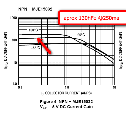

Bas,
I thought I might do the math again with the MJE15032/33's and the NJL3281
NJL 3281 hFe at 7A approx 105
MJE15032 hFe at 250ma approx 130
105hFe x 130hFe = 13,650
21A/13,650 = 1.5ma
I have also found that hFe rises with voltage both of these hFe's were measured at 5v.

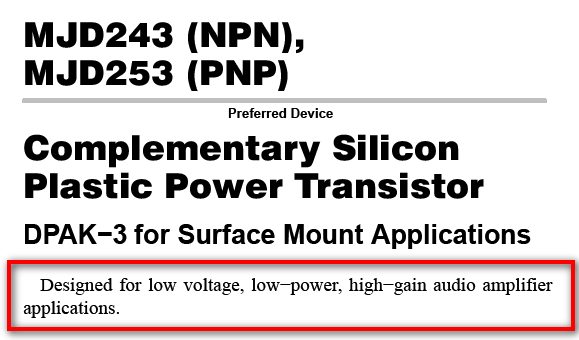

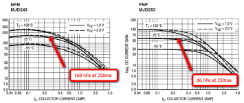

Bas
The 15032/33's do seem like a bit of overkill, but, I've found them to be robust and stable.
Have you been able to get the amp to run with the Toshibas you mentioned? As I mentioned, I've had zero success with 2sc4793 / 2sa1837. The models work in my sim, but, not in real life. I'll be interested to hear.
The other driver I've used with some success is the MJD243/253. They might be good for your application - look at the description I've highlighted. 50pf Cob. But the PNP has a pretty low hFe.

Dear,
Here the schematics of my new plan. However lot of things have to be figured out.
First a resume.
I decide to not give up on the toshiba driver transistors and make it as my goal to make them work 😀 That said this is the planned configuration. Note the hFE's are chosen for worse case scenario's and will be higher in real life situations.
First driver: 2SC3423/2SA1360 (hFE +/-100)
First a resume.
Second driver: 2SC6072/2SA2190 (hFE +/- 180)
Power stage:NJL3281D/NJL1302D (hFE +/- 70)
Once again the math in this new situation. The end goal is to reach 21Apk
21Apk/70=0,3A
0,3A/180=1,67mA
1,6mA/100=0,0167mA
The LME driver will see hardly any load and will have the lowest THD in this configuration. However on the prototype boards, I will listen and measure with as well the first driver omitted as activated. This would be the only way to find out if we really need them or not.
I do have a big gain problem in this configuration. The first limitation is that the LME49811 may not work with gain below 26 (in my schematic I am already below). Since I drive both chips balanced each amplifier half will have double the gain. Once bridged both amplifiers the gain doubles again! as result I will end up in a way to high total sensitivity and gain.
Driven by a balanced +/- 1volt signal I will have an amplifier gain of 80 equal to 32dB. If I change both amplifier gains of 26, I will end up in a total gain of 104!
Either I need to reduce the input signal passive, or limit the open loop bandwidth in the feedback loop to be able to use the chips with lower gain settings.
Makes it more attractive to go for the LME49810 instead, since that chip may be used with gains start at 10.
One more question. To make sure the driver stage is always in class A I assume the Idle current should be as high as the maximum to be expected to deliver current. I am correct in this?
That would be 1,67mA idle current for the first driver stage and 300mA for the second driver stage.
With kind regards,
Bas

Dear bobodioulasso,
I would rather also omit D3, D4 and D8, D9 since they have leakage. But I am bit afraid for what will happened if the cones give heavy EMK.
Since the capacitance of the 2SC3423/2SA1360 drivers is so low, and since the LME chip at worse case only need to deliver 0,0167mA I decided not to put resistors in serials with the source and sink pins since I think the LME hardly sees any load anymore. Less is more.
I would be interesting to know what the idle current biassing is of the driver stage inside the LME49810, but I guess we never know. In my design I want to make sure the driver stage is always in class A. As a matter of fact, I consider to invest in heavy heat sinks and power supply, add some extra pairs of output devices and bias the whole amplifier the first 20 or 25 watt in class A.
With kind regards,
Bas
