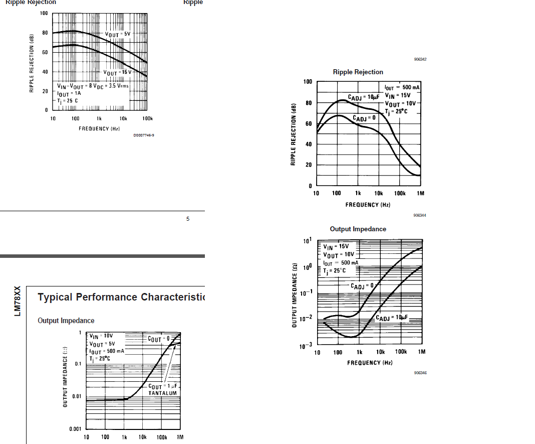

That kind of comparison is interesting, but can be misleading.
When you design something to specs, and you want to cover your *** (and that's a basic survival instinct), you look only at the min/max columns of the datasheet.
When you design something for yourself, or you want to know how well your masterpiece is really going to perform, you have to use pertinent information.
This table doesn't do either of them: it is based on the best typical numerical values of the datasheets.
Actual measurement of characteristics on a large enough and representative sample is the ideal, but short of that, the information extracted from the datasheet can be put to good use.
If we compare two of the characteristics emblematic for audio applications, ripple rejection and output impedance (78xx left, 317 right), we see that at first sight, the ripple rejections look rather similar: a little more than 80dB at 100~120Hz for both, with the 7805 somewhat advantaged. That is until you look at the scales: for the 317, it extends to 1MHz, instead of 100KHz for the 78xx.
This means that at 10KHz, the rejection for the 317 is still ~70dB, against 65dB for the 7805, and much worse for 78xx of higher voltages (assuming you use Cadj for the 317, which is normally the case if you are concerned with performance).
For the output impedance, the comparison is more straightforward: the 78xx has 8mΩ up to 1KHz against 2.5mΩ for the 317, both increasing to ~1Ω at 1MHz.
Both screenshots are extracted from National (now TI) datasheets. That is important, because making cross-comparison between manufacturers for such diagrams is tricky and dangerous: you have to measure them for yourself.
There are many other characteristics; many of them are much less significant for audio except noise, but that one is much more elusive, and the datasheet only provides an upper bound for it. The part to part variation can be very significant.
I have generally found that 317's are quieter than 78xx, but that is anecdotal, and there could be significant variations, both part to part and manufacturer to manufacturer. It is difficult to be categorical. If this particular parameter does really matter to you, the best option is actual comparison.
The tempco of the 317 is generally better than the 78xx, but it is relatively unimportant compared to output impedance and ripple rejection (for audio).
