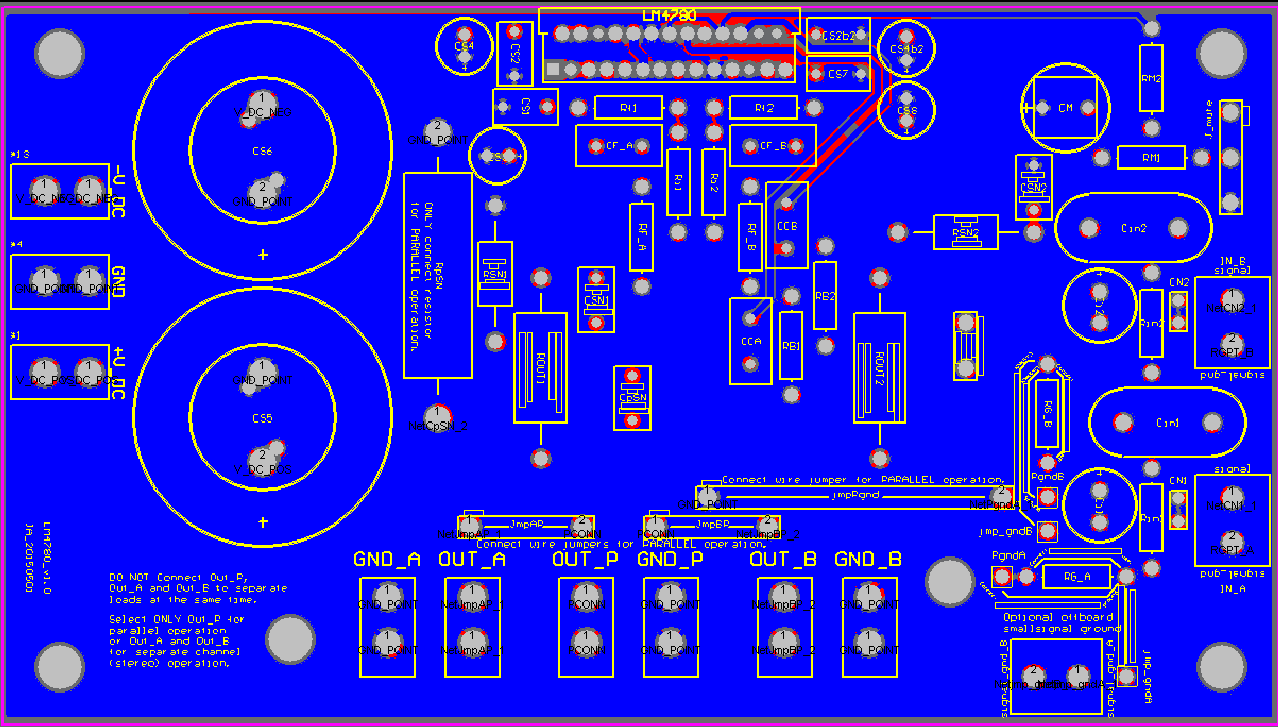

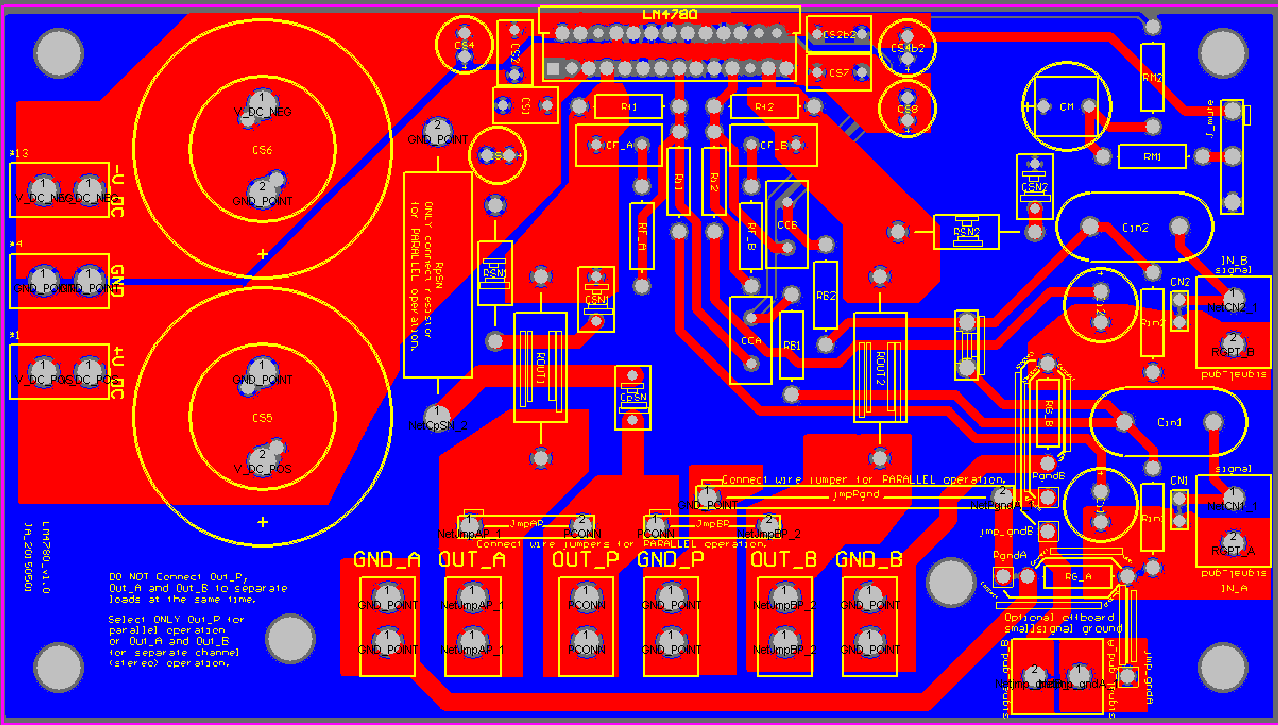

The following layout is meant to provide configuration options (stereo or parallel amplification) when using a stand-alone LM4780. The inputs could include RCA or XLR connections (via an external THAT 1200 board). The potential sources are a preamp, a music player, or an Analog devices ADZS-21469 DSP evaluation board.
The layout below is based on the Texas Instruments (LM3886 and LM4780) data sheets and National Semiconductor application notes (AN-1192 and AN-1849). The output inductor and resistor are connected off-board following the placement considerations raised in chapter 8 (starting on page 235) of Douglas Self's "Audio Power Amplifier Design Handbook 5th edition". The on-board grounding scheme follows the Taming the LM3886 Chip Amplifier article by tomchr on the Neurochrome website and allows for off-board grounding if needed.
While the general layout is basically settled, there are a few questions that I would like to resolve.
Q1.) What is enough space for heat sink mounting? Can anyone verify the spacing between the back hole centers of the LM4780 and the back edge of the board? For reference, I am using 160 mils as pictured.
Q2.) What is the typical spacing between the power rails to satisfy clearance and creepage safety requirements? For example, figure 40 of the LM4780 data sheet layout appears to use approximately 40 to 45 mil spacing while tables two and three of "Safety Considerations in Power Supply Design" recommend 16 to 47.2 mil (or 0.4 to 1.2 mm) depending on functional needs and pollution level.
http://www.ieee.li/pdf/essay/safety_considerations_in_power_supply_design.pdf
Q3.) Are there better small signal and ground plane routing alternatives? In the example below, the small signal wires are on the bottom of the board and higher voltage signals are carried on the top. Can anyone provide measurements or experiences when routing the small signals on top and using an isolated small signal ground plane on the bottom?

Make your Signal ground/Return separate from the Power Ground.
It's not so important with a mono-block, but becomes very important for a multi-channel amplifier.
Do your really need 3 electrolytics for MF supply rail decoupling?
Also, thank you to members AndrewT, marce, and tomchr for their previous responses and helpful links.
You're quite welcome. Thank you for the recognition. Your layout looks eerily familiar to where I landed with the Parallel-86 layout, at least in terms of component placement. There's room for improvement, however.

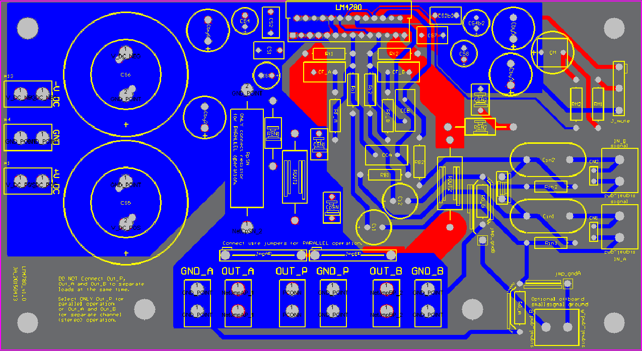

First off, I suggest revisiting the decoupling network. Andrew hints at that as well. While it may not be strictly necessary, I do support you decision to use decoupling at either end of the chip. I wasn't quite comfortable leaving the far end without decoupling either... However, I don't think you get much benefit from using two small electrolytic cans for the 1-100 kHz decoupling. You can run a simulation to verify, but in my experience, you will get a better decoupling network with a large electrolytic can (1000-2200 uF), a smaller electrolytic can (22 uF) and the largest X7R ceramic cap that you can find. All the caps need to be as close to the IC as possible - so scoot your Zobel resistor out of the way and move the decoupling closer to the IC.
I suggest using a ground plane rather than pours. Move the signal traces to the top of the board and put the ground plane on the bottom. Make the plane as big as you can possibly get, preferably, cover the entire bottom with copper.
The feedback ground and input ground need to stay separate. Connect these to a copper pour (on the top layer if you can fit it in) and connect this pour with a low-inductance trace/pour to the GND at the speaker terminal. If the components that connect to the feedback and input ground poke through the ground plane (they will if the plane covers the entire board), don't forget to remove the connections from these components to the ground plane. Otherwise you'll have a ground loop...

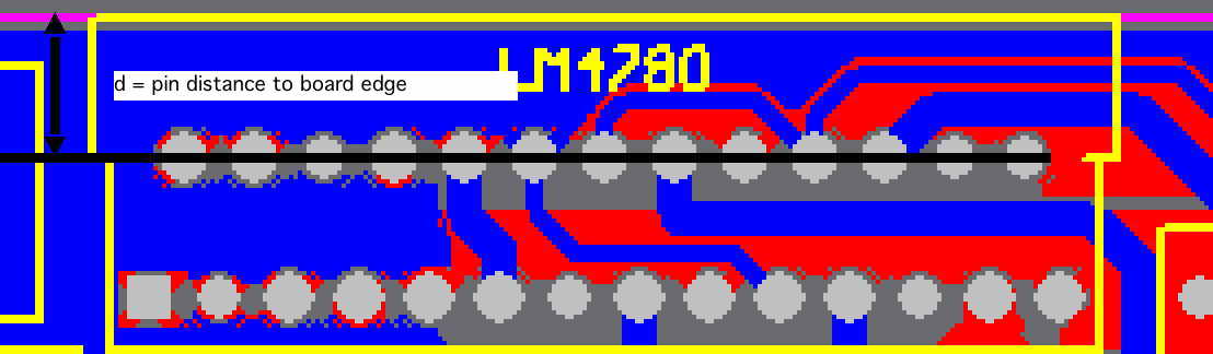

I'd leave 0.5 mm (~20-25 mils) minimum between the edge of the board and the heat sink. The distance between the mounting holes can be calculated from the dimensions listed in the LM4780 data sheet. It works out to just over an inch.
Depends... For a PCB with solder mask, 40 V/mil is normally considered safe. I would never go that tight, though. I also forget if that's the breakdown voltage or the "safe rule of thumb". Google it... 🙂 On a low-voltage board, such as the LM3886/LM4780, 15 mils between planes/pours is plenty.
For PCBs without solder mask, all bets are off... Better use some form of conformal coating for those.
Hello AndrewT,
Thank you for the feedback. To clarify, the layout is intended to accommodate single board operation (meaning on-board ground point) or multiple board operation (meaning primarily off-board ground point). For this layout, the small signal ground routing is dependent on how RG_A, RG_B and the corresponding jumpers jmp_gndA and jmp_gndB are connected.
For single board operation, the signal ground routes to the load return (black speaker terminal) and the load return is routed to the onboard power ground. This scheme follows the approach presented by tomchr LM3886 chip amp grounding.
For multiple board operation, the signal ground can be connected off-board to the power supply (via the connection terminals in the bottom right hand corner) and the load return is also connected to the off board power supply. This scheme follows the example presented by Douglas Self in figure 18.1 on page 485 of "Audio Power Amplifier Design Handbook 5th edition".
Is this what you were referring to or is there something else?

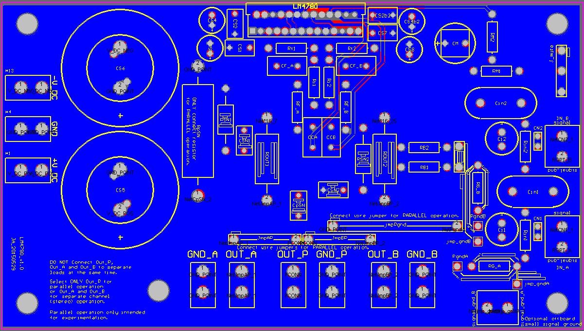

I chose to add additional electrolytics for a variety of reasons.
To support the parallel operation decoupling scheme recommended in figure 16 on page 14 of AN-1192.
To avoid potential problems due to the somewhat narrow V+ trace running along the LM4780 in this layout. Years ago I had a course where we laid out pcbs to support a Motorola Coldfire running at 40MHz on a 2-layer board. There was an example where failure to provide capacitors at each of the power points of the external dynamic RAM caused problems. Granted this is not a fair comparison but it was a motivator.
Based on my interpretation of the presentation marce posted a link to last year. For convenience, the portion regarding multiple capacitors and placement, starts on page 53 of the pdf linked below:
http://www.pcbcarolina.com/images/01_pcb_power_decoupling_myths_debunked.pdf

… Your layout looks eerily familiar to where I landed with the Parallel-86 layout, at least in terms of component placement.
The layout should look familiar. When I surveyed the approaches to component placement and layout of the LM4780, I found the examples typically looked like the National board shown in figure 40 of the data sheet, your component placement approaches (Parallel-86: High-power composite amplifier achieving 0.00020 % THD. and Modulus-86 Rev. 2.0: Composite amplifier achieving 0.00014 % THD.), the Chipamp Electronics layout, and combinations of the first two approaches (e.g. the LM4780 Pro PCB on moutoulos ? - LM4780 Pro PCB
To me, the appeal of the National board was that some of the measurements provided in the data sheet were based on the layout of the demo board shown (according to Note 11 on page 4 and on page 15). I was also more familiar with the routing strategy employed. Problems I found with this scheme included limited room to optimally mount the chip on a large heat sink (not too tough to overcome) and the routing challenges presented by the addition of pairs of Cc, Rf2, and Cf2.
I was first exposed to your layout when AndrewT recommended your http://www.diyaudio.com/forums/chip-amps/252436-lm3886-pcb-vs-point-point-data.html thread last year. The measurements provided as you flushed out the design (starting at post 30), the layout starting at post 181 http://www.diyaudio.com/forums/chip-amps/252436-lm3886-pcb-vs-point-point-data-19.html, and the comments provided by KSTR and marce were compelling. Two concerns I have for employing this approach with the LM4780 are the narrow trace for V+ and the impact on crosstalk performance for a stereo configuration.
Initially I had a layout similar to the National board that included all of the components I wanted to support two channel or parallel operation. It looked sort of like the LM4780 Pro PCB. However, there were a number compromises I had to make and putting the power connection on the left side made the routing easier. Once I saw Parallel86 was working with this scheme (in particular the relatively narrow V+ trace), I began working out a means to address the stereo layout requirements.

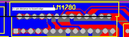

To clarify my earlier question. The back row of my LM4780 footprint holes are at position zero and my keep out layer is 160mils away to allow room for the heat sink. What distance (dimension d in the attached picture) have you found is good to allow room for the heat sink and maximize the trace width?
According to the package drawing in the data sheet, the distance from the center of the rear row of pins to the back of the package is 166 mil (+/- 10 mil). I'm pretty sure I placed the rear row of pins 125 mil from the board edge.

I'd probably swap the Thiele network and the Zobel capacitor on the left side to reduce the trace length in the Zobel a bit. It's a bit academic, but you might as well optimize it.
I'd probably play a bit more with the placement of the feedback and input components. I suspect you can clean that up and get the output pours to flow a bit better (maybe under the input resistors).
BTW, to make the parallel play nicely, you need as low a DC gain as you can get away with. Either by using a cap in the feedback circuit or by using a DC servo.

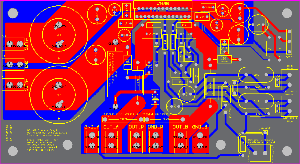

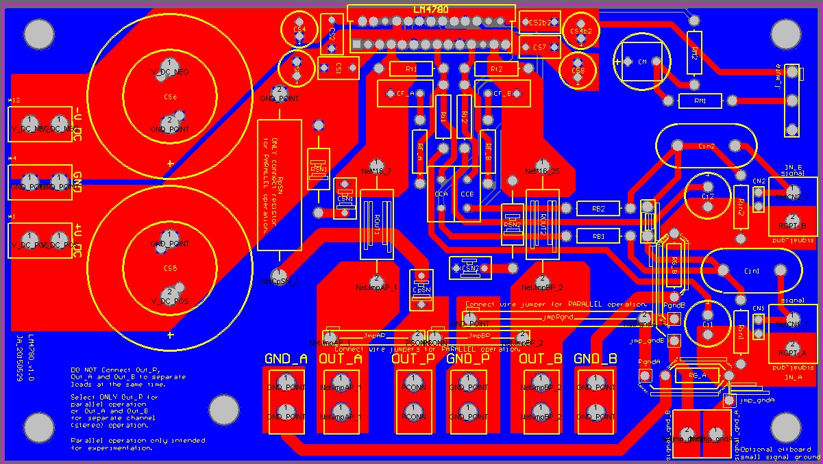

Hello Tom,
Thank you for the help. The servo version is on hold until the end of the summer. For now, a cleaned up version of the standard stereo version is attached for anyone interested. The parallel option was retained for experimentation (and convenience).
