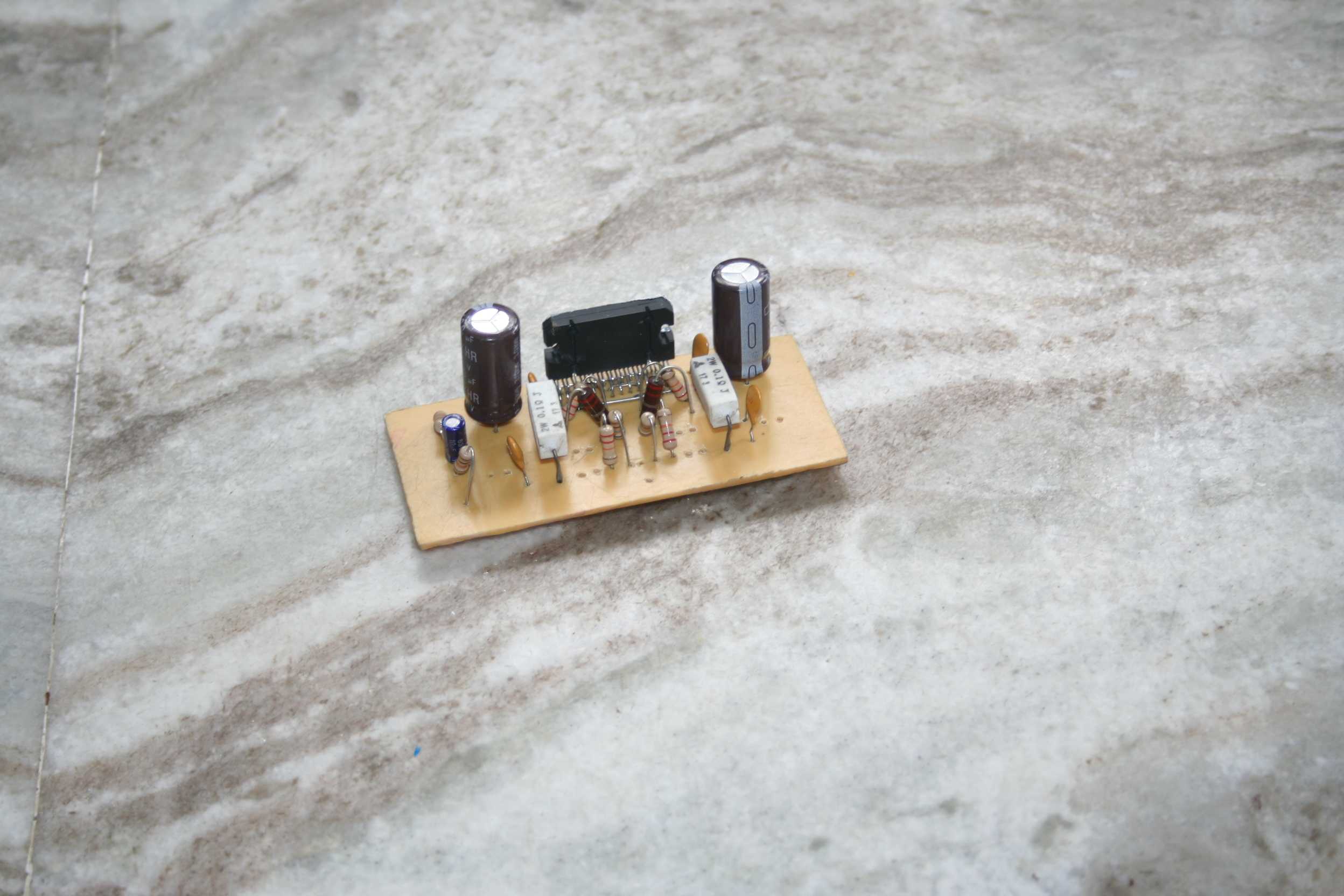

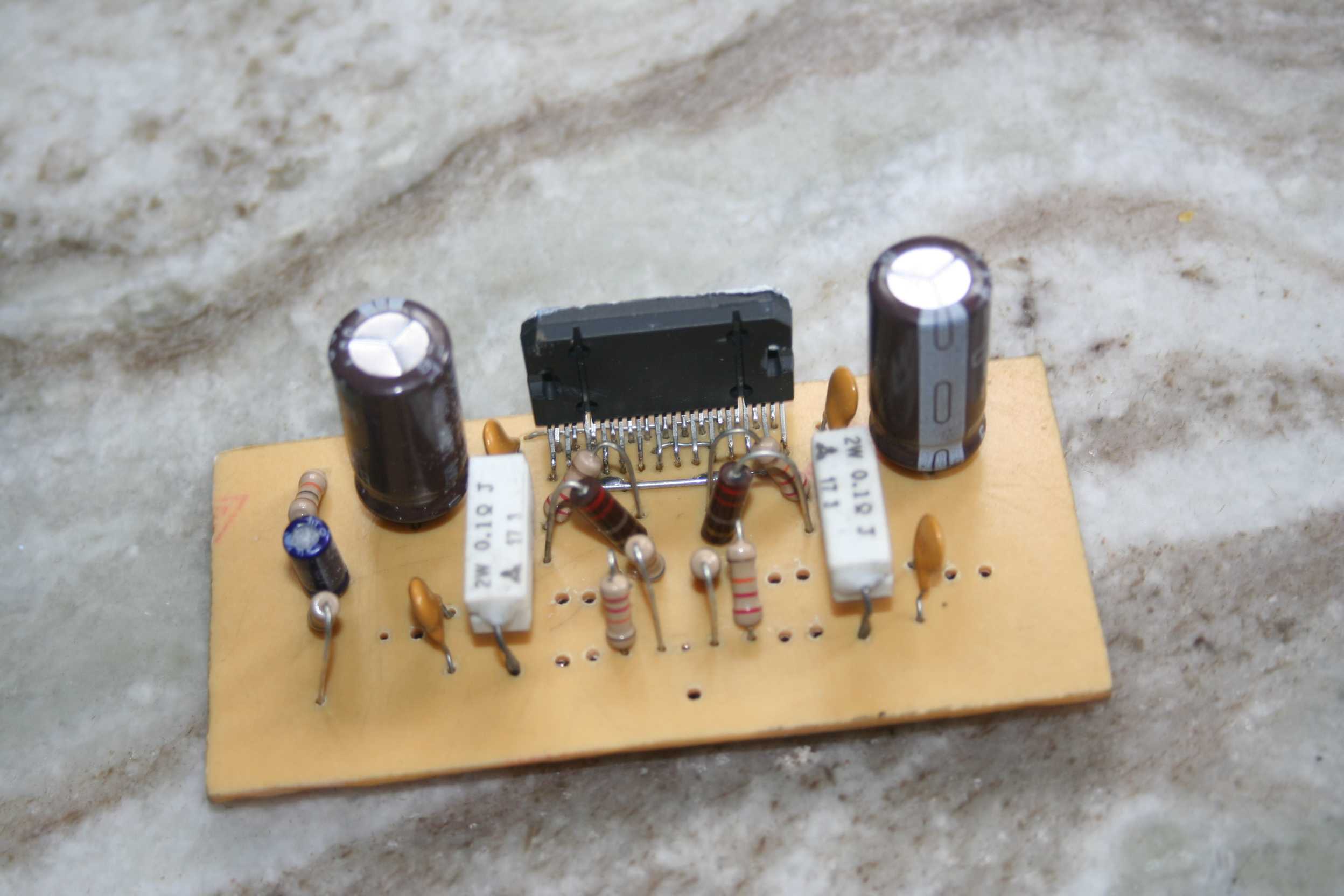

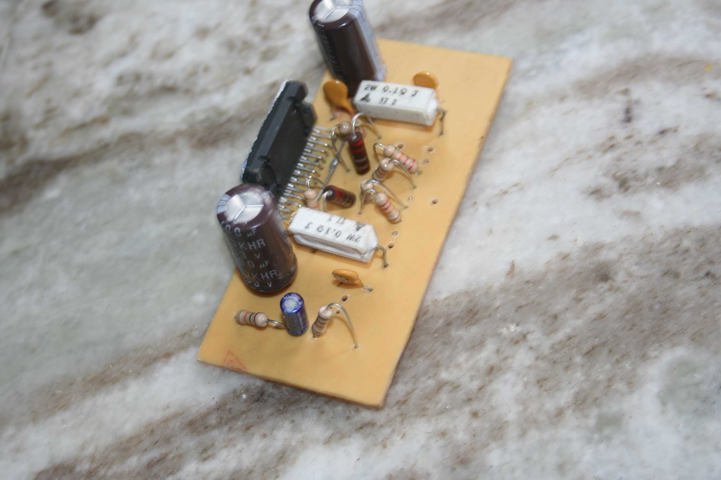

My LM4780
I tried pinkmouse pcb and it works . The Amp is super silent and yes , i used the component values from audiosector .Thanks to pinkmouse and Peter .
