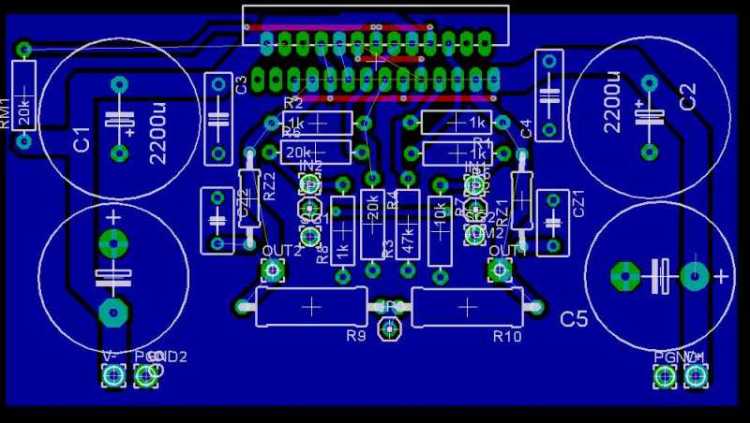

I'm confused about the printing of the eagle files. I have the files and I have the software, but I can't seem to get the pcb printed properly. I'm missing the earth-copper connections and I can't seem to get rid of the silkscreen. Could someone convert te image, which I should print, into a printer-friendly-format such as pfd?

SuperR, to get the groundplane you have to click 'ratsnest' or type 'ratsnest' in the commandline.
Then the groundplane will be poured in.
To get rid of the top-connections (wire-bridges) and silkscreen
go to 'view' , then to 'display/hide layers' .
deselect layers 1 (top), 21 (tplace), and 22 (bplace). Then choose 'OK'.
Now you should have your board as it should be printed.
When you choose 'print' , select 'black'.
This way your pcb will be printed in black.
When printing make sure the scaling (dimension) turns out correct.
Hope this makes it clear.
If you have any questions or if you dont succeed drop me a line.
(i can also export to bmp for you)
edit: make that to pdf
Groeten,
Klaas
I changed PCB pinkmouse. PCB is universal. It works stereo and parallel.
