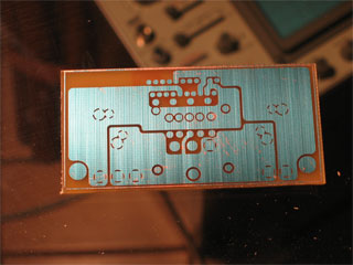

To provide an update on my progress, I've managed to etch the BrianGT design on a double-sided presensitized board. So far everything looks like it lined up okay.
Tonight I'll drill away (carefully!) and hopefully get something assembled. Out of the 8 (!) boards that I produced (I had a 6x6 board -- all my local shop had) only 4 survived. 🙁
I will let you all know how well it works when done fully DIY at home. So far, the drilling doesn't look too clean on the "other side" and hopefully it doesn't affect the soldering of the board.

I've built up one of the boards that came out from the etching process. It was a bit of a pain to drill (first time with the dremel press...) but it turned out okay.
I don't have any of the fancy-schmancy resistors that you guys suggest for the design, and I deviated slightly on the values of some of them (20 vs 22k all around). I did use 1% resistors for all of them, so it ain't all *that* bad...
Also, I used my 5W sandbars on the output for this. Placement was a pain all around, and I used a scrap SMT resistor I pulled off of something a while ago.
I just said "screw it" and powered it up after assembly (since I trusted Brian and all the diyaudio folk's design, and didn't make any fatal mistakes while soldering) and to my amazement it seemed to work okay. Unfortunately, I have a constant buzz which I also noticed on the last few p2p wirings I've done that have not included any filtering caps other than the power decoupling caps, and turning the 50k pot I use to the min and max produces static.
I think that there are some other issues with my setup that I have to resolve before going further (like the power supply which consists of a surplus rectifier bridge, some 200V 470uf caps about 1ft away, and 100uf 50V caps as decoupling caps on the PCB). I'm sure that will give you an idea of how crappy things likely are.
On the scope, I noticed some interesting tidbits that you guys might want to hear about (I don't know if they're my issues, or the design...you guys talk amongst yourselves). Between the -ve voltage line and the ground plane I notice that there's a lot of signal crosstalk from the audio. Also, I noticed that my caps must not be supplying enough smoothing since there's the textbook "caps after rectifier" saw wave showing up mixed with the audio signal. Does this make sense? Do you think the fuzz/buzz I'm hearing has to do with the power supply rejection kicking in?

After a lot of trial and error (mixed with working in a rush) I figured out the source of all the badness.
I was a bit silly in my interconnects, and tried to integrate the PCB into an existing configuration (that had its own ground star). Obviously, this is a suboptimal grounding configuration, because BrianGT's board takes care of grounding for you.
Today at lunch time, I re-wired everything "properly" with two of the populated boards and voila! It sounded perfectly fantabulous! I am running it with a regulated supply I built using my own PCB design (originally based on Pedja's regulated schematic, but changed to work with my desired voltages) and it works awful well.
So if you guys had any doubts about whether or not the layout works, you can set them aside. It works quite well! 😉

Here you go! I optimized the images for quick downloading, and hence they're only 320x240 for the forum right now. They give the general idea of the quality of the build, which is generally not all that bad.
Had everything gone perfectly for me during the developing/etching, I would have made 8 boards for about $15 CDN. Drilling would have been cleaner if there was no copper around the pads, but I'm not being picky about that... 😉
The error in etching was mainly my stupidity getting the better of me, and using a piece of glass that was smaller than the area of the board I was developing. The edge of the glass left a hard line shorting out half of the 4780 pins on two of the boards. Another two boards may have been accidentally exposed to some light while I was lining up for the double sided exposure, however they may still be useful, as only a part of the V- and V+ planes got faded.
Now if only I could figure out how to make them red... 😉
Below is the bare board without any drilling.
