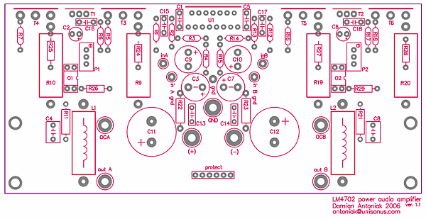

SpittinLLama, You are first person outside Poland that assembled this amplifier on my PCB. How is this thing working? What transistors are you using on output? Some pictures? LM4702 is quite sensitive device.
I have one more version of PCB ready - including microcontroller protection circuits (DC, thermal, over-current, soft-start).

I have microcontroller based protection circuit: DC, thermal, transformer soft start, over-current. This will be a part of my new board.

I placed few more small caps (56pF-1000pF) – input shunt resistor, feedback and I think that there should be a preamplifier for this amp – input is quite unstable and sensitive.
One more thing – SpittinLLama, if you would like to use more output transistors remember, that LM4702 output current is quite small and connecting transistors in parallel will increase gate capacitance.

This will be last boards with mosfets/darlingtons. Protection circuits on another PCB.
