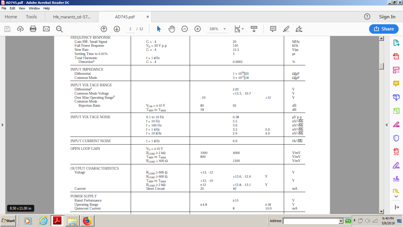

Have a look into the datasheet - there is information about noise density in datasheet. And popcorn noise can affect ALL opamps which are made with the same process - not only TI ones. The described ultra top performance of measured LM4562 opamps which was the need of one customer is only achieveable if he selects the best out of a big batch. IMHO the so called bad ones are mostly or all still in spec. Every transistor has a hFe min/max and noise min/max and you always need to select your pairs yourself. If this panic leads to the low price - no problem - I buy more and pre-select it for the application I want to build.
BTW: the above link to the so called bad opamps hasn't described the test method? Or I'm unable to see it...
BR, Toni

It seemed to me that the noise measurements weren't very far from the datasheet which is a big vague under 100hz, plus nobody knows
WHAT WAS THE SIGNAL SOURCE IMPEDANCE !!!
There's one more thing...his graphs are too linear in the 0-300hz region measured, even more linear than the datasheet graph which is a bit weird...
