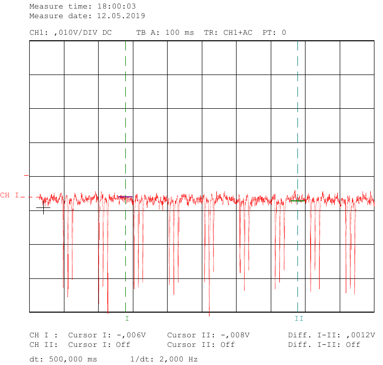

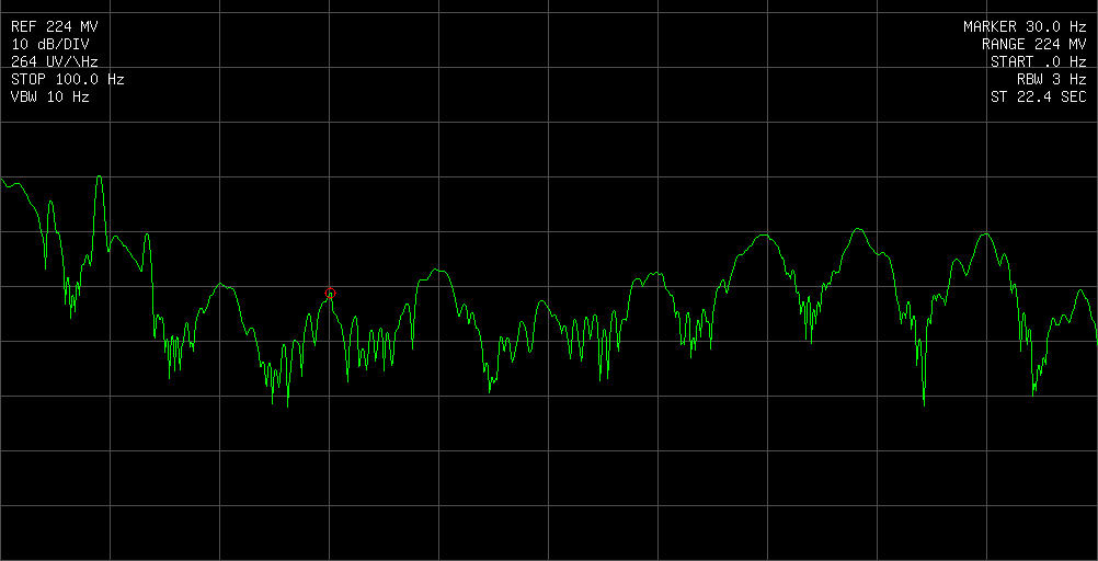

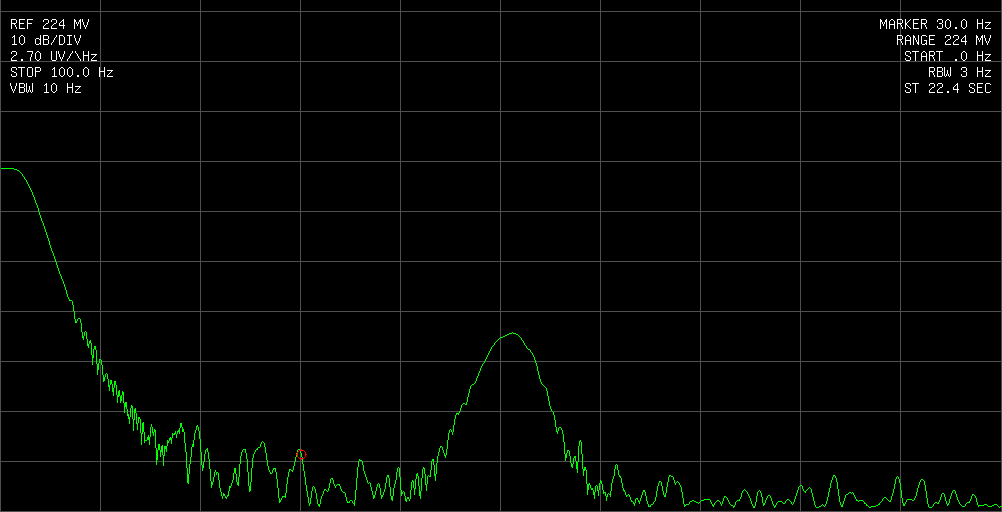

LM4562 and using the popcorn noise filter I can see the WLAN beacon of my home router.
The beacon interval is typical 100ms. Every exactly 100ms there are 3 short peaks viewable which can ruin the noise tests below 100Hz. It looks like the LM4562 RF immunity is not as good as compared to an old NE5532. But this may also be caused by the higher GBW of the LM4562.
So keep an eye on the pcb layout if you are using the LM4562 as ultra low noise opamp.
Switching off the WLAN router during measurements I even needed no extra shielding to get excellent and reproducible results.

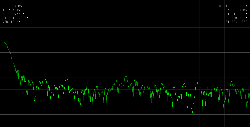

The dual opamp LM4562 is configured as shown in above popcorn measurement PDF from TI. Total gain is 10k.
The spectrum analyser range is set from 0Hz to 100Hz.
Dividing the uV/rthz output by 10000 gives nearly the nV/rthz.
  • Picture 1 testbed without opamp inserted. WLAN off
  • Picture 2 shows about 4.6nV/rtHz at 30Hz. WLAN off
  • Picture 3 shows measurement with WLAN active
  • Picture 4 shows the WLAN beacon peaks at output after LPF filter of measurement setup.
