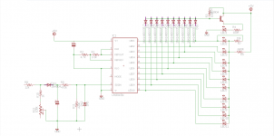

I'll have to purchase a few more 1k's to test that - Attached is the schematic you asked for.

2. I tested the circuit with 1k resistors between LM pins and LED's, with the diodes tapped of in between the diodes and LEDs - no change, 1st led is always lit.
1. I purchased a regulated 12v power supply - it will output 12v @ 200mA with input voltage as low as 2.5v - I can use an acc power up circuit on it.
Are the output pins of the IC now driving all of the way to ground?
If not, change the current limiting/programming for the outputs to no current limiting (only do this if there are resistors in series with ALL LEDs).

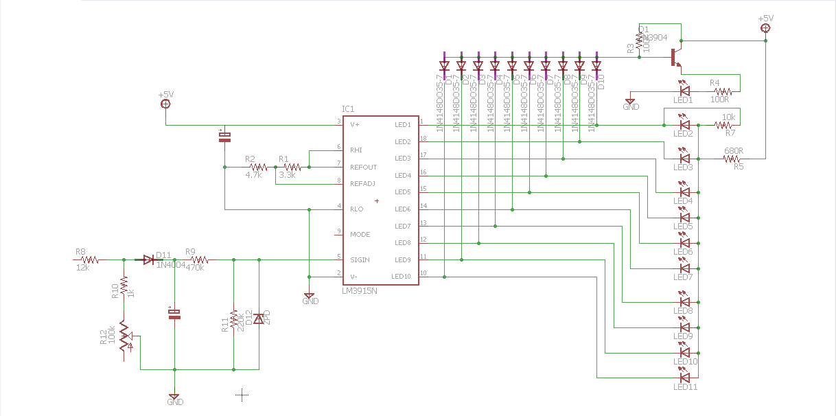

I had another go at it today.
LEDs 1-9 are white (forward voltage of 3v), LED 10 is blue (forward voltage of 3v) and LED 11 is red (forward voltage of 1.8v)
I've placed a 680 ohm resistor on the LED supply & set the LM to output around 3.8mA of current via a 3.3k resistor between pins 7 and 8. Also placed a 4.7k resistor between pin 8 and ground to achieve a full scale voltage of 3.02v
Here is the updated schematic:

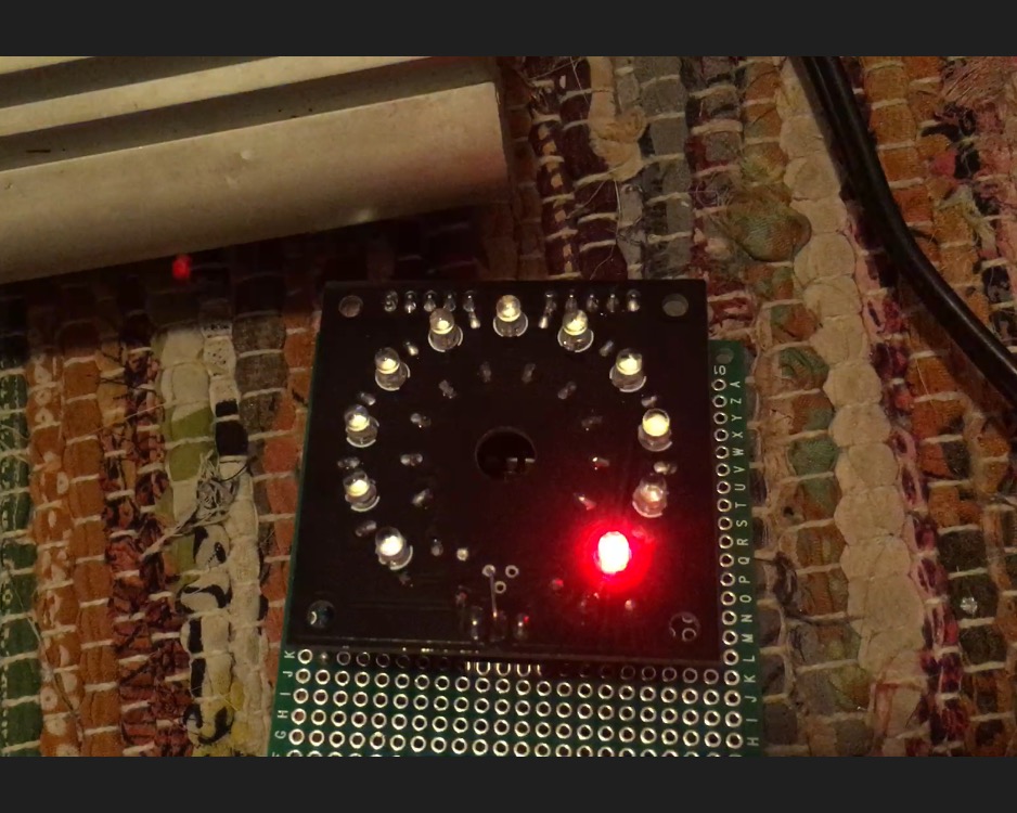

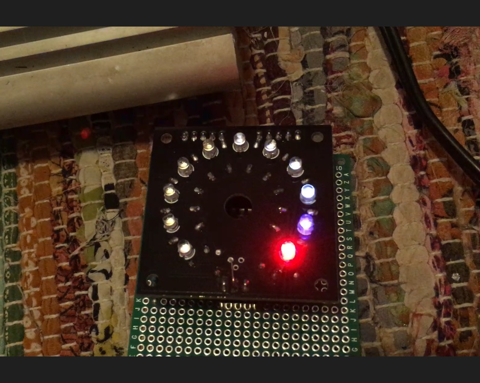

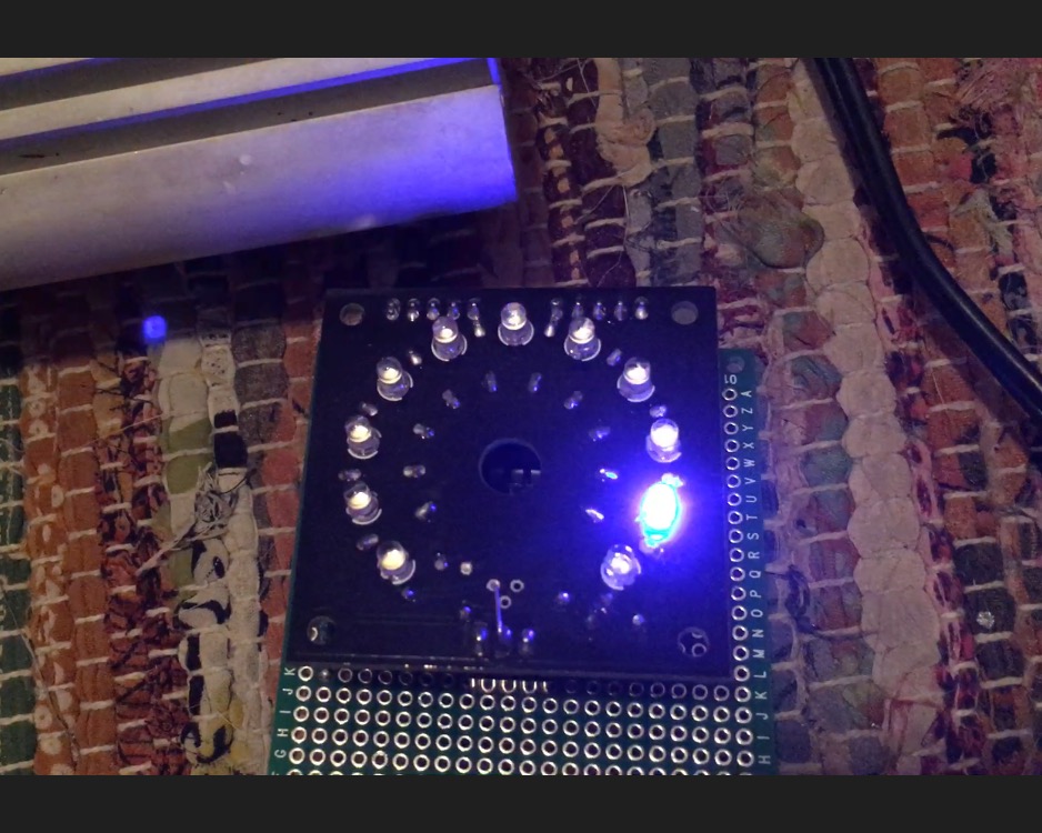

Now, this all works great, except for when the last led (red) lights up - I can see LEDs 6-10 light up very faint as well for a few seconds as if it flashes on and off.
LED 10 on (9 on LM)
LEDs 6-11 on (5-10 on LM) - This is the issue
LED 11 on (10 on LM)
I found this in the application hints
From my understanding, I need to add a small capacitor between pin 7 and ground, as this may be due to oscillation?
LED 10 on (9 on LM)
Application Hints
The most difficult problem occurs when large LED currents are being drawn, especially in bar graph mode.
These currents flowing out of the ground pin cause voltage drops in external wiring, and thus errors and oscillations. Bringing the return wires from signal sources, reference ground and bottom of the resistor string to a single point very near pin 2 is the best solution.
Long wires from VLED to LED anode common can cause oscillations. Depending on the severity of the problem 0.05 μF to 2.2 μF decoupling capacitors from LED anode common to pin 2 will damp the circuit. If LED anode line wiring is inaccessible, often similar decoupling from pin 1 to pin 2 will be sufficient.
If LED turn ON seems slow (bar mode) or several LEDs light (dot mode), oscillation or excessive noise is usually the problem. In cases where proper wiring and bypassing fail to stop oscillations, V+ voltage at pin 3 is usually below suggested limits. Expanded scale meter applications may have one or both ends of the internal voltage divider terminated at relatively high value resistors. These high-impedance ends should be bypassed to pin 2
with at least a 0.001 μF capacitor, or up to 0.1 μF in noisy environments.
