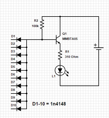

Done some reverse engineering:
Here is what I have for the Power On/Led#1:
D1-10 connect in series with the led output 1-10 from the LM3915.
Transistor collector will go to the same supply voltage as the LM.
LED cathode to ground.
How does this look so far?
I know R1 (300 ohms) should be limiting the current to the led, identical to the current that the LM will provide to leds 2-11, so its value may change.

That looks right. When no 3915 LEDs are lit, all outputs are pulled high and the NP transistor is driven to conduct. When any LED is on, the base/emitter voltage on the NPN transistor goes negative and the transistor switches off.

So I've finally gotten around to building this thing.
The 1st led works great with the NPN switch, but only with a 5 volt supply.
I'm using blue LEDs for leds 2-9 (1-8 on the LM) and amber/red on 10/11 (9 and 10 on the LM).
Here are the issues when all powered by 5v:
1. When amber/red are lit, the 1st switched led turns on but dim.
2. There is alway a small voltage on switched led - it can be seen lit in dark.
When on 12v i get the following:
1st led is lit no matter which other led is on.
here is what I suspect: there is not enough voltage drop after the led, so the NPN is not being pulled to ground.
How do I overcome this? Add 1k resistor on the led supply? This "should" drop the voltage enough, but I'll have to up the current on the LM?

With 12v, what is the voltage on the driver leg for an LED that's lit? Black probe on ground, red probe on IC leg.
Full schematic?
Full schematic?
9.75v between lit leg to ground.
If I stick a 1k resistor on LED supply I get a reading of 3.02v
Also important to mention - i have a 10k resistor between pin #1 and v+
Reason is, at full scale the first led would leak current and light up slightly.
In the data sheet it is mentioned that the max current leak on pin 1 is around 120uA as opposed to 3-4uA on pins 10-18.
Regarding schematic - dont have a full one at hand, but the PNP is as illustrated a few posts back.
On the LM, using variable resistors between pins 7-8-ground - set to 1.2/2.2k between pin 7 and 8, and 2.2k between pin 8 and ground.
As mentioned above,10k resistor between pin 1 and V+.
2.2uF cap on pins 2/3.
Pin 6 connected to ground.
On pin 5 I have a 2 stage voltage devider with a half wave rectifier and a 0.5uF cap for slower led decay.
So first voltage divider is variable between 1.1:1 and 15:1 ratio. I then rectify the AC signal and smooth/delay it with the cap, then drop voltage down again at a 3:1 ratio. Additional 10v zener to limit voltage.

That transistor should be an NPN transistor, not a PNP transistor.
Would it be difficult to insert a 1k resistor between the LEDs and the pins of the driver IC? 1 for each driven LED.
Sorry, it is an NPN. I had a blank moment there.
So you suggest to put a resistor between each IC pin and LED. The dioides will then connect as usual at the LED - diode taps off between LED and resistor?
What is the difference in placing the reaistor on the IC side rather than the supply side?
