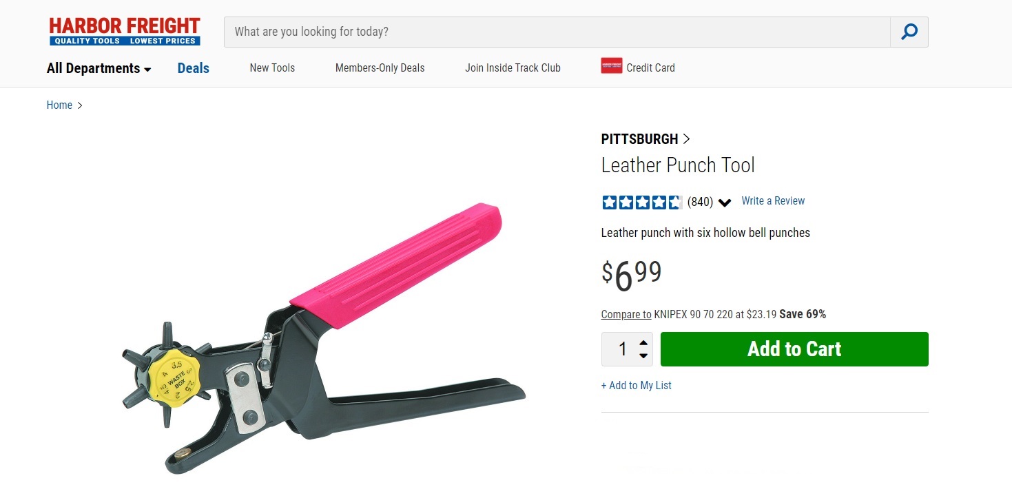

Best is to punch it in a male/female die and that´s what factories do; at home you can drill a clean hole through with a sharp new drill and going slow,so you let drill edge actually *cut* kapton, which, after all, IS "plastic".
You´ll end with a round hole but a slightly raised burr around, which you remove by twisting a larger diameter drill (8-10mm) by hand.
Do it both sides.
Do it both sides.
Laser cutter will do a fairly good job, though you have to clean the edge:
Processing Kapton(R) Using Laser Technology
I'd worry that might not be sharp/precise enough for kapton, leather is much more crunchable and much thicker. The kapton film I have is 0.05mm thick.
