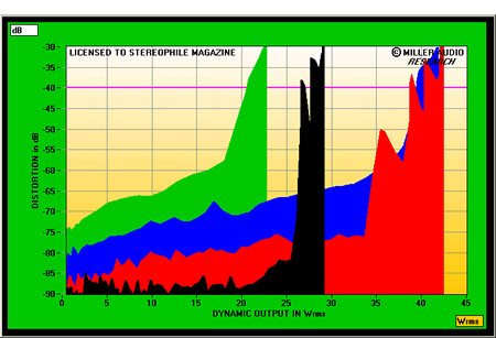

As for the 47 labs gain card, give 6 loons a miss and read this 47 Laboratory 4706 Gaincard power amplifier | Stereophile.com . My the review sample went bang.
The measurements are about the worst I have ever seen for a chip amp. The fact that it costs a fortune measures worse than a cheap AV receiver and would not meet CE approval in europe as runs to hot are hardly glowing recommendations. I have a 50 year old tube amp that has better measurements than this overpriced and overhyped example of the worst of boutique audio.
That is truly awful. From the wobbles in the frequency response and the channel-to-channel interaction it is clear that they seriously screwed up the power supply and/or the supply decoupling. 0.3 % THD, 36 dB channel separation, plenty of mains-related IMD. That's a design fail in my opinion. They want $3300 for that?! Wow.
6 Loons. LOL! I like it.
Tom

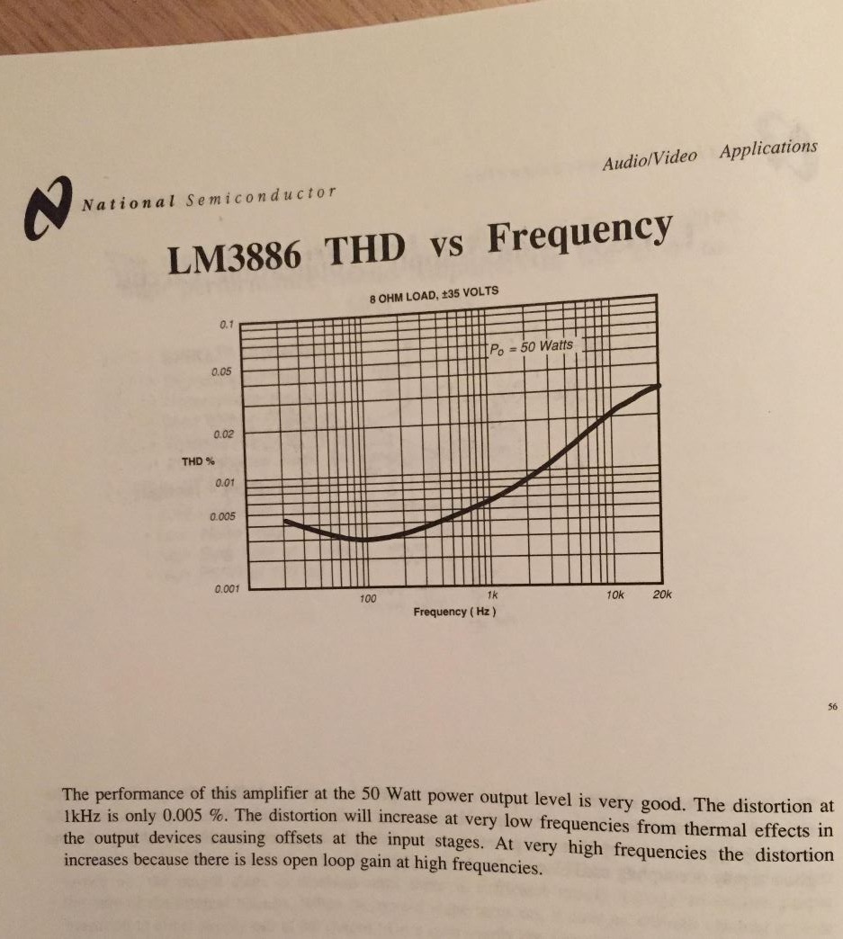

These chip amp devices find themselves being used in numerous applications, even outside of audio such as small motor drives, there are even some mil gear that uses them to drive headsets and remote speakers. They are a useful little device, but do need to be respected, kept cool to work at their best and LAST. I do understand and know what a pain MTBF is, but also see the results of extended temp range testing etc.
National says distortion increases because of limited open loop gain.

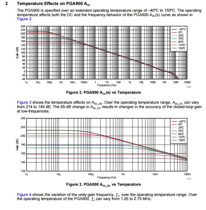

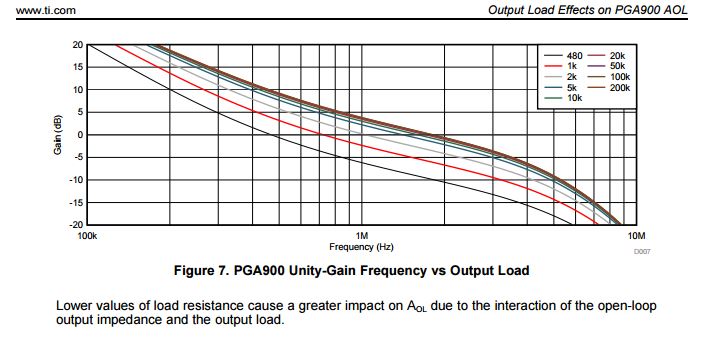

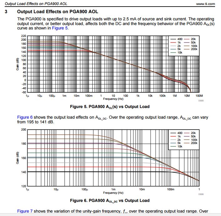

I wonder if the same effects as in this test applies to the lm3886?
http://www.ti.com/lit/an/slda031/slda031.pdf
That is open loop gain (and distortion) gets worse both with lower load resistance AND increasing die temperature.
The Miller measurements from link in post #88 indicates this. But has anyone made or seen measurements on distortion vs temperature?
