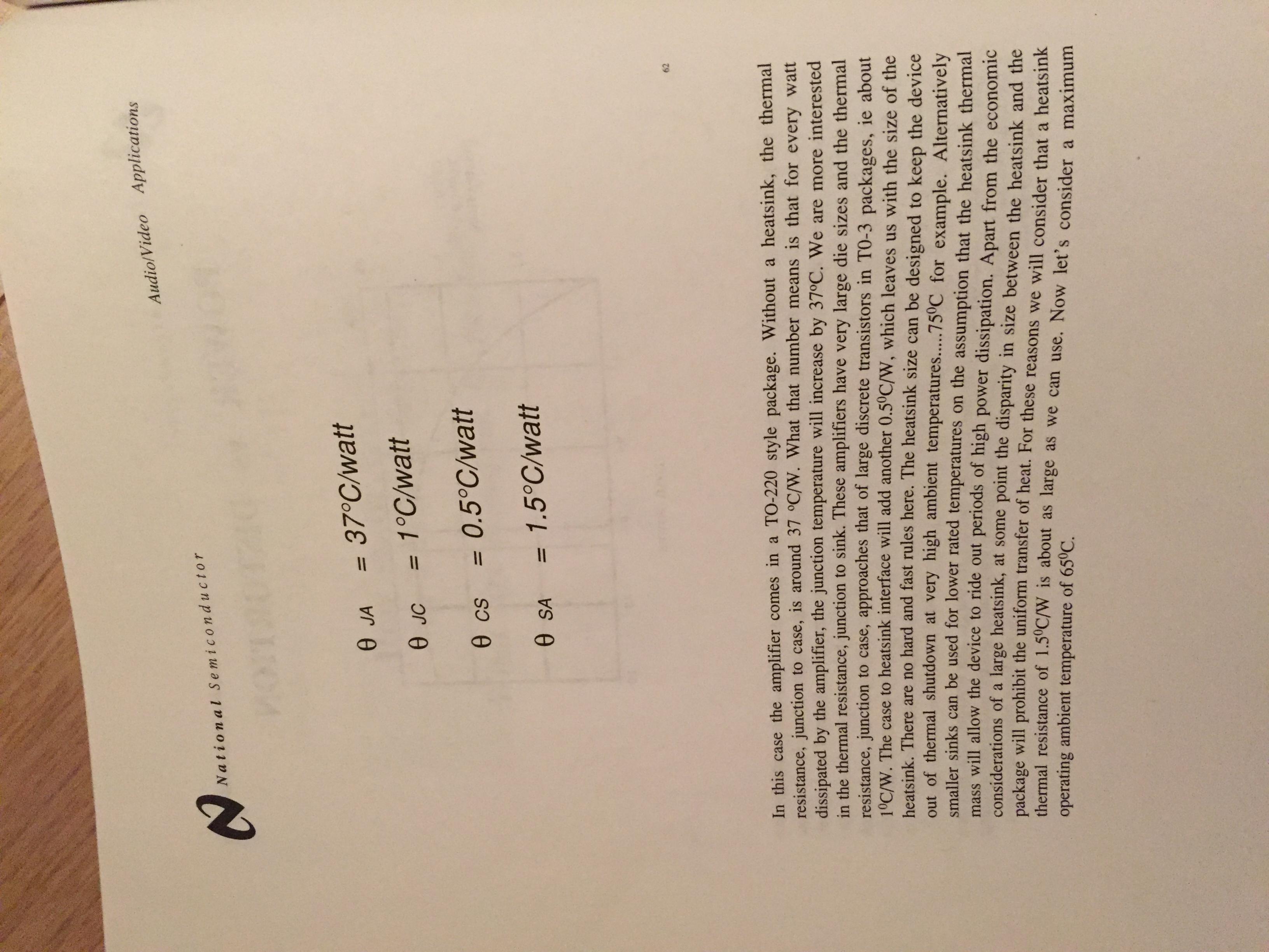

The information on nonuniform distribution of heat in heatsink with lm3886 package I have from National:
http://www.diyaudio.com/forums/atta...96d1473374772-20-years-ago-today-img_1911.jpg
They said 1.5 is lowest practical thermal resistance of the heatsink. Lower than that the heat distribution gets nonuniform.
And the temperature gradients in aluminium is fast, but how fast. Clearly under 100ms figure 11 shows that the heat disipation is not linear with 1/time (W = J/s) so chip and heatsink can't operate as one unit. (The whole heatsink don't get to 250 C in 100 ms)
Still I do not understand why the time to equlibrium takes 15 minutes in, for example, this case:
Total termal resistance 3 C/W
Total Vcc 50 V
Po max 30 W
8 ohm
5 watts electrical output is about 15 thermal watts (figure 36)
Then the heatsink gets to 45 degrees above ambient.
I really do not understand that it will take 15 minutes to reach 45 degrees above ambient for the whole heatsink to air interface?

Ok, But at some time long before that the sub second difference in radiated power by the chip will get much higher than the sub second difference in heatsink temperature. So the sub second difference in heatsink temperature can be ignored after few minutes. (For chip amps)

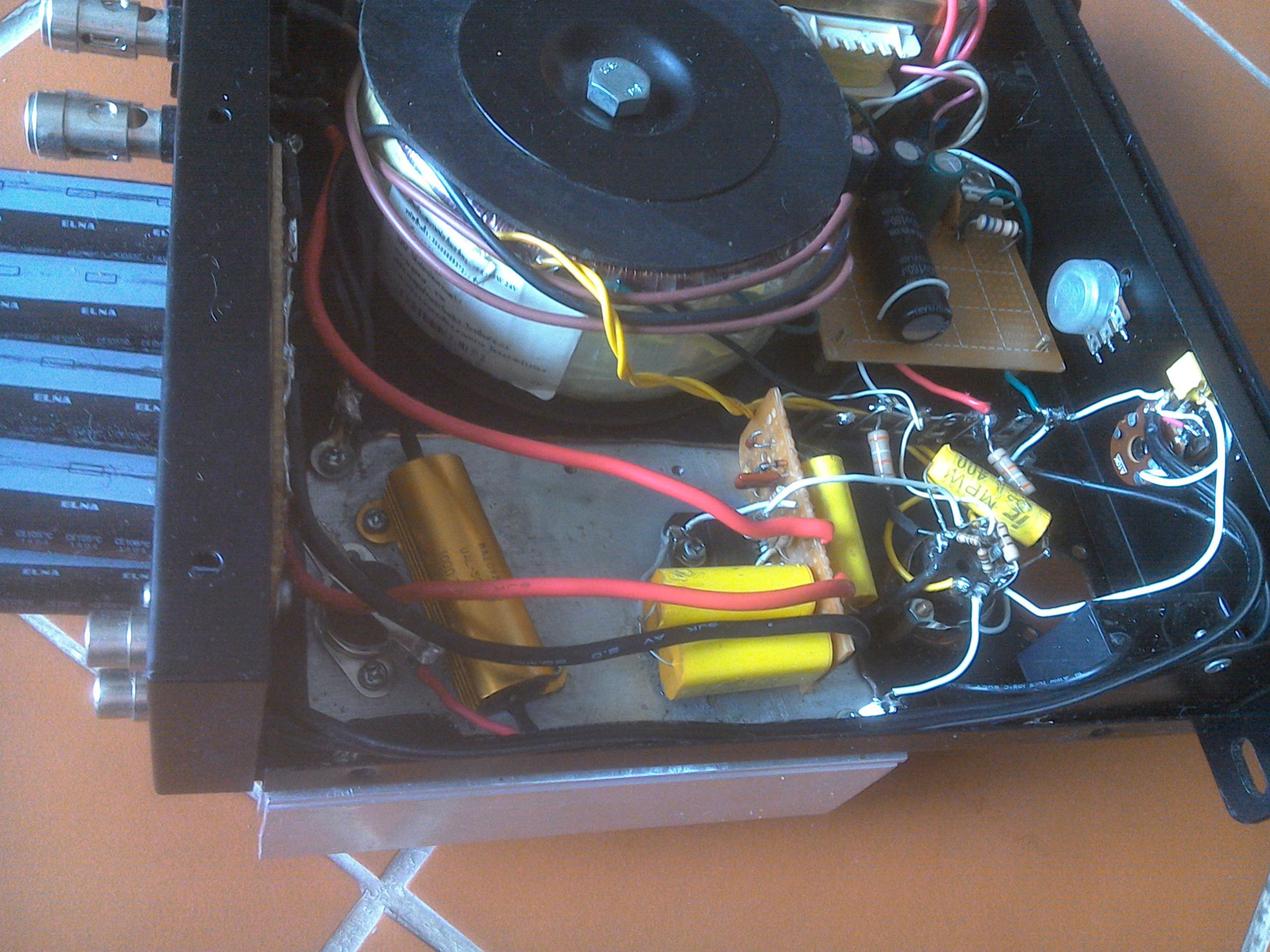

heat the heatsink
You can heat the heatsink by a dissipating resistor with maximum IC 's dissipation, regulated by a thermo-switch. See picture bellow as well as new thread ,hybrid lm3886+triode ,Andrea, a democratic hybrid amplifier for luxury sound.http://www.diyaudio.com/forums/tubes-valves/297206-andrea-democratic-hybrid-amp-luxury-sound.html
