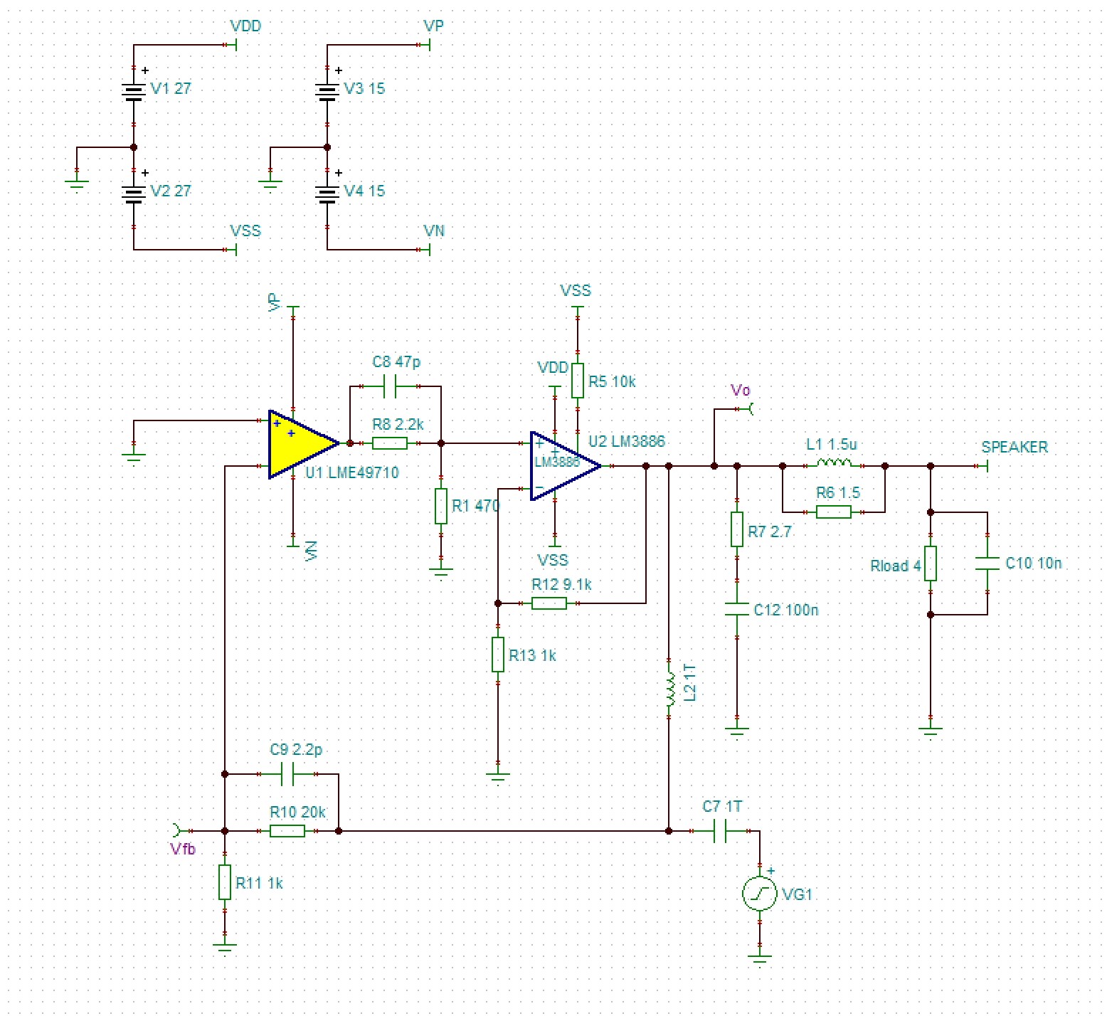

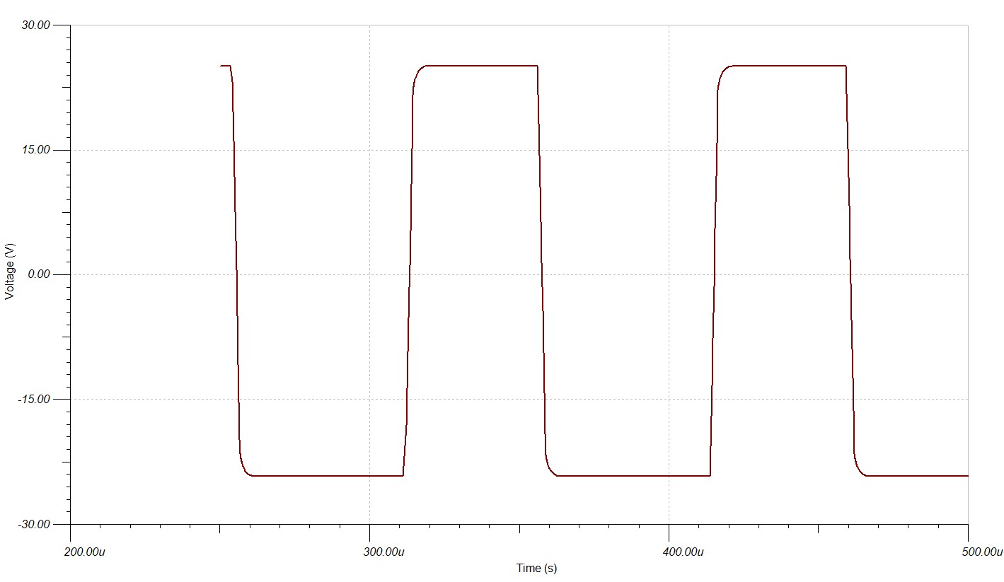

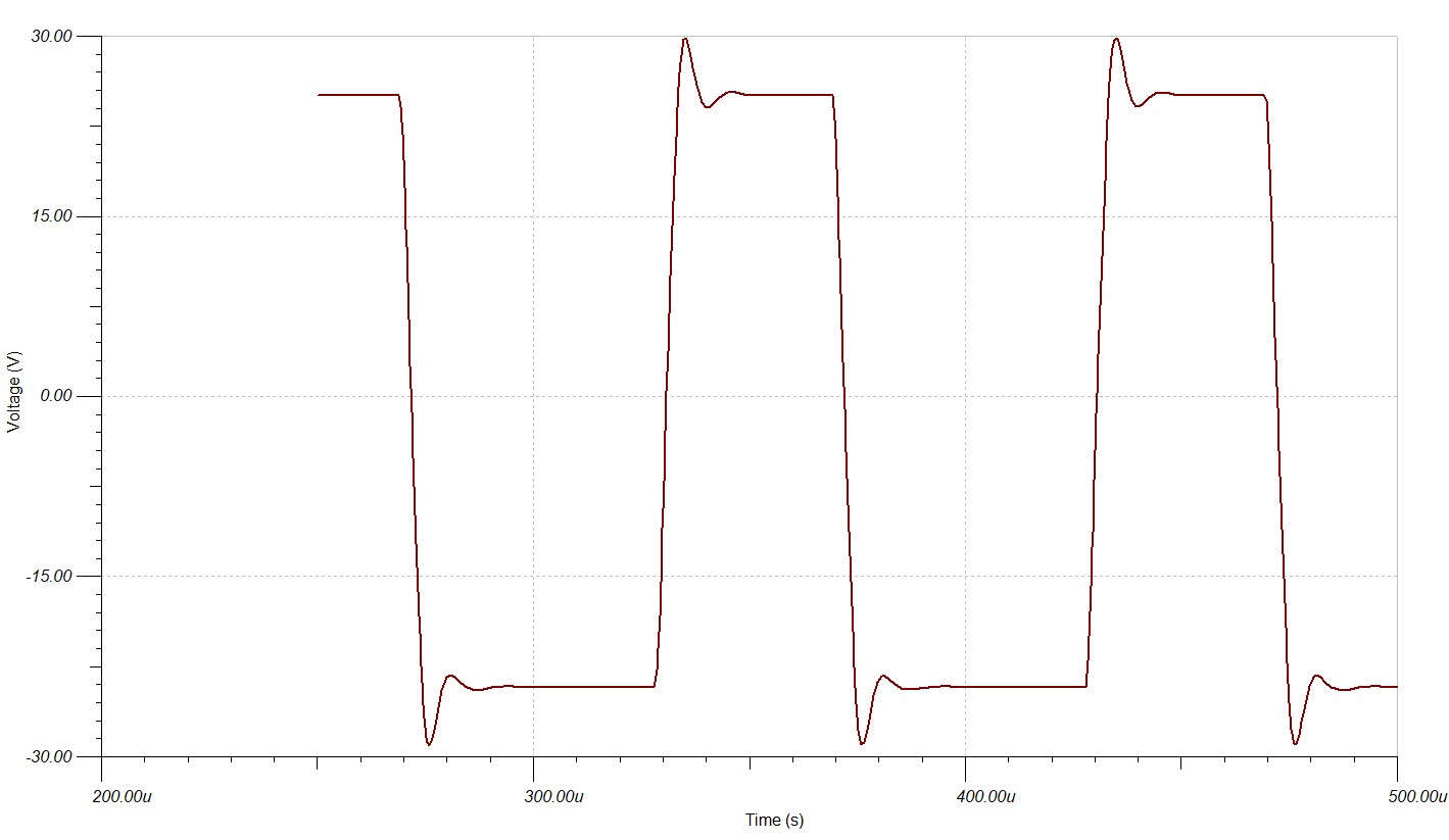

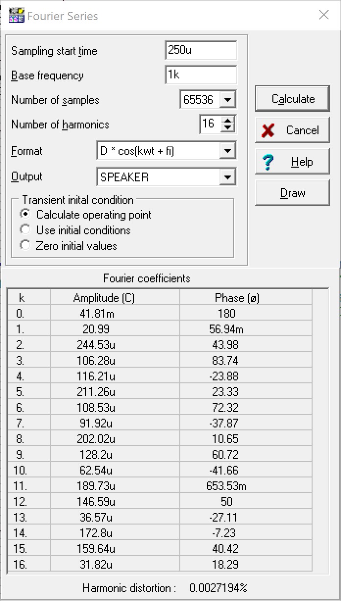

Still continuing to have fun learning about things, I thought I'd kill two birds with one stone and learn Tina TI, whilst figuring out how to design a simple composite amp using the LM3886 as the power amp.
It took quite a bit of playing around with the circuit but I think I've found something that works*.

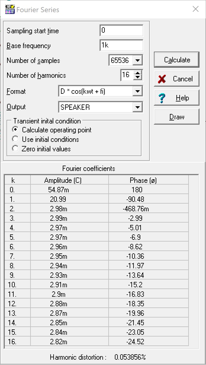

First things first I wanted to keep it as simple as possible, so no balanced inputs or DC servo (I think I'm correct in assuming that a DC servo replaces the DC coupling cap at the input).

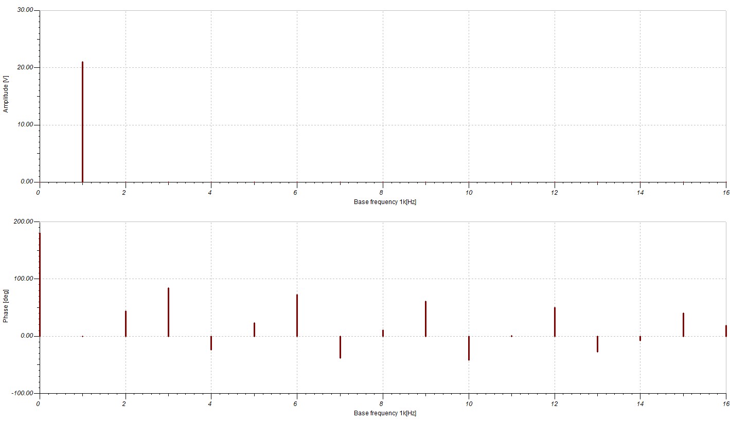

I also modelled the standard LM3886 amp with all the stability components to get a THD baseline. With a 1kHz base frequency, Tina TI's Fourier Series analysis reports a harmonic distortion of 0.054%. I know this is based on "ideal" components, and doesn't take into account parasitics and PCB layout, etc., but it's a useful baseline.
The composite version, using a LME49710 I've got the HD down to 0.0027, which is around a 20x reduction!

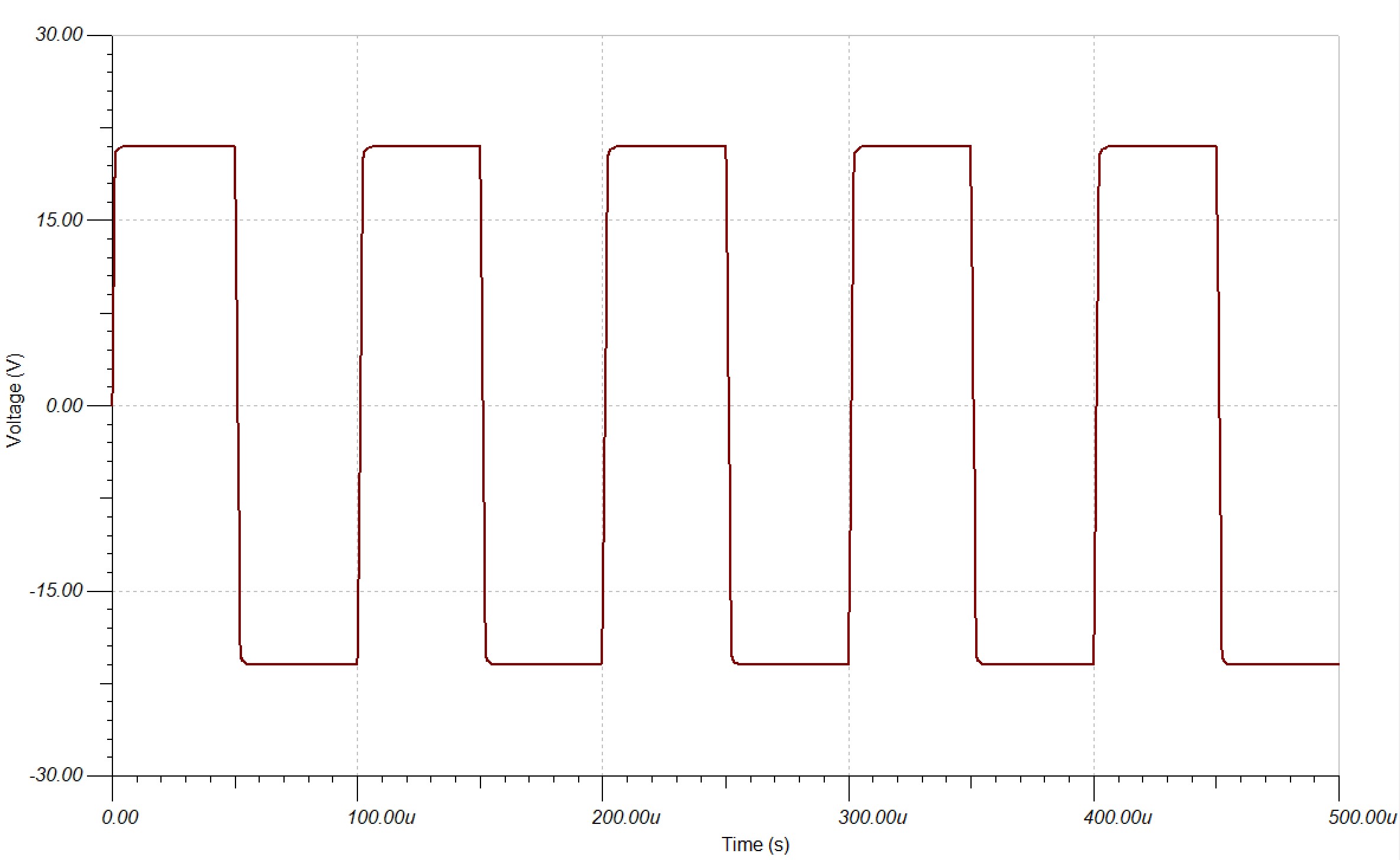

I've also tested it with 10kHz square waves with various capacitances across the load, and the square wave is stable (it took adding in C8 to achieve this, as before, any square wave would oscillate wildly; I also tried using Cf and Rf2, and while this helped with the stability, it affected the distortion to the non-composite levels).

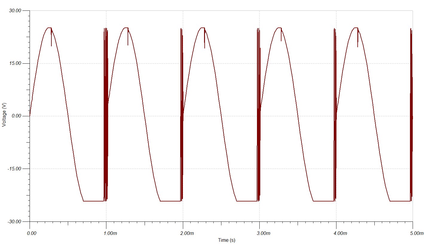

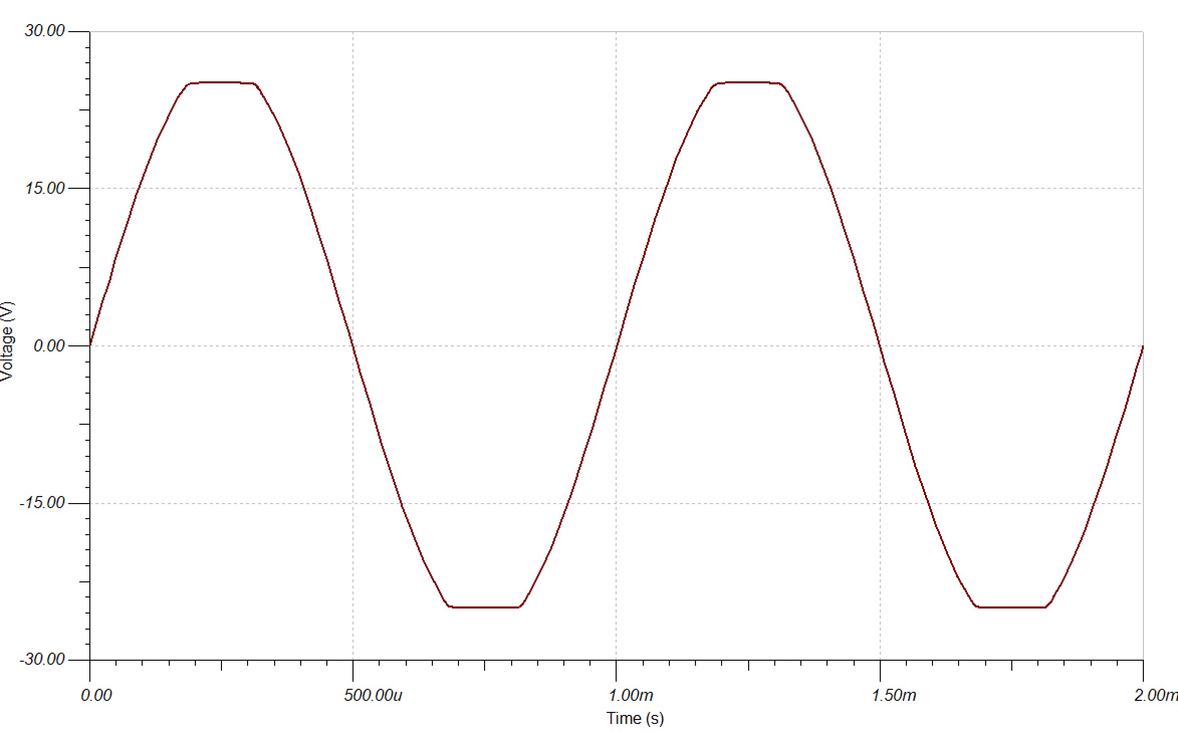

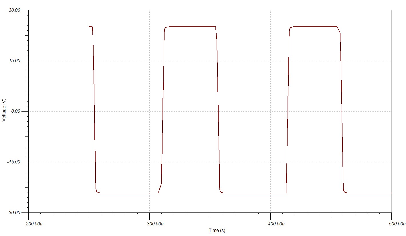

*the one area it definitely falls over is at clipping. Something catastrophic happens when the amp goes into clipping, so that will need fixing.
I guess my questions are, what additional components do I need to make this a successful design, and do I need to move anything around? I was a bit confused as to whether stability components go in the inner loop, or the outer one, or if they're needed at all.
Any and all feedback gratefully received. Thanks for your time!

I'm not aware if the outer and inner loop should have identical gain. You still need the outer loop to set the final gain, and the inner loop to be as stable as possible (so a high-ish gain). I would start with a gain of about 30dB on the inner loop.
When the LM3886 reaches clipping its internal spike protection activates, which probably drives the outer loop nuts. You can probably model in a threshold limiter or a soft-clip to help with this.
Looks like you're off to a good start. Don't focus too much on the THD in the simulator as distortion is not included in the device models (at least not for the LM3886 and I don't think for the LME49710 either). Also note that anything related to the power supply and PSRR of the LM3886 is not included in the model either. In fact you can run the LM3886 model with full output swing into a 4 Ω load and its power supply current remains at a steady 50 mA. Lame, but it's what we have to work with.
As Sangram points out, you don't need the two loops to have identical gain. In fact, many of the first composite amps ran with the inner amp running open loop.
If you haven't already, I suggest reading about the LM3886 here: Taming the LM3886 Chip Amplifier – Neurochrome
I think you'll find the stability section pretty interesting. I need to update that page as I've gained new insights, but you can at least see the methodology I use to determine amplifier stability.

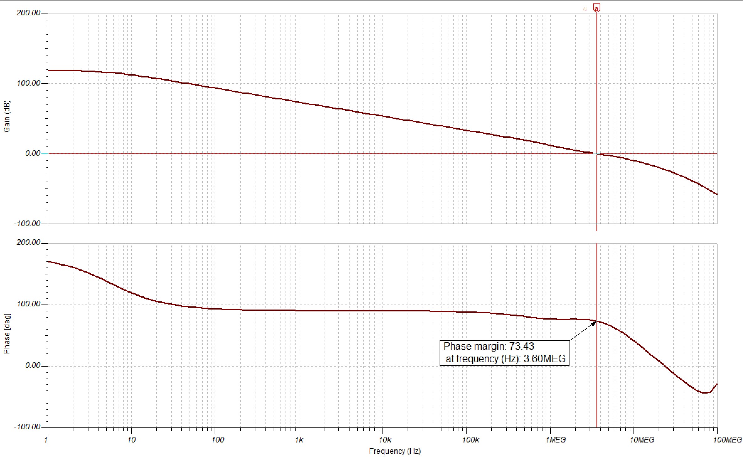

Once you have the amp stable in the frequency domain, run the time domain simulations. So look at overshoot with a capacitive load and clipping behaviour in the simulator.
Then once you get the amp running nicely in the simulator, build it, iron out the last kinks, and characterize the distortion in the lab.
It's a fun project. Best of luck!

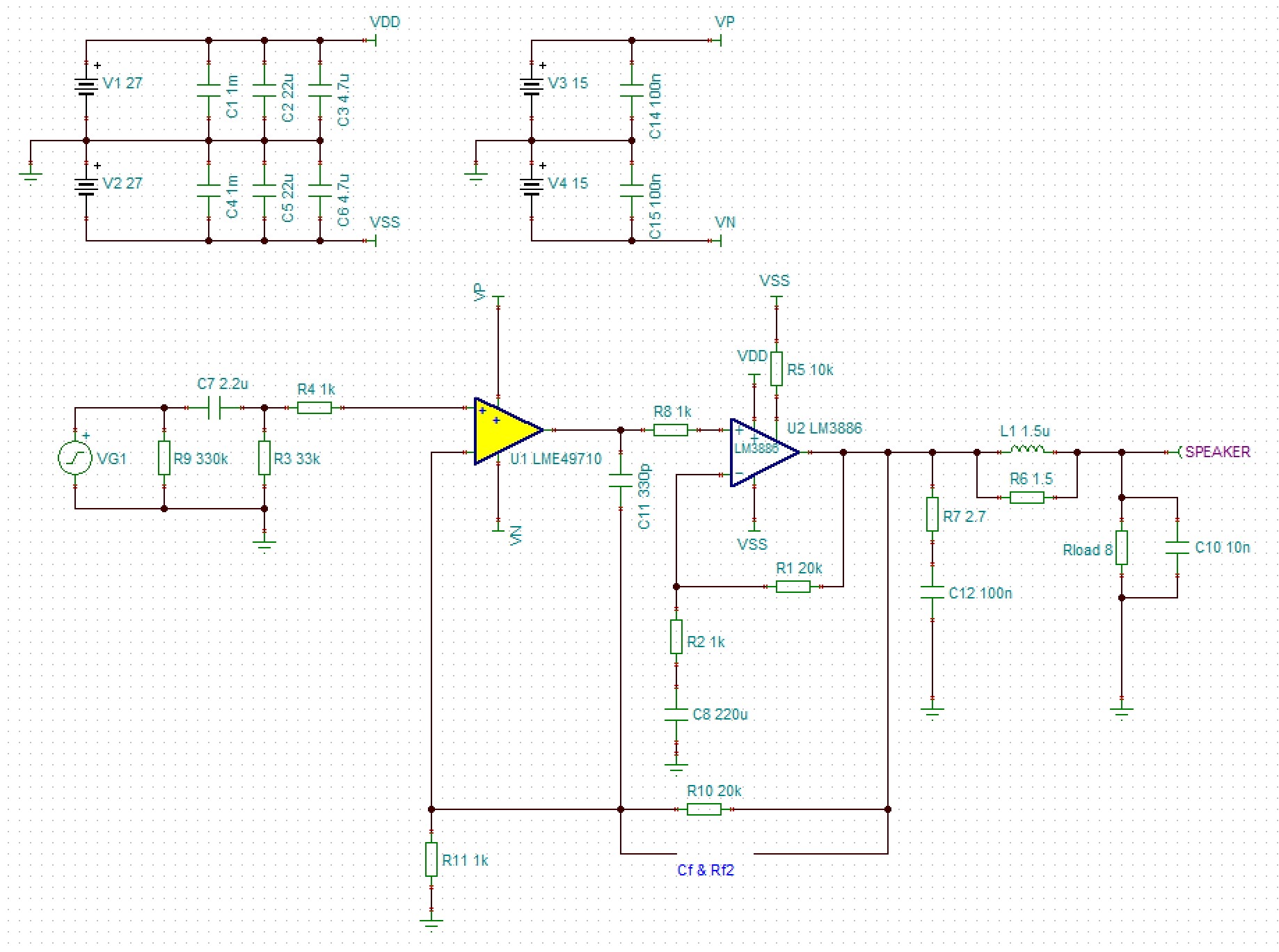

Thanks both.
Tom, if you look at the power decoupling you may recognise the combo of capacitors I've used, so that's a clue that I've read your Taming series 😉
I did read your Stability page quite a few times, and I must admit one or two of the concepts I still find a little difficult to grasp. However a bit of background regards my experience with the 3886: I've actually designed & built my own LM3886 amp PCBs (the thread is here), which are performing well. I'm listening to a pair now, and they don't sound half bad! I don't have test gear to accurately measure distortion though, but that's another story.

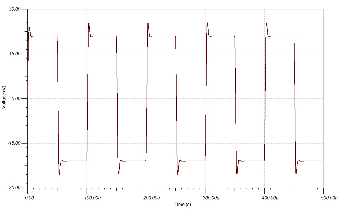

Once I'd built my amps I tested them with 10kHz square waves and various capacitive loads and noticed some heavy ringing with anything above 100nF. It was experimenting with a third amp board ("Frankenstein's Monster") that I discovered that (at least with my layout, etc.) the Thiele network specified in the data sheet (0.7uH || 10ohm) wasn't adequate, and a larger inductor (I estimate about 1.5uH) and a much smaller resistor (1.5ohm) sorted things out.
The sim circuit has the Zobel and Thiele networks for stability, and the Theile components are those I arrived at with my practical experiments. This is keeping the capacitive oscillations under control in the sim.
In a "Bare" LM3886 circuit, the 220p cap between IN+ and IN- keeps the clipping behaviour under control, but including that in my sim sends the amp into crazy oscillations that would undoubtedly blow up my speakers!
Now I've got the hang of Tina TI (better than LT Spice for a number of reasons) I'll have to try some of the sims you detail in your article. I think I need to get my head around the inner and outer loops, and what each contributes to the circuit.
I've since changed the inner loop gain, and found that a smaller gain seems to work better than a larger gain. I'll also try open loop to see how that works.

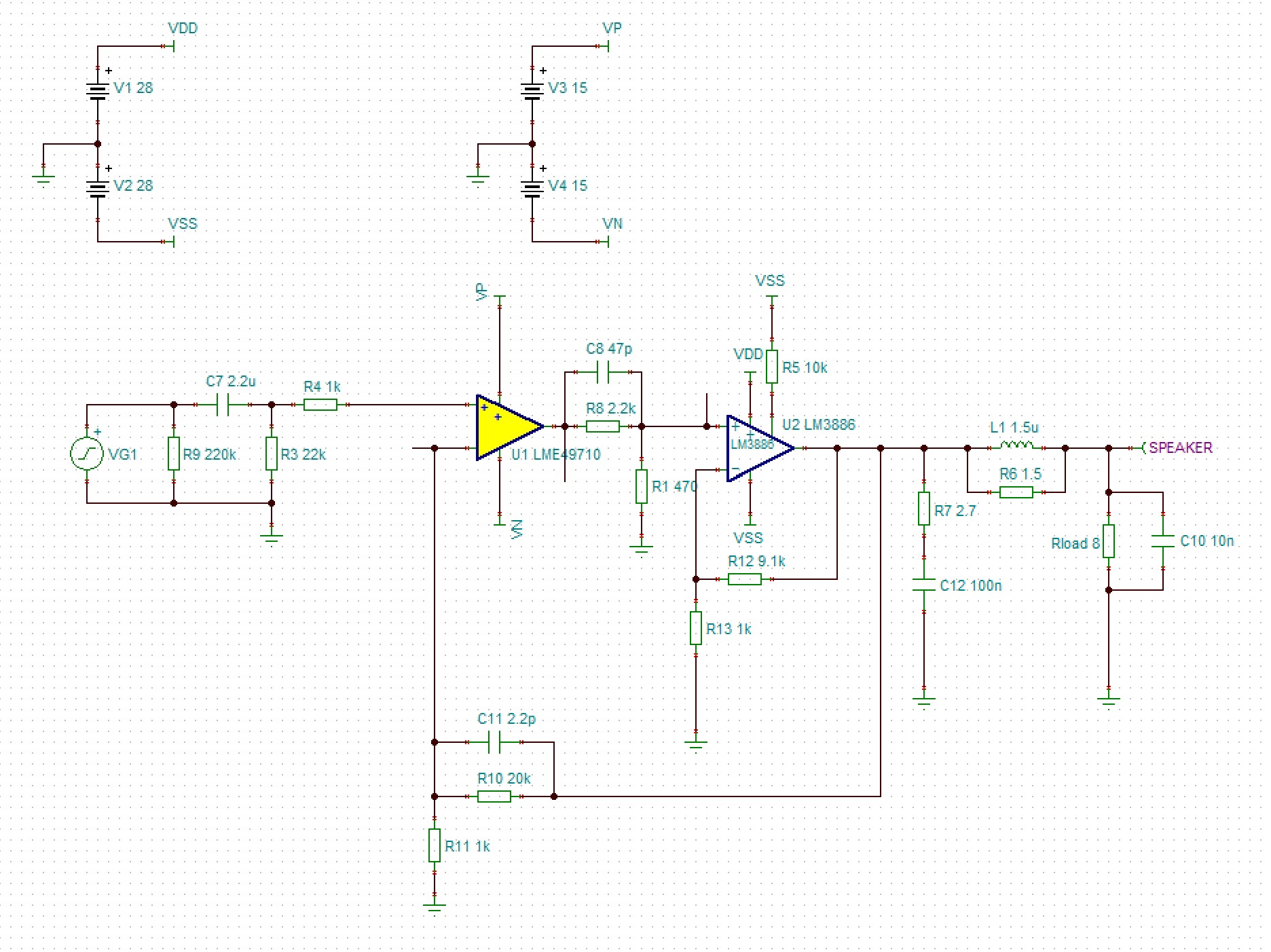

OK, OK, I'll take it. It's tough being the "noob" on a place like this. As I said, I'm still learning, so a bit of **** taking is to be expected. 🙂
Anyway, more research and blatant theft later, and I seem to have arrived at a circuit that appears stable under simulation, and handles the clipping behaviour. I added the resistor divider from jeanleflambeur's composite amp, just to see what it did, and lo and behold, no more horrific oscillations upon clipping. It took me a while to see how it was working but I noticed it was clipping the LME49710 before the LM3886. The resistor values aren't the same because my feedback resistor values are a bit different, so they needed to be tuned to something more appropriate. I also played around with the small capacitors to achieve the results I ended up with. So thank you Jean!
I might not yet build this one, but it's been fun learning. Thanks for the comments.
Here are some images.

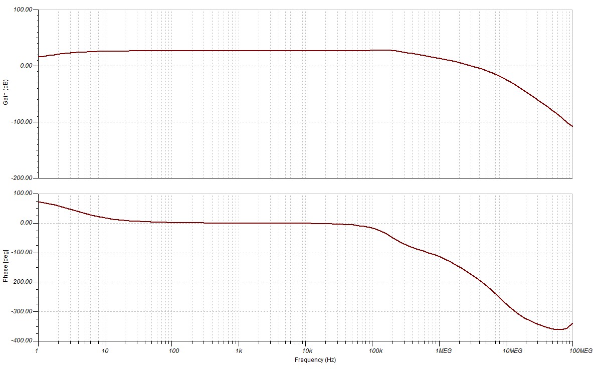

In order: updated schematic (sans decoupling caps 😉 ), closed loop Bode plot, clipping behaviour, 10kHz square wave with 100nF, 10kHz square wave with 470nF, open loop schematic, open loop plot showing phase margin.
