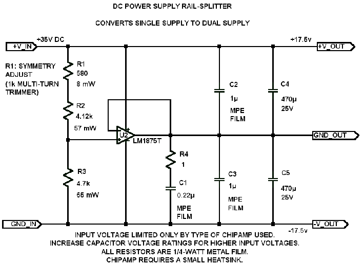

thanks for the schem gottee. that looks like a great circuit, how much current can it handle? It looks like you you used it for a low current application, but I'm wondering if I could get 40W+ out of it. If not I can use it for projects in the future though.
The low current across the resistors on the left is just for setting the output balance. The output current sources from/sinks to the rails via the power pins on the IC and is limited by the current capability and heatsinking of the IC. Cool design for applications where a floating ground is acceptable.
The max current DEPENDS ON WHICH CHIPAMP IS USED. So do the max rail-to-rail voltage and the max power. If LM1875 is not enough, try LM3875, for example. Look at the datasheets for the specs and maximums.
You could also parallel two or more chipamps, to increase the max current and max power capability. You would just need to add a small resistance in series with each chipamp's output (say 0.1 Ohm), just before the point where the outputs all joined. You would want to keep a Zobel network for each chipamp's output
