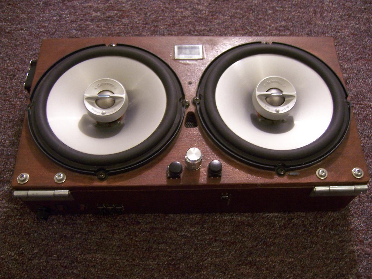

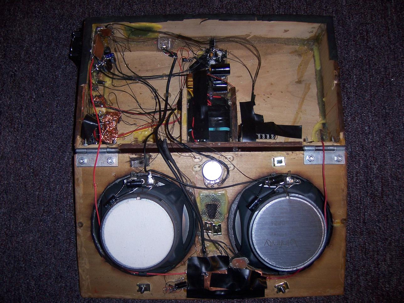

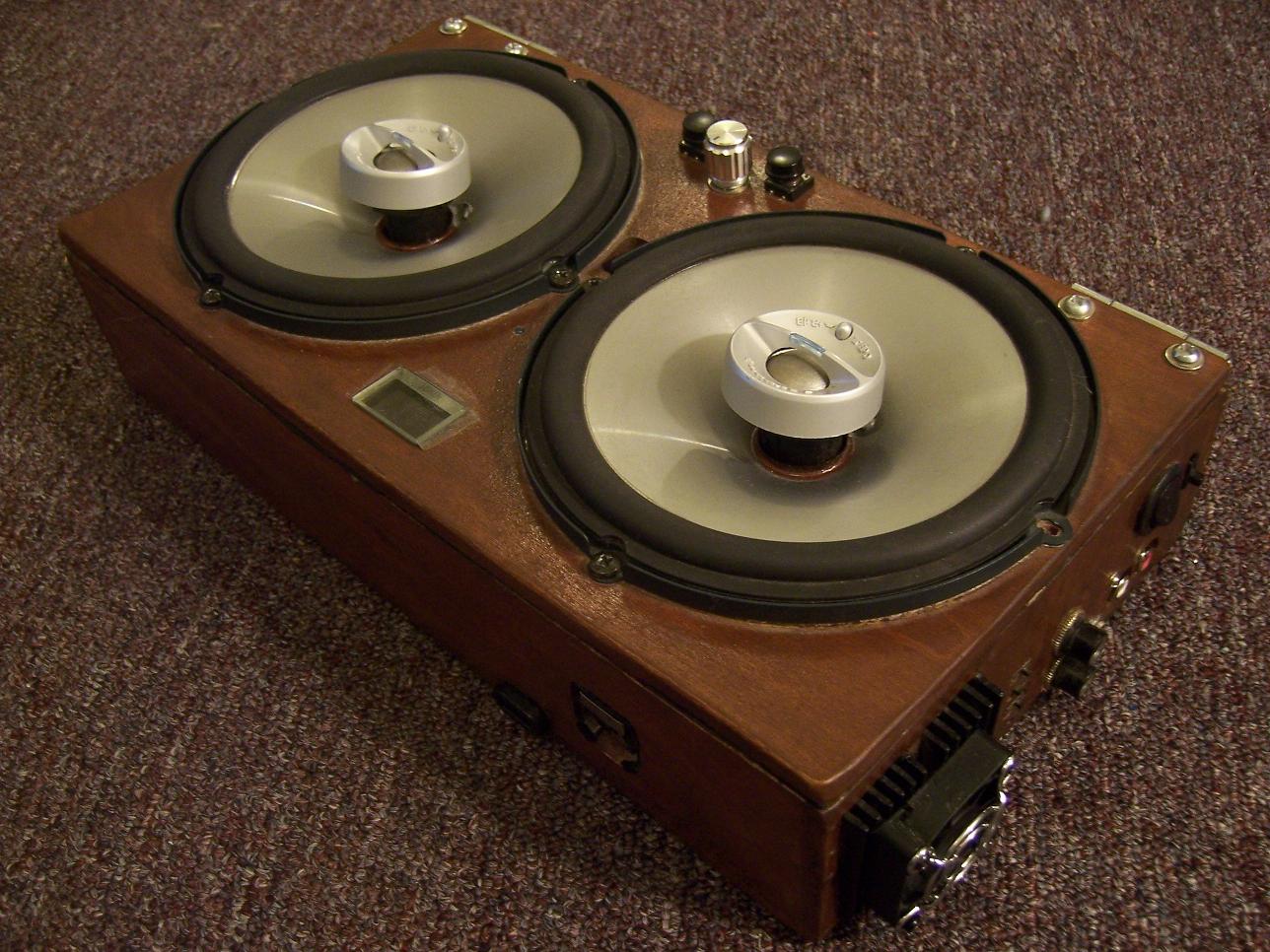

thanks for the clarifcation janneman.
VLSI, to answer your Qs:
What I would like to achieve with the amp is 10W+ per speaker (2ohm) or 20W+across them both (4ohm).
Battery last time: don't care really. If it's a high powered loud I'm happy with even 30min.
Battery voltage: I posted a schem on page one with the setup, it's a 12v 5A li-ion pack with a DC-DC converter upping it to 29v @3A.
When you say inverter loss on the parallel setup, do you mean it will lose output W?
The battery gets charged every day and it is used for a portable speaker system with two 6.5" Infinity speakers. I use it as a simple humble home audio system too (don't have the space, money, or interest in something more fancy.)
If I get 20W out of 2 LM3886s I will be happy. I am using an LM4752 now but greatly prefer the sound quality of the 3886.
So I guess I'll try a bridge setup to go with your recommendation. Do you know of any single supply schems for this? and do I have to create an inverted signal for the audio line level inputs like I have seen in some schems (using opamps)? I'm afraid I am not too familiar with bridge and parallel amps. My major concern with a bridge setup is the heat, I've attached pics of my project and as you can see the heat sink and fan setup might not be adequate for that much heat. The LM3886 seems to run a lot hotter than the LM4752 at the same output load.
The inside shows a pic of the battery. It is essentially the same thing you would find in a laptop only in 12v config instead of the usual laptop standard 14.4v.
