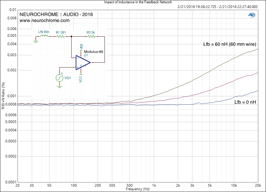

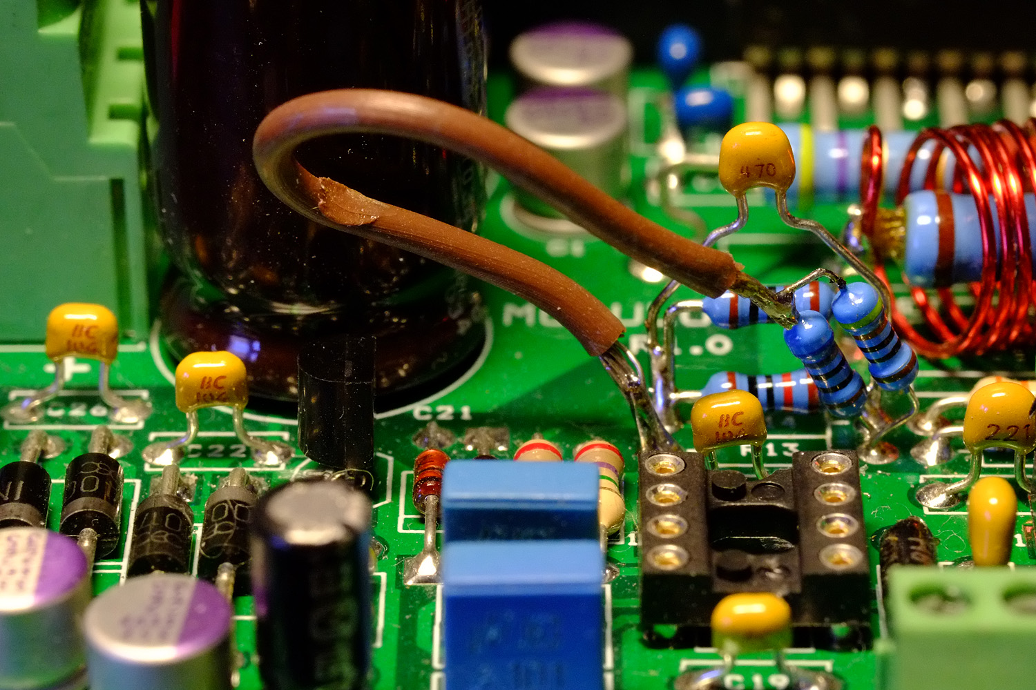

In case you are wondering about the impact of lead inductance in the feedback network, attached are some measurements.
The bottom trace shows the THD+N vs Frequency of my Modulus-86 R2.0 amplifier.
The middle trace shows the impact of the lead inductance of a capacitor in series with the feedback resistor to ground. The capacitor was mounted to the PCB Macgyver style with rather long leads.
The top trace shows the impact of 60 mm (~2.25") of AWG20 wire in series with the feedback resistor to ground. 60 mm of wire has an inductance of approx. 60 nH.
The measurement was done at 35 W output power into 8 Ω using 60 kHz measurement bandwidth on my Audio Precision APx525.
It is very clear that in a precision circuit, the layout matters. Even 60 nH is enough to degrade the THD by 10 dB at 20 kHz.

That's... not how physics works. Inductance obtains solely from a loop integral in Maxell's equations so a structure cannot have inductance intrinsic to itself---its partial contribution to the total loop inductance always depends on the field distribution created in conjunction with the rest of the circuit. In conventional circuits it's common to ignore this consideration when working with such partial inductances, thereby making an assumption the field of the embodiment is a good approximation of whatever standard structure the reference partial inductance was calculated or measured in. In this case the structure sounds typical of a common DIYer hack but I'm not aware of any partial inductance reference values for lead inductance within it.
60 mm of wire has a [partial] inductance of approx. 60 nH
Was this verified by measurement? The 1nH/mm rule of thumb for bond wires may be high by a factor of two or more depending on the geometry obtained by lead folding. 60mm sounds long for cap leads; if that's two leads of 30mm there may be another factor of two in play.

Assuming the folded lead geometry is consistent along its length you could work out the nH/mm by measuring at a few different points if you wanted to; measuring right where the leads exit the cap body would give reasonable ability to control for the partial inductance (ESL) of the cap proper. Note also inductance is a frequency dependent quantity with most structures transitioning between two asymptotic values at low and high frequency due to the shift from volume to surface conduction (so, typically, the lower asymptote is at more nH than the higher). Probably this isn't a big effect in this case but, if a ~GHz bond wire rule of thumb is being applied to ~20kHz here, it is an additional caution.
It's not really my intent to rain on the parade (even though I'm doing so 😉) but, in interests of offering suggestions towards greater clarity and robustness in the spirit of scientific peer review, I feel I should also point out the attribution is uncontrolled. Unbalancing ESLs by adding to R1 here reduces high frequency signal gain by -85dB from DC to 20kHz (-73dB DC to 80kHz), which has negligible effect on the 3886's local loop gain but might plausibly be expected to slightly increase the 3886's local THD as its ability to sense---and therefore correct---its harmonics is reduced as the gain rolled off. If this is the case, such errors should be attenuated by the control loop gain applied from the LME49710 in the Modulus-86. However, a quick look at these maths doesn't yield results in agreement with measurement, suggesting there may be other factors involved beyond uncertainty in the injected inductance. As the geometry's insufficiently described it's also unclear if the top and middle traces offer evidence to support or contradict.
One control I'd suggest, if there's interest in pursuing this, is measuring standalone 3886 behaviour to more accurately determine the amount and type of error being injected (an 19k:20k IMD FFT, for example, might offer helpful insight). Another is the hypothesis here predicts error should decrease as ESL is reduced or as feedback resistor values are increased. So one way round ESL uncertainties is to, say, double the 3886's local resistors, and see how much THD/IMD moves.
I measured AWG20 wire in college and found the 1 nH/mm rule of thumb to be a good estimate. The measurement was performed from 100 Hz to 40 MHz, as I recall, using an HP 4194A gain-phase/impedance analyzer. The inductance was extracted from the measurement using the equivalent circuits function on the instrument.
I didn't say anything about the lead length of the caps in my post from last night.
I just measured: ~50 mm lead length total. The cap was a Nichicon Muze bipolar. 1000 uF, 6.3 V.
I find it doubtful that the addition of a few 10s of mΩ to R1 will cause the rise in THD. That sounds like hand-waiving to me.
