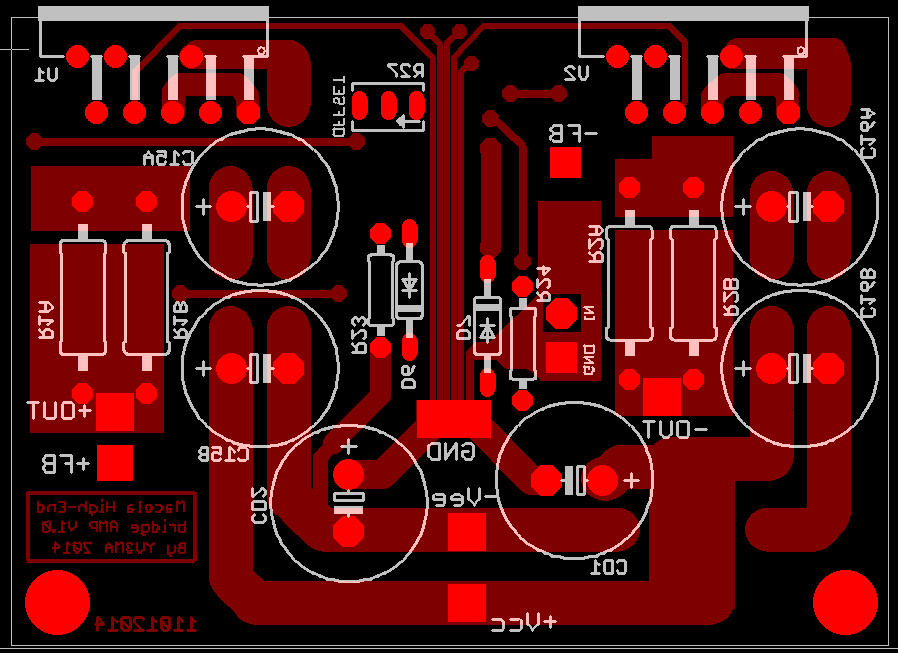

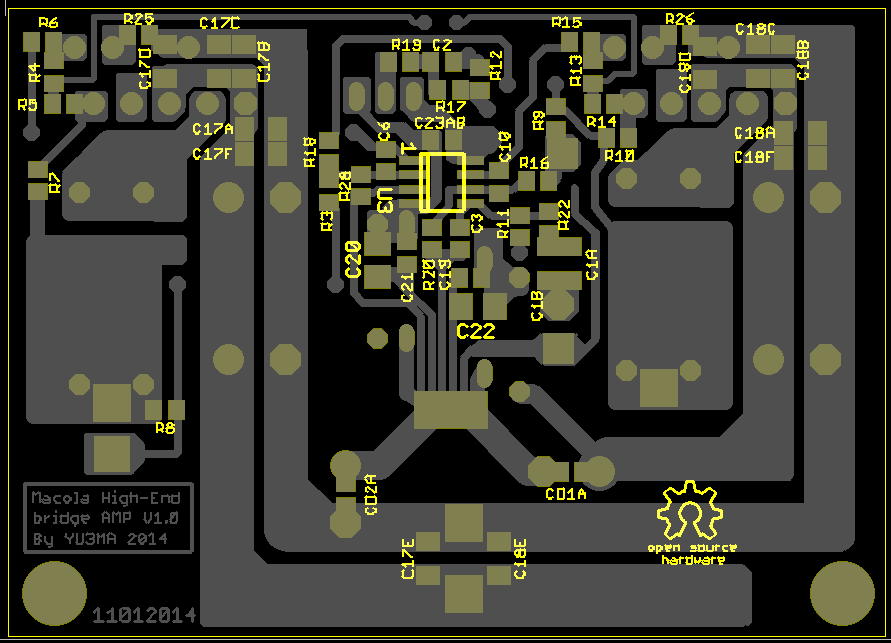

Here a little link to start about it (pcb version 0.8), uploaded below gerber and bom of v1. Just finished one, it works like a charm :). Got 5 pcb left if interested.
I don't doubt that it works, i.e. that the amp can move a speaker cone, but you will not get the performance you think you're getting. Specifically, you will get a significant rise in THD above 1 kHz due to the spider ground. You'll be hard pressed to even meet the data sheet performance of the LM3886 with that layout, even though it's a composite amp.
There are several other issues, but the grounding is the main one as far a THD is concerned.
You can get an idea of the layout's impact on the performance of an amplifier in this thread: http://www.diyaudio.com/forums/chip-amps/252436-lm3886-pcb-vs-point-point-data-3.html#post3846783
The images attached are the top and bottom layers from the .zip file posted above (converted to PNG).
