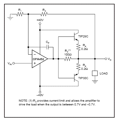

The output xsistors are pure class B
but the chipamp delivers class AB to
the load until ~ 0.6 V through the
series resistor.
Granted hyper ' gm doubling ( or somesuch ) '
but the opampness compensates .....
The amazing thing is you almost don't need
heatsinks for the outputs 🙂

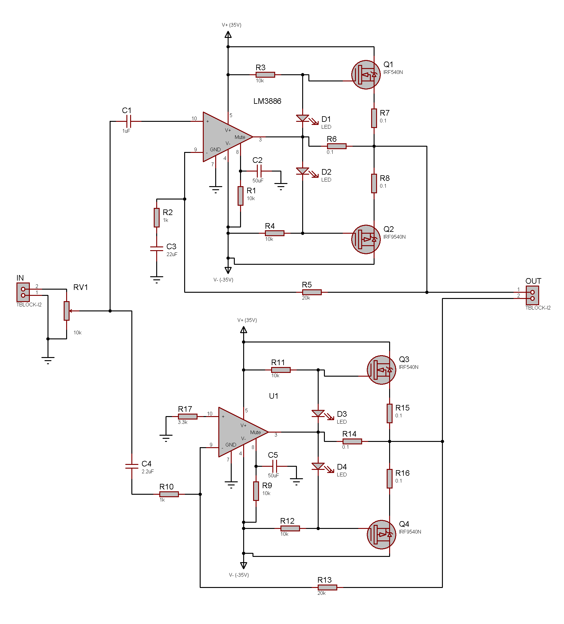

Thanks hitsware,
you are talking about the second type of design, right ?
so, according to you it would work ?
what modifications would you recommend ? (adding caps to reduce noise ? changing res value...?)
My voltage regulator work on a similar principle but with BJT, so i m not sure about the mosfet (but i m here to learn)
Not gonna work if Q2 and Q4 drain is not connected to negative supply....
0.6 V through a 0.1 ohm resistor is 6 amperes, or 288 watts into 8 ohms/144 into 4 ohms, both impossible to reach with the supply voltage in question. That is probably why the heatsinks are not required, the transistors never actually turn on.

Thank you very much sangram for this very seful reply.
My goal is to drive a lot of different paralleled identical speakers, thus felling to 2ohm. Wouldn t that kind of circuit be usefull then ?
I also have 0.4Ohm / 5W resistor;
would that be better ?
I corrected the mosfet connection (thanks for pointing that out, i was tired that night).
I ll have a look at your suggested reading materials, thanks again.

There is no protection for the output pair, so if you're using overcurrent protection on the power supply it should be safe.
AFAIK you have to be able to maintain a constant voltage at the gate of the MOSFET with respect to source to keep the device turned on (around 3V), and then as the voltage increases the device conducts more current.
That entire voltage is present across the 0.1 ohm resistor (or whatever you choose to use there). That is the problem with the circuit. A resistor high enough to create the threshold voltage will restrict the output of the LM3886 too much for it to be effective.
You can use bipolars in this circuit (I think) with a slightly higher value for R6 and it might work out. I'm not sure, but you also might need a Vbe multiplier like what Bas posted earlier, to protect the output pair. MJ2955/3055 SOA will not be much more than the LM3886 anyway, so it remains doubtful how useful the circuit will be.

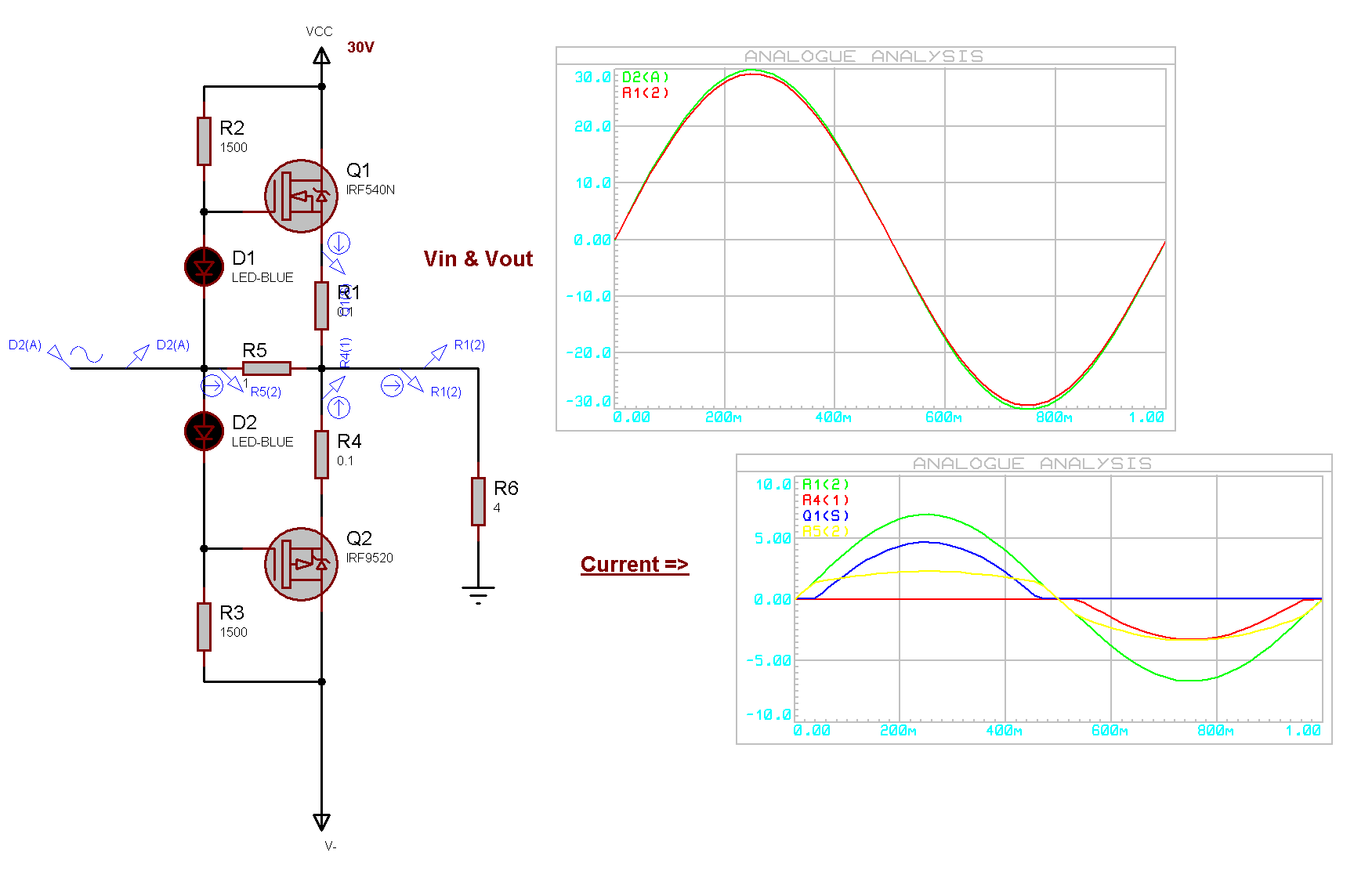

After investigating more,
in order not to waste the capabilities of the LM3886,
a circuit like hitsware suggest would work great,
with MOSFET it should work too,
look at the simulation I ran.
The yellow curve is the current from the LM3886.
That's a really poor way to design a high power output stage unless you're building specialty lab equipment where high frequency noise must be kept to an absolute minimum. A speaker is not going to care about a little ripple at 500kHz or so.
Please star882, be a little bit more precise than just "it s a poor way".
I don't have engineers knowledge so to me saying "it s a poor way" is useless,
I can't just guess why it would be poor. (unless your goal here is just to troll).
I'm here to learn, if people don't explain their comments, there is 0 added value to me.
Where is the 500kHz ripple comming from ?

It needs a charge pump to get enough drive voltage near the rails. Then it would be a good design for low power use.
It is very undesirable to operate power MOSFETs in a half-on "Tiffany Yep" mode, since they'll waste your power instead of using it to do useful work. (Unless you consider heating up your room useful work, maybe.) It is unavoidable due to laws of physics, but good high power designs try to keep that to a minimum. For audio, that means using a Delta Sigma modulator and high current MOSFET drivers.
