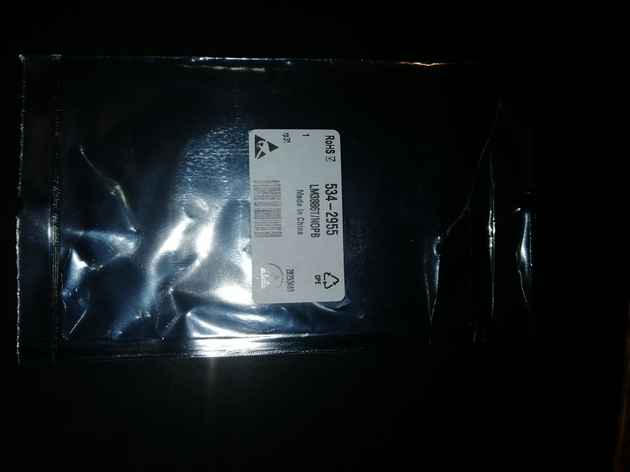

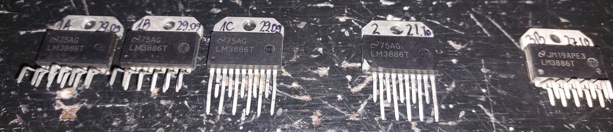

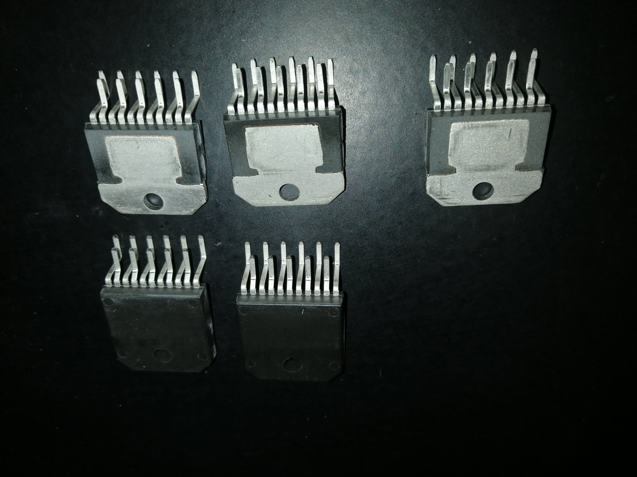

Hi, I purchased 3 batches of LM3886 with different prices and different look. I am afraid that all are fakes, I do not want to test them with putting in work, I want to avoid "explosion" in my home. All of them read ~2 Ohm between pin 4 (-Vcc), pin 7 (GND). Is it normal?
From where did you purchase them? If from aliexpress or dubious sites, might be they are fakes. But can't tell for sure.
You can use a mains bulb tester in line with mains in your amp with these lm3886, see if they sing or not.
I got mine from RS long back and they were genuine and worked well .
Yes it is Aliexpress, 3 batches, but the prices were from several Euro, up to 15Euro per piece. I hoped If anyone can give me measurement pin5 to pin7 from confirmed genuine one or confirmed fake one.

Here they are 3 different orders and sellers

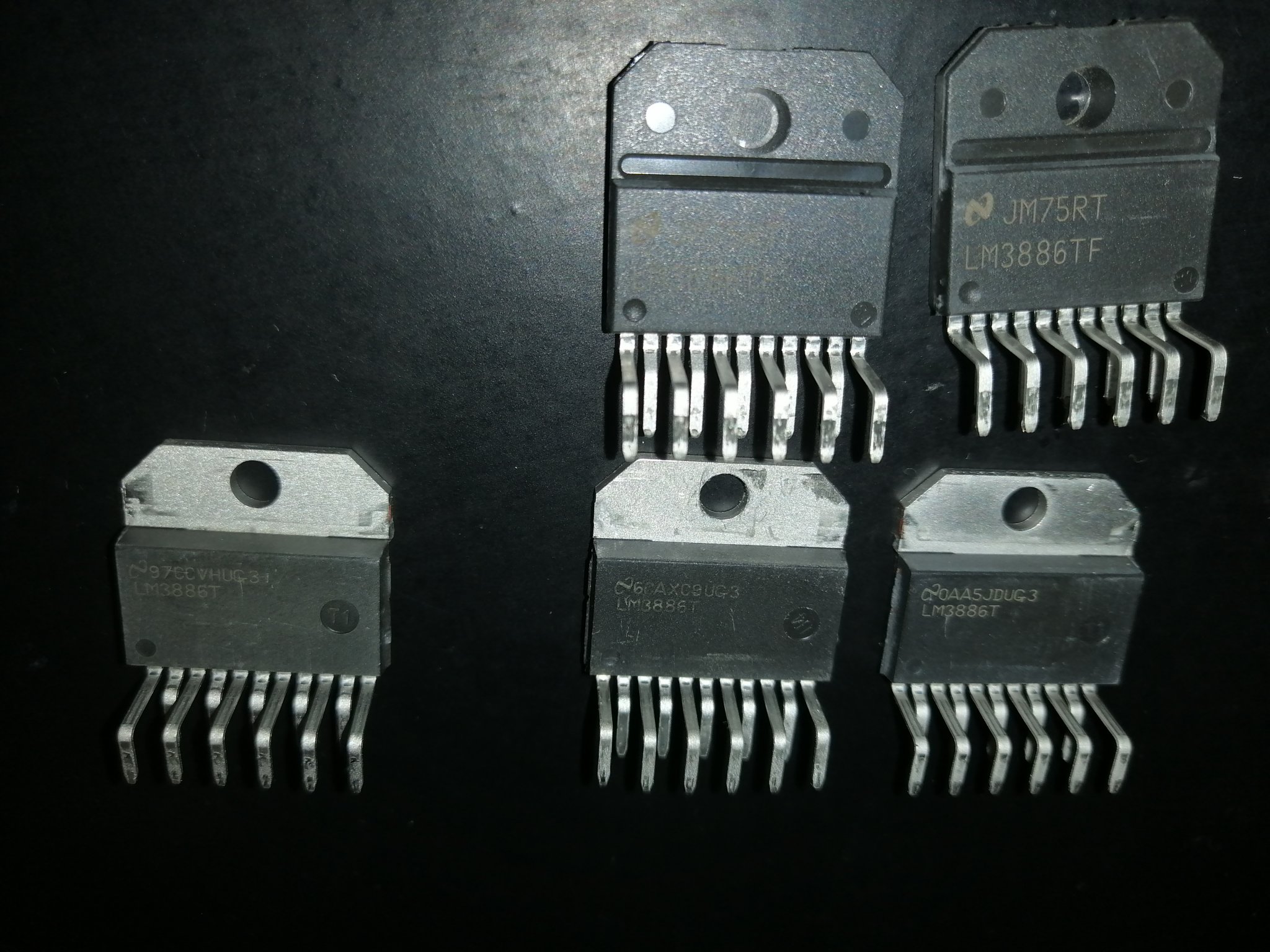

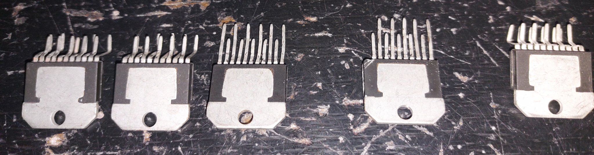

For comparison, here are some pieces from (in order from above)
two 3886TF from an italian webshop;
1 3886T is from RS
2 3886T is from Mouser
All shopped in 'above suspicion times', before the chip shortage
