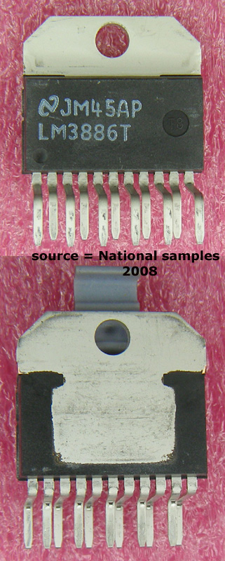

And his chips visually look like the family of chips with TF package from an italian small webshop in my photos - and those work perfectly in my amps..
but yes, his chips look different than the actual genuine Mouser, RS origin chips in my stack
Joseph's 3886T chips look authentic to me(right side) , Krume's lm3886T chips(left side) don't look authentic to me.
A few differences I noticed .
Heh, yes, You are right...
butt... 😜
here it is an older batch.. again faithfully well working..
But most probably it still looks a bit suspicious, Krume's chip
