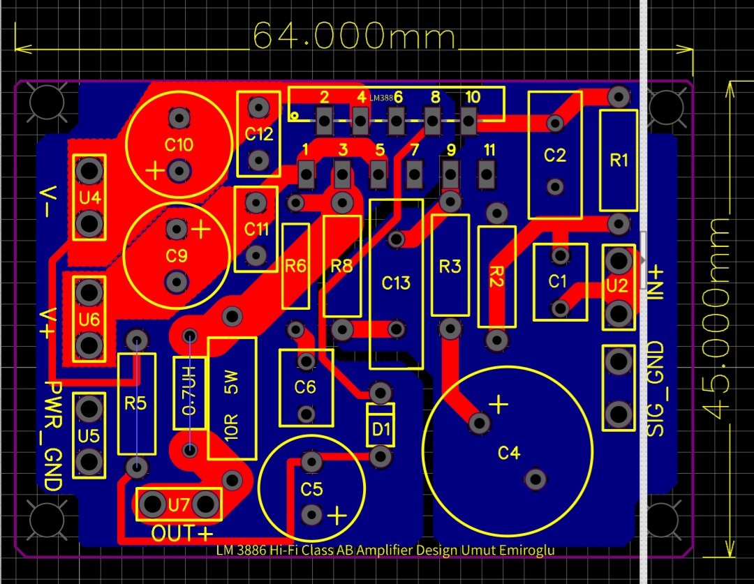

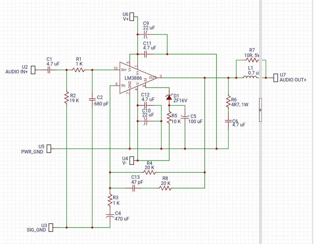

According to someone who understands LM3886 circuit diagrams, do you think this design is good? Is it worth doing? I wish everyone a healthy day.

I'm happy with it. My schematic is slightly different but nothing that would make a difference. I omitted the mute as I put a mute relay, some different capacitors from what I had in stock. It is stable so that is the most important. A bit larger PSU caps but that is more because I have 4 amps on the same psu for these active speakers.
Tasarımı küçük tutmak için bunu yaptım ve herhangi bir kapasitör eklemedim devraldım çünkü her kanala 80.000uf kapasitör ekleyeceğim.
:cop: English please.
I did this to keep the design small and didn't add any capacitors, I took it over because I'm going to add 80,000uf capacitors to each channel.

That circuit should work just fine. It's basically a copy of the circuit in the data sheet with some modifications to the MUTE circuitry.
I don't personally see the point of using a zener diode in the mute circuit, but some do set it up that way. I'd move the connection to C5 from the zener anode to the zener cathode. You do want the voltage on the MUTE pin to be somewhat clean.
