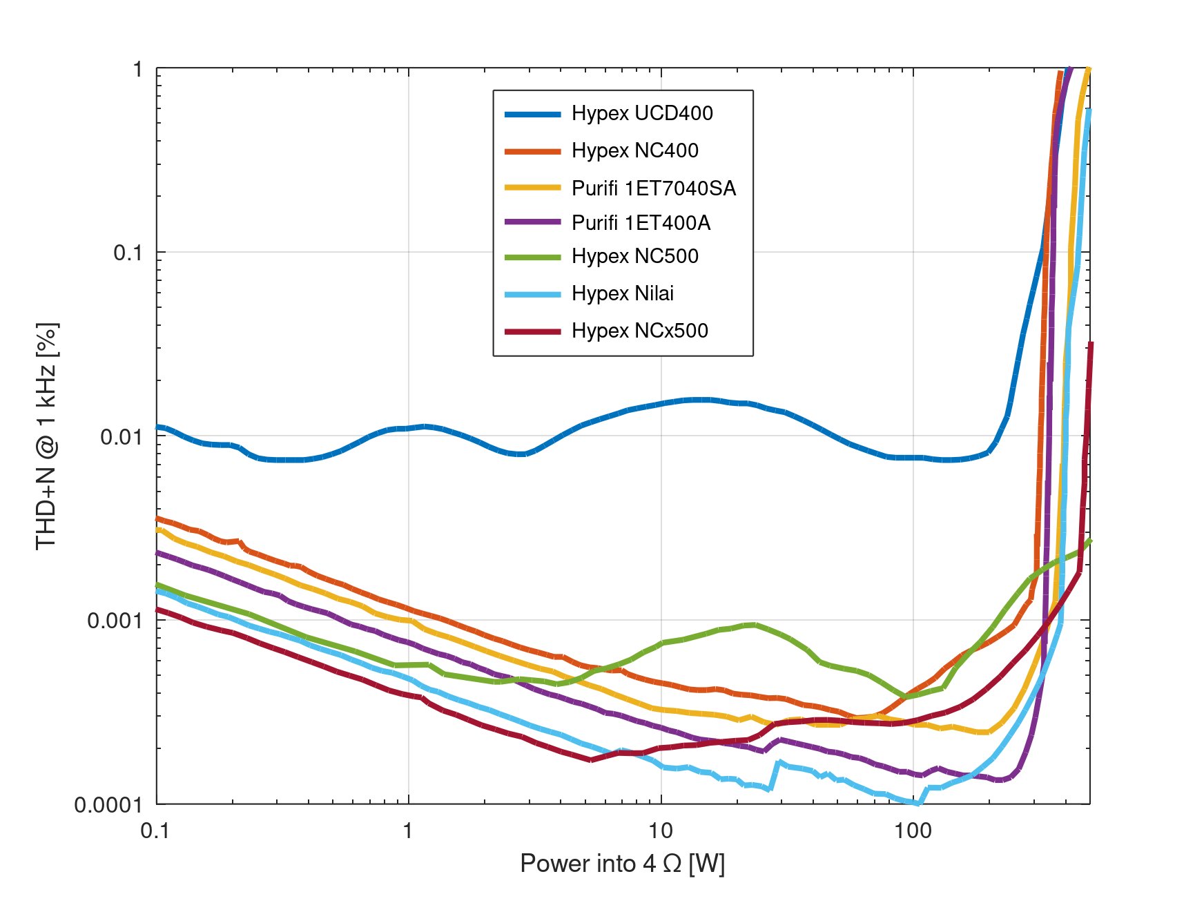

Those curves seems to originate from a thorough test that Amir from AudioScience made around Purify 1ET400. And they clearly shows residue
of the switching frequency around 300 KHz. But they don´t show any problems with that it modulates down in the audio range.
I don´t remember but I don´t think he measured the FR above 20 KHz. If you do so it will show ringing in the area around 50KHz, and personally I
am sure that this modulates down in the high mid band, and causes the ´ziing´ that many people don´t like in Class D amps.
The problem originate from the 12 dB output filter which isn´t steep enough to filter the switching frequency. I am not sure why it is only 12 db
filter, but in crossovers it is possible to cascade filters to get a higher slope further up, or just go with a higher order filter in the first place.

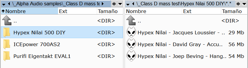

Youtube and 24/48 FLAC files
Is this what you played on your rig while doing the evaluation i.e. changing between the different physical amps or did you use these via e.g. headphones and made your conclusion?
Please try to be precise in your communication...
It looks like you used different recordings where the different amps was a part of the system recorded - is this correct?
I did it on my second audio system, the cheap one, with my modified coaxial KEF Q100, nearfield, (they have sounded even better since two weeks ago after flattening the acoustic phase with rePhase but that is another matter). Sound via YouTube is played by JRiver MC thanks to WDM Driver.
https://wiki.jriver.com/index.php/WDM_Driver
Then I downloaded the FLAC files and same result: Pass Labs XP12 preamp + Hypex Nilai500 was almost always the best combination (at least for the type of music I listen to, for electronics Purifi was a bit better, maybe because of more forceful bass, I do not remember, I was commenting on it in real time, Live chat and in my Twitter account).
OK. Judging individual component by replaying UT videos over speakers is as serious as choosing your next car by driving the model in a video game. Sorry, its just not possible and I think you should refrain for making such certain statement about power amps like you just did in the previous post.
Why do you keep repeating this kind of "consumer guidance"?.... https://www.audiosciencereview.com/...ilai500diy-modules.34024/page-19#post-1467312
At least, when you do it next time, please state the circumstance around your recommendations - so that the reder can judge how to treat them.
