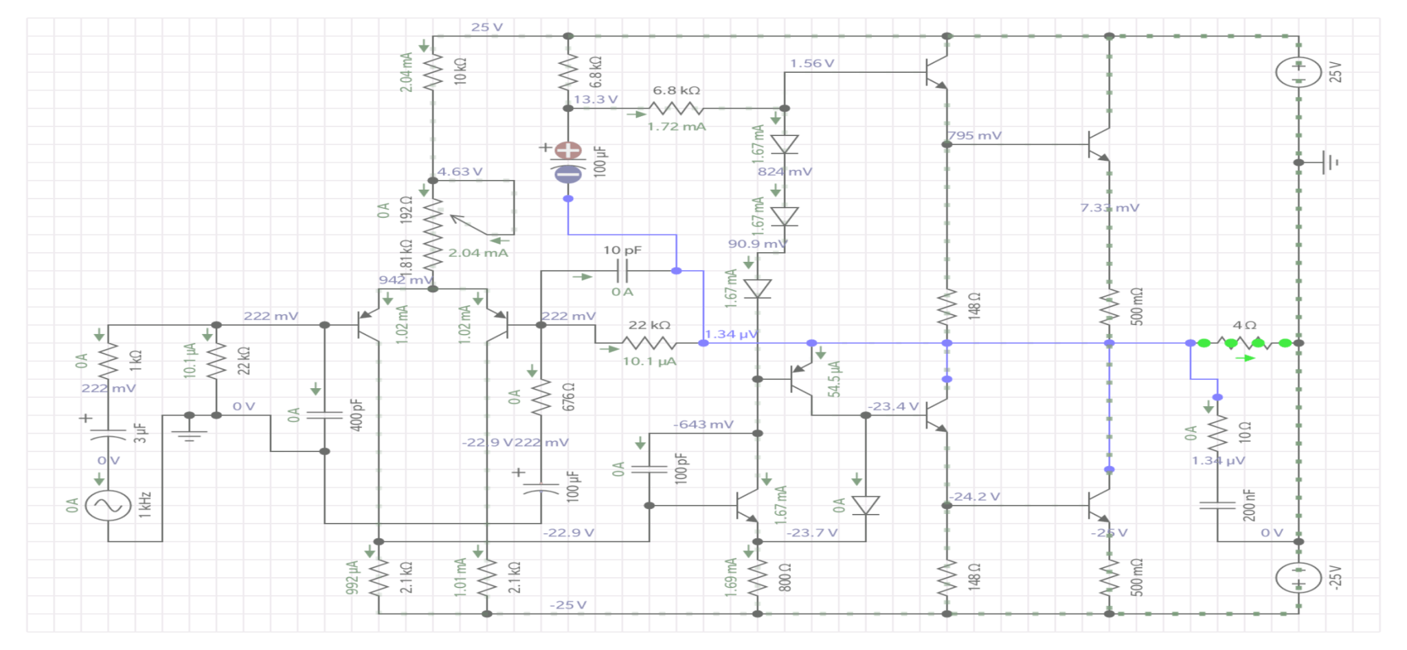

THIS LM3886 INTERNAL SCHEMATIC, copied from datasheet, and simplified, tested and cirquit is working, offset 0.1mv/1uma, output transistor under 80ma quiscent current, and output rms at 16volt/4ohm load sounds , love the frequency response itcan play lower 6hz that's amazed me ☺️
