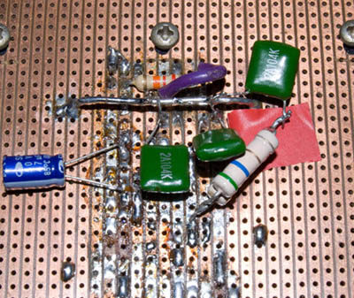

Hi again, are the tracks in the picture picking up the hum? Can you cut them close to the chip....
Just a note... It is very hard to see where your tracks are cut, the easy way would be to buy the special tool, or you could just use a 5mm drill, twisted by hand where you need the break in the track to be..
Please ignore and sorry if you already know this..
