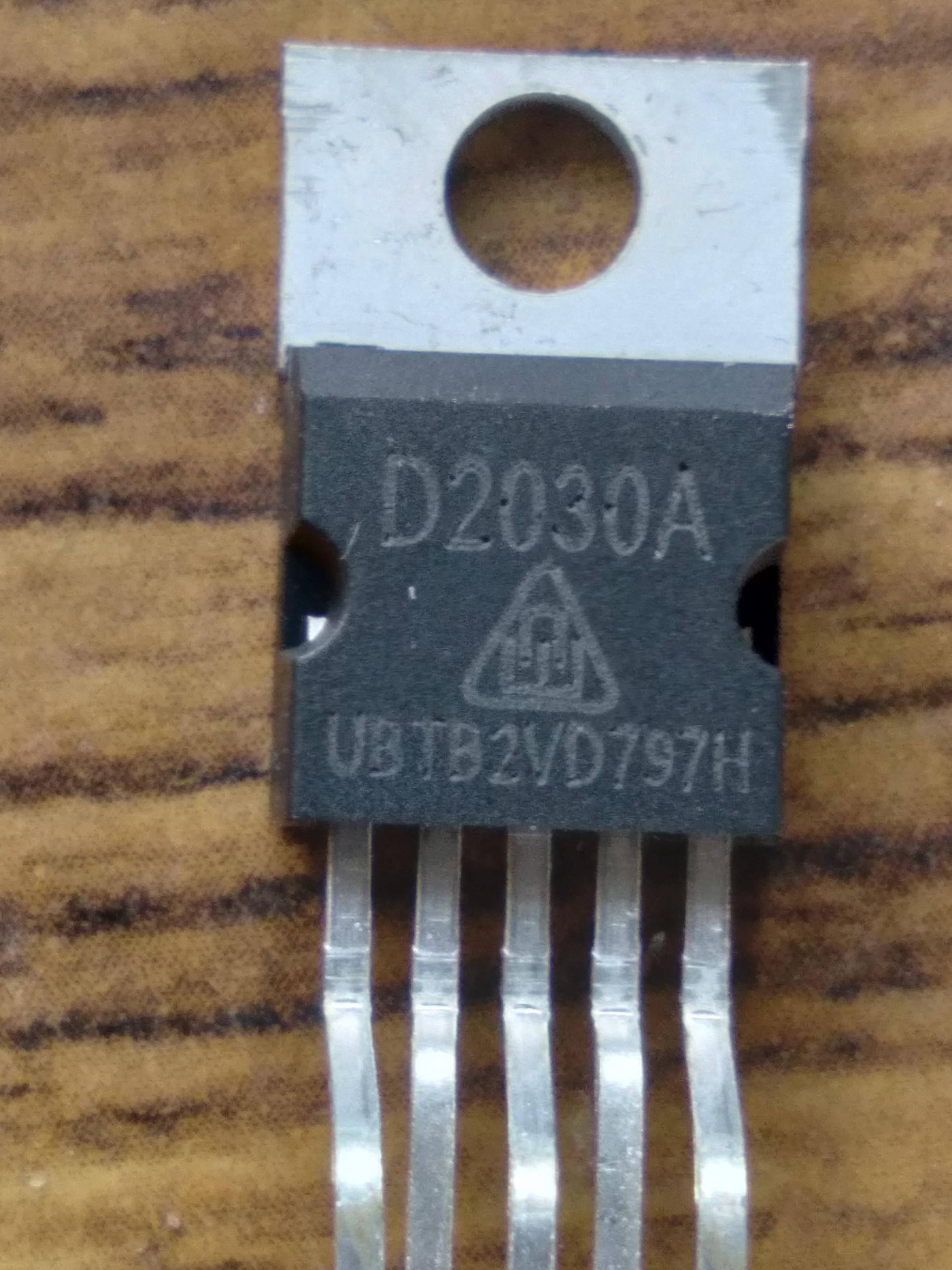

I have seen pictures (actually X Rays) of "ICs" with NOTHING inside, only plastic and unconnected pins

I doubt that some fab making copies would make “improvements”, unless it came as a happy coincidence. Maybe the breakdown voltage of the process would be better, or that their doping profile might result in higher hfe. It could just as easily go the other way.
Redesign like a smaller die wouldn’t improve anything - thermal feedback would be worse and Tj would be higher. Die attach processes used by copiers and fakers are typically much worse than those used by the big boys (processes and material sets can be closely guarded trade secrets, and not necessarily use the cheapest materials available). They would have to go out of their way to redesign an improved functional equivalent - and that would cost more than the original. Would people buy it if they did? Maybe us audiophools, but not industry - if it cost a nickel more than a current production ST part. I wouldn’t count on it being available.
Look what happened with STK modules. The “functional equivalents” are horrible. They blow up at the drop of a hat. You can make a better one yourself.

As of "improving" ... not impossible but I guess main commercial goal is to be able to replace originals, period.
Personally I don´t even demand a transistor by transistor exact copy, but a functional equivalent, a small 5 pin plastic case which takes +/-25V and feeds 4 or 5A peak to a speaker without exploding even under some abuse.
Motorola style low consumption and excellent ESD performance do not need to apply 😛
