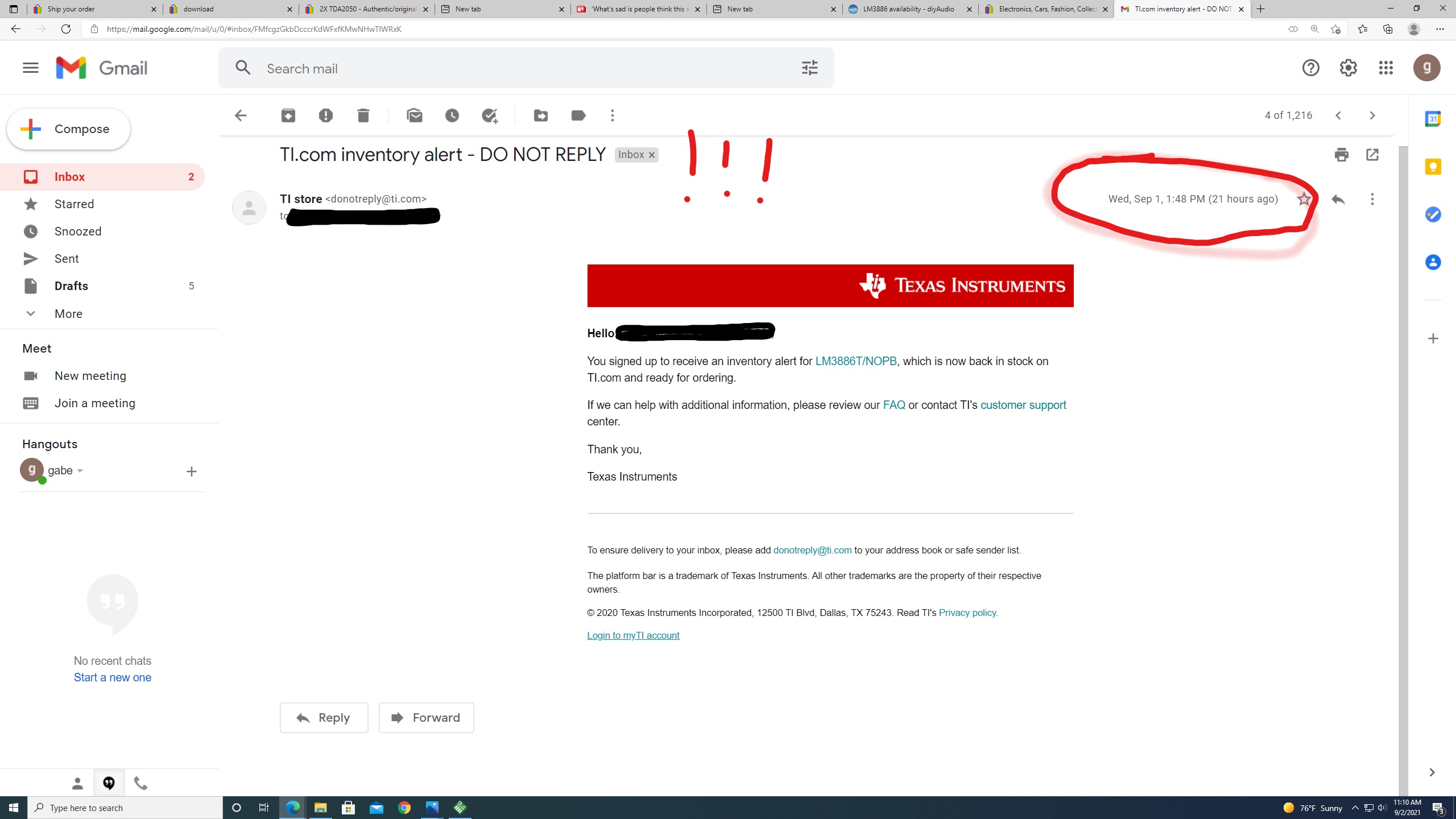

Right when I received this email from TI.com yesterday I went and checked if indeed the chips are in stock, but nothing... maybe it was a prank .
Anyway , I have some lm3886T(not insolated) if anyone needs some.
