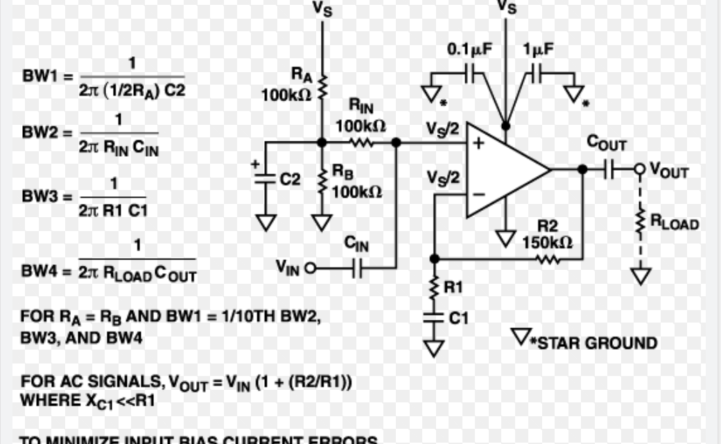

I personally think it's set it up like this photo. Those two resistors are likely biasing the input signal to at 1/2 Vcc instead of at 0.
The gain is likely set using the 50k one. I think it's pretty safe to mess with that one.. Problem is the input capacitor and whatever capacitor are close might be forming a filter network, so if you change one it could mess with the cutoff frequency of the amp.
I think it should be pretty safe to put a resistor in parallel with the large 55k one to test..

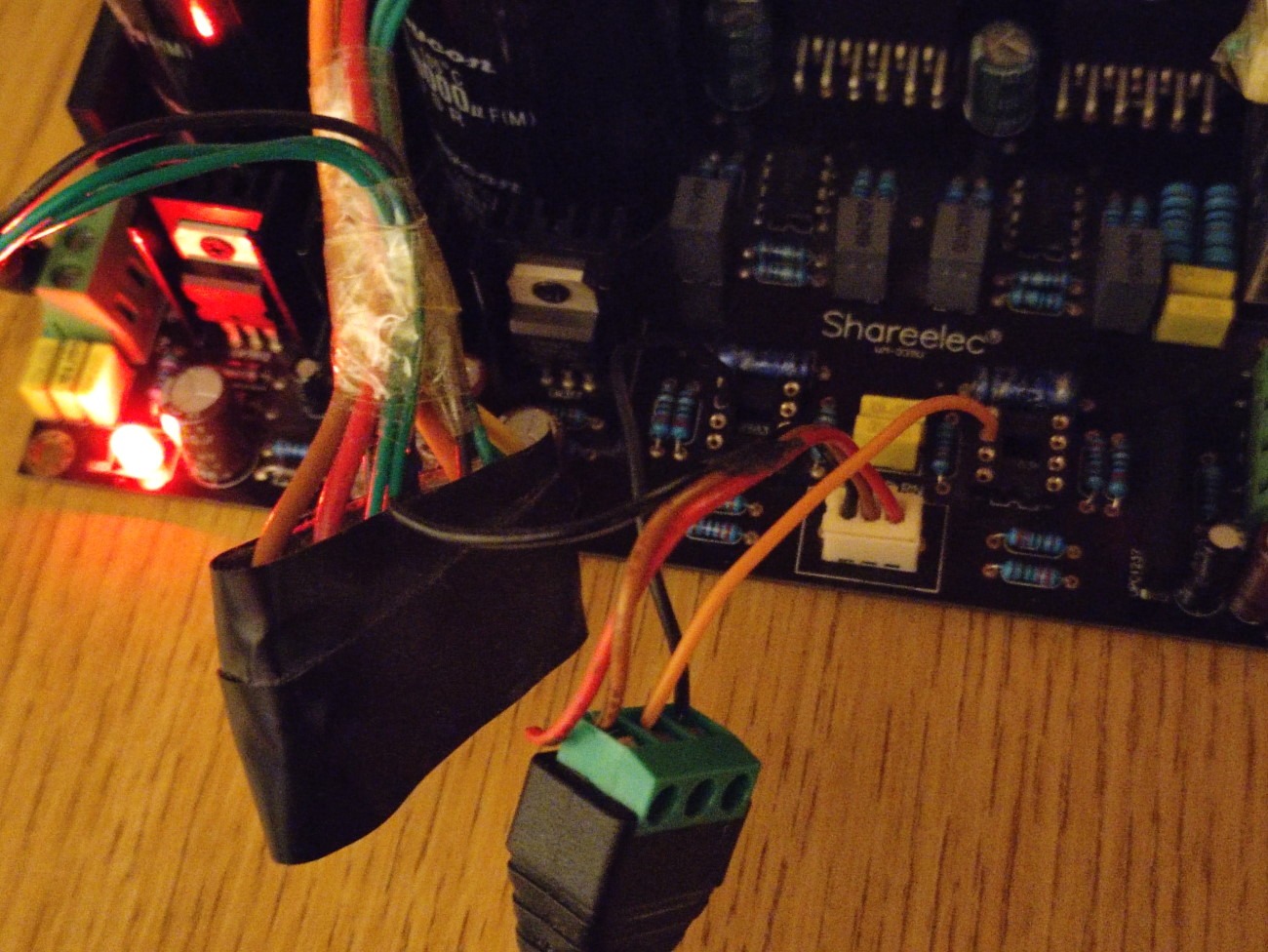

Absolutely, such modules were given for fun and experimentation. So, this is the "Look ma, no op amps!" post:
This is what I meant with my obscure earlier post about bypassing the preamplification stage. The picture was taken with the amp properly powered up, no op-amps, and my input directly to where the op amp outputs are. Music playing normally.
Damn, this thing sounds glorious. It sounds so great after another smaller class-T module I had hooked up while I was fiddling with the circuit.
Unexpectedly enough, the gain is the exact same. If there is any difference, it is very slight. Most probably loudness is the exact same and it's a psychological effect.
Now the big mystery is, what happened to the input impedance? I 'll use my crude testing method to test it out ASAP.
Based on that photo you posted, that pin is the input, no? That might be why it sounds the same. I believe both opamps are in the same orientation. You might want to try going directly to the output pin instead.
Both cables are on the output pin, although it's not very clearly visible with the black cable. It's black-left, brown-ground, orange-right.

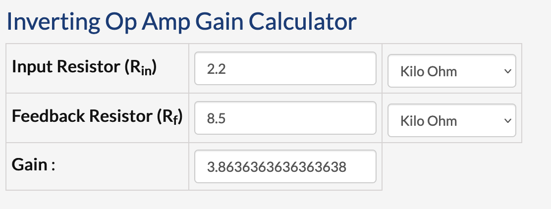

I'm pretty lost with regards to that op-amp then. When I looked at the colour codes, it looked like you had a 2.2k, 8.5k, and a 20k resistor.
If the 2.2 was input and the 8.5 output, that's a gain of around 4. But otherwise I don't know why you go those values..
Your color code identification and calculations match my measured gain of 4.22x then. Everything seems consistent, except my measurements on the board where I've probably made some erroneous assumption or other mistake.

Usually you just use an opamp with a gain of 1. It basically isolates the input from a high load and can handle a higher load output. I personally have been using a OPA2134 opamp myself since it's recommended as one of the best low noise audio opamps. With two capacitors and two resistors and an appropriate power supply you could set it for a low pass filter (22kHz).

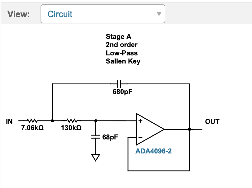

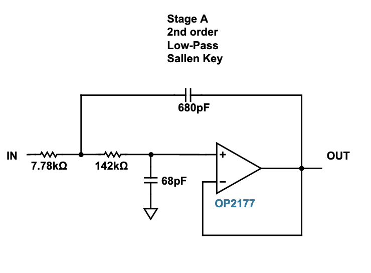

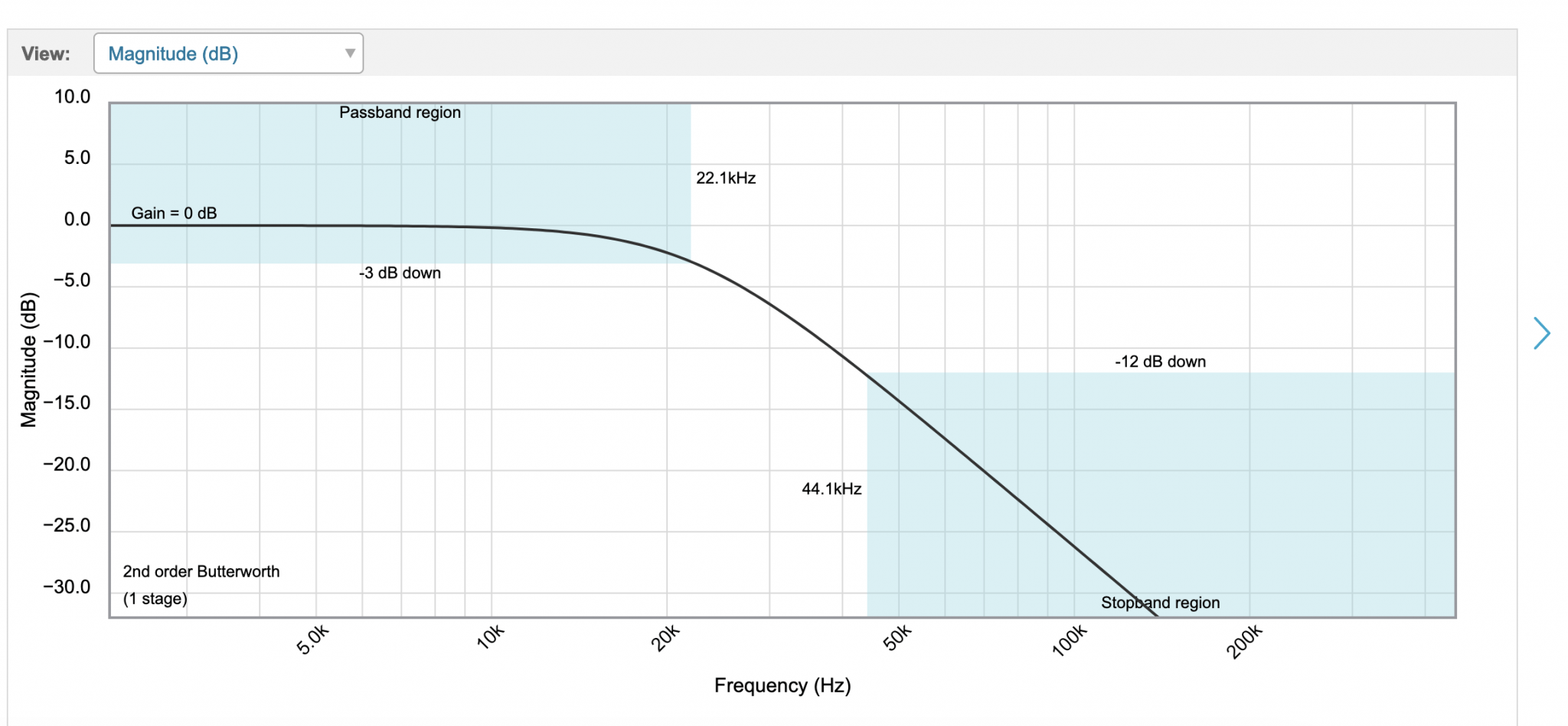

Something like this will have unity gain (won't amplify or attenuate), but will be able to higher more load at the output. I set it to have a passband from 0Hz to 22.05kHz. Basically because the opamp is active (i.e. powered), it doesn't care as much about input impedence of the next area since it has power to overcome it. Many times you'll see a opamp with a gain of 1, i..e a buffer, to separate a low impendence device from a high impedance one

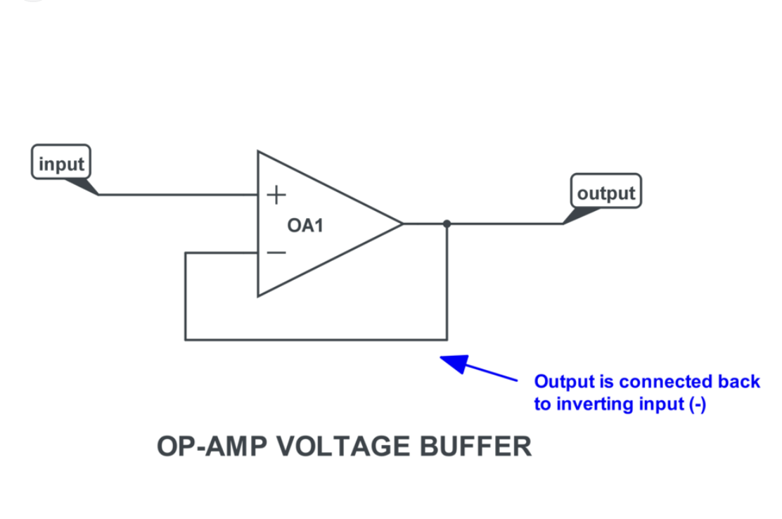

An even simpler version is just like this - it doesn't do any filtering, it literally just makes the output follow the input, but with more ability to drive a lower impedence load.

There seems to be a slight loss of very high treble but it should be ignorable. This would be a very useful module if I could put one together. What would be its input and output impedances? Also, power requirements?
You can modify the parameters yourself if you want. You can extend the passband out to 24kHz if you want, https://tools.analog.com/en/filterwizard/
Specs say about 40ma per opamp. The only trick is it needs a dual supply usually, so if your source is +/- 4V you probably need +/- 5V. You can attenuate it of course. You can also do it with a single supply, but it's tricker as you need to bump your signal up to a DC value, run it through the opamp, then us a DC blocking capacitor at the end to center it at 0 again.
The input impedence is high, often infinity on paper (as it's active, it can power its own output, which is why it's a buffer). It's much much larger than your preamp for sure.
You could experiment with using a voltage divider in front of it, i.e. a 30K and a 10K resistor, taking the input off the 10K, which is 25%.. that might balance out the 400% gain you are seeing.

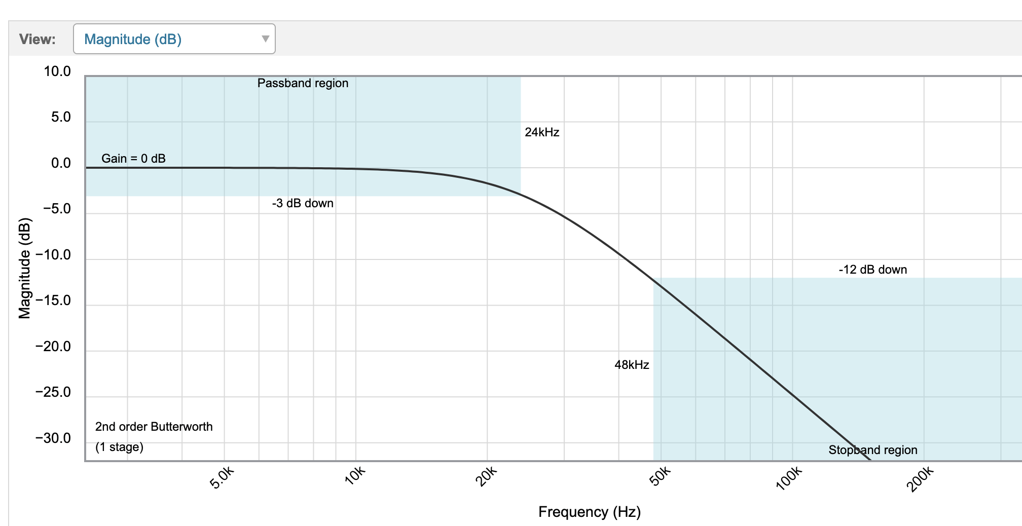

Here is a filter with a passband of 24kHz (that's the 3db point, so it's dropping there.. but for most audio, it's negligible there at that point). I personally can't hear above 16khz these days.
