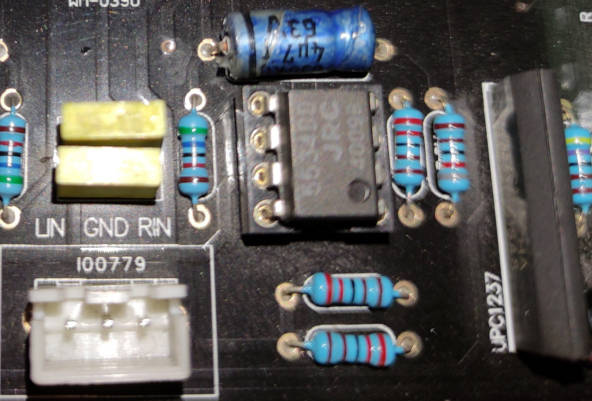

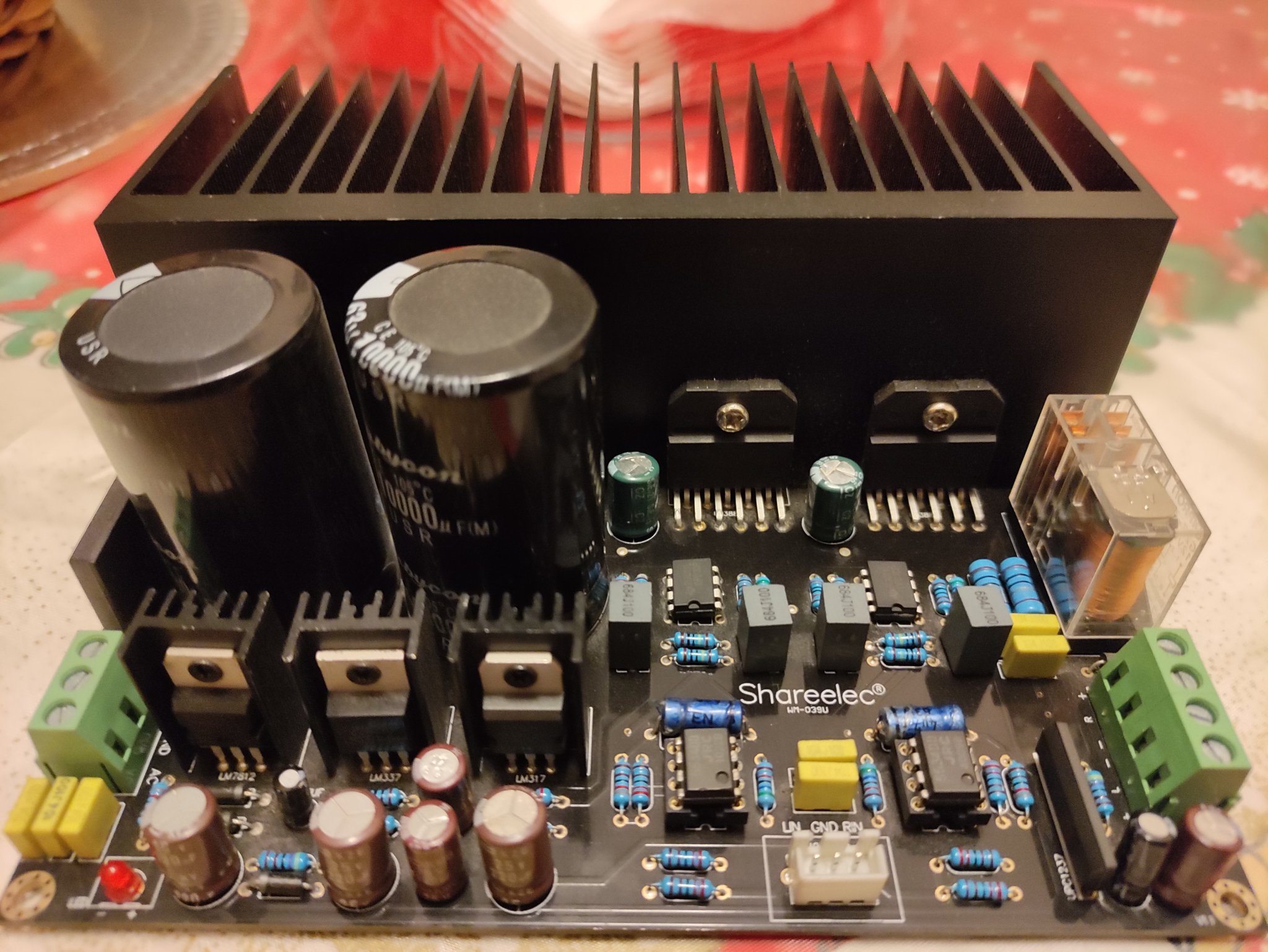

I have this LM3886 based amplifier board. I want to use a small passive mixer as a source for it. The thing is, the passive mixer has something like a 2KOhm output impedance, which is kind of high. So, thinking that I need at least 20KOhm input impedance at the amplifier input, I set out to find out what it actually is.
Checking the manufacturer's spec sheet did not mention input impedance. Upon inquiry, they mentioned that the amplifier has a preamplifier stage, and that its input impedance is 2.2KOhms.
Upon seeing this quite low number, I thought it was possible they didn't have a clue what they were talking about. So I set out to try to estimate it myself. I used the following video:
The trick is adjusting an external trim pot until the output amplitude is halved, then you can disconnect and measure your input resistance at the trim pot. The only thing I did differently was instead of using an oscilloscope to check output amplitude, I used a normal multimeter to measure AC rms voltage since I reckoned it's proportional to amplitude thus an equivalent measurement.
I used two test signals, one at 1KHz and one at 600Hz, of the same amplitude. Interestingly enough, my measurements for impedance with this method were 2.6KOhm @1KHz and 2.84KOhm @600Hz. The trick seems to at least yield higher impedance for lower frequencies and for certain the numbers are of the same order of magnitude as what the manufacturer claimed.
Now, supposing we have a source of about 2KHz output impedance, and an amplifier of about the same input impedance, what could I do to connect them without losing signal quality? I understand input impedance should be one order of magnitude higher.

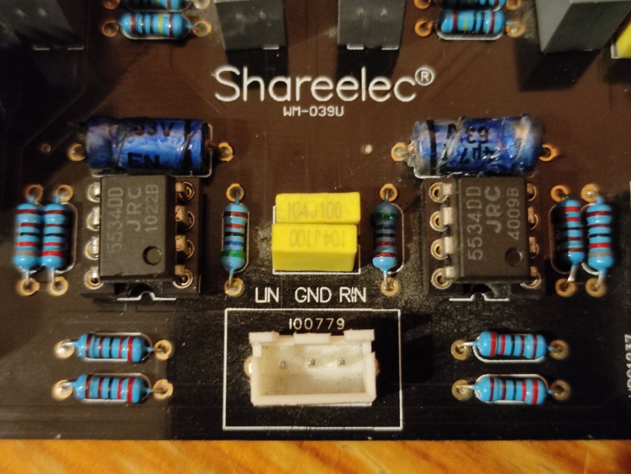

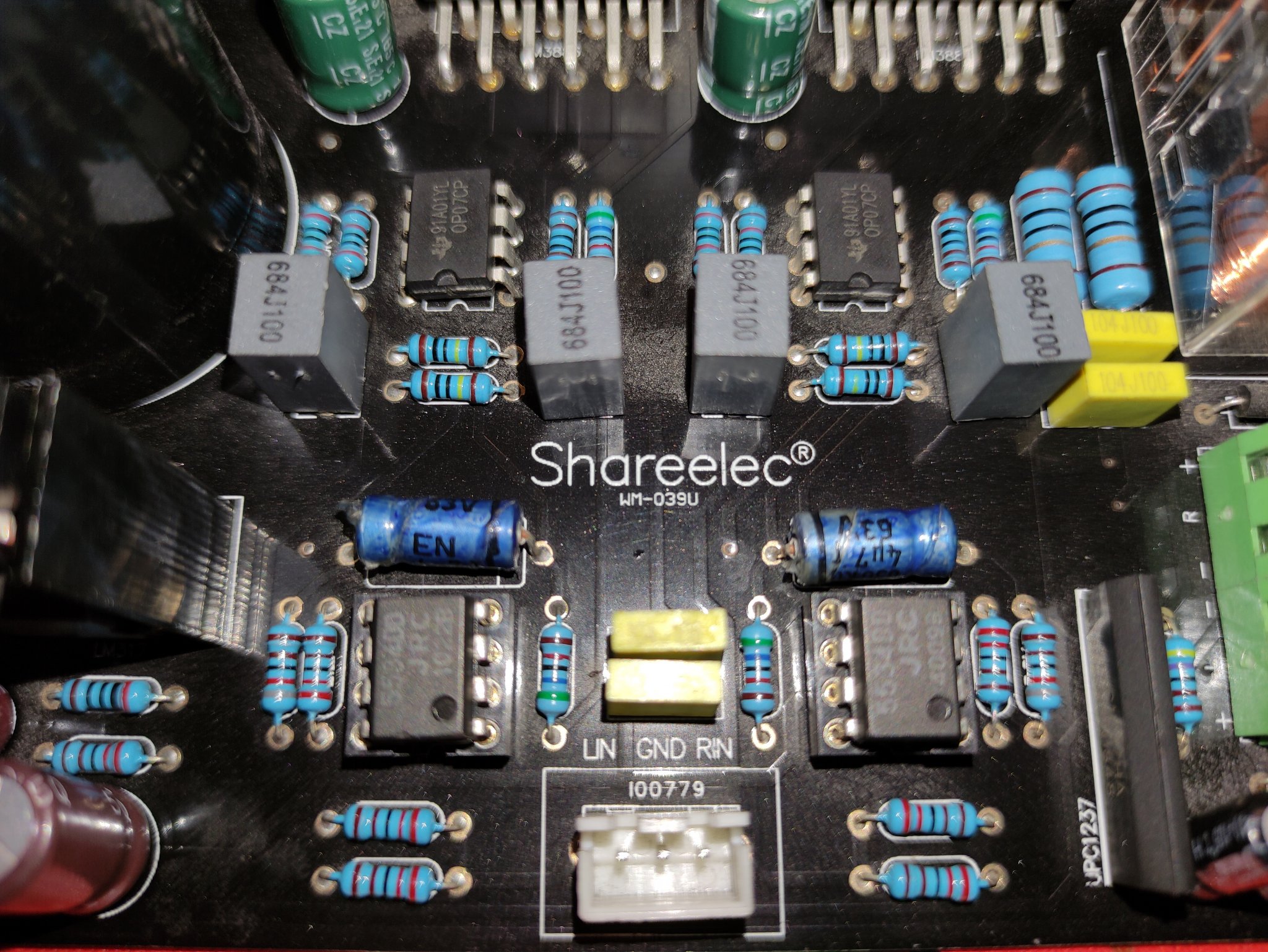

I have attached a couple of pictures of the amplifier board and its input stage. Near the input I believe we see the op amps for preamplification the manufacturer mentioned. I wonder, could one solution be tapping the circuit after the preamplification stage where it could hopefully have higher impedance?
A final note, this thing sounds fantastic but I always found it too damn loud. I have to lower the volume a lot on all of my sources for normal listening levels. This is why I suspect that bypassing the preamplifier could be the way to go.
Any info/ideas/suggestions are welcome. Thank you guys.

Your method is good, but to be absolutely sure it needs to be done with the amp powered and at very small signal levels. That amp is sold in various places, Alibaba and others, but nowhere can I find a schematic of it. They use quite opaque solder masking, so it's hard to see the traces. Still, if you could work out a schematic of the front end, that would be useful. I can be done visually and also by measuring resistance from opamp pins to the various resistors to confirm.

I'm just guessing here, but the two resistors on the bottom are identical on both side, so I suspect it's a voltage divider to use as a bias to the opamp since it's a single supply.
The other resistors in the circuit appear to be 2.2k, 8.5k, and 20k, if I deciphered the codes correctly. So I would think the 2.2k is your input resistor, and the 20k/8.5k are forming the amplifier part of the opamp. That ratio of 20/8.5 is likely setting the gain.

Probably so, if it's a single supply circuit.
The single supply bias resistor (usually 100k or so) to ground needs bypassing to ground, at least 0.1uF,
but it's better to use around 10uF. Do you have a bypass cap there? Omitting it could cause some hum.
If the amplifier board input resistor to ground is really 2k, that might cause some potential problems
with the source feeding the amplifier. Around 10k is more typical to use.

Pictures alone are not enough.
We need a schematic, but at least post a direct link to the original page.
2k range input impedance is WAY too low for a general purpose amplifier.
That coupled to the excessive sensitivity makes me suspect a Microphone input.

The problem is exactly that, source output impedance and load input impedance are matched and this is an audio application.You only need to match impedances if its a transmission line and reflections aren't wanted.
For audio I would use 10x output impedance of pre amp as input impedance of power amp.
It's quite probable you're right, although it was not advertised as a mic preamp/amp. Indeed the impedances I've seen on mic inputs are typically in the 2KOhm to 3KOhm range.Pictures alone are not enough.

The most important concern is input impedance and a fix for that. Lowering sensitivity would be nice but not necessary as the passive mixer attenuates about 12dB.

There´s something weird here which makes me think:
Not clear at all , but MAYBE it means:
* CS-capacitor direct connection = from input pin straight to LM3886 (high impedance) input pin, nothing else on that track.
-or-
* OS .... Op Amp gets in the path, but an improperly placed jumper might connect input pin to Op Amp output or to some resistor "it shouldn´t" ... or ... or ... or ...
Your choice, personally I would lift a capacitor or something as needed and connect PCB input pin straight to LM3886 input pin.
That should restore both proper sensitivity and high input impedance.

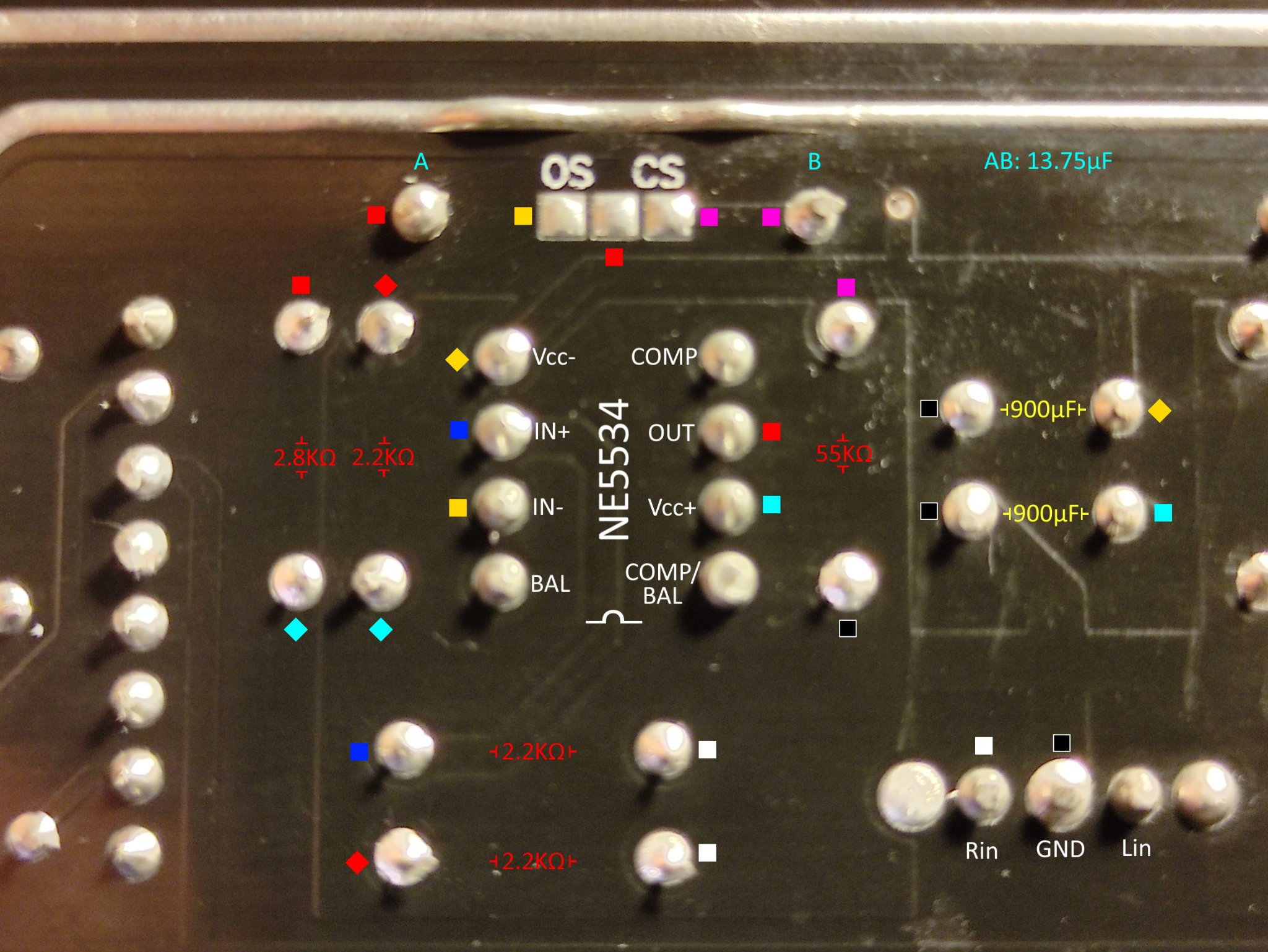

It seems you're good at eyeballing stuff, so I bet you recognize this (unknown to me) wiring of the op amps with a resistor/capacitor network. I presume this is a very standard circuit. Could you (or any other forumer willing to) point me to a schematic that closely matches the circuit at hand? I think it would be a great idea trying to understand this first input stage of the amp.I'm just guessing here, but the two resistors on the bottom are identical on both side, so I suspect it's a voltage divider to use as a bias to the opamp since it's a single supply.
The second picture I attached to this post, shows the bottom "jumper" pins. Until I get a response from the seller, I have no clue how to use them to change operating mode as described in the previous post. But I can tell for sure that the innermost pins are permanently connected to the innermost pins of the blue horizontal capacitors at the top, if that is at all useful info.

So I sat down and (hopefully) traced most of the right side of the input stage:
These are the connections I traced with my multimeter. Hopefully squares and diamonds work better than adding lines to the picture. There are also measurements for resistors and capacitors although I do not trust the capacitance measurements too much, especially the top horizontal capacitor (PCB is marked 4.7U at that point).

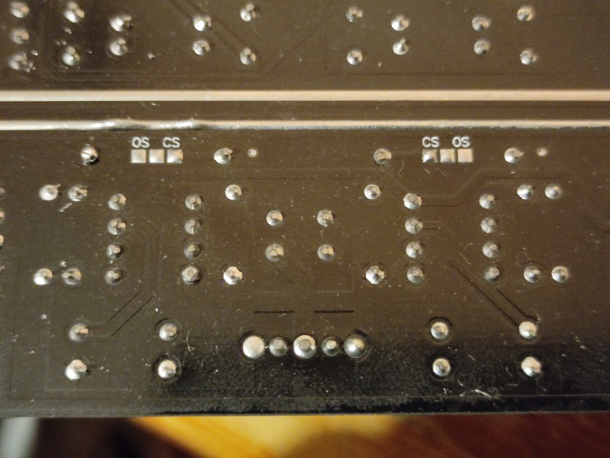

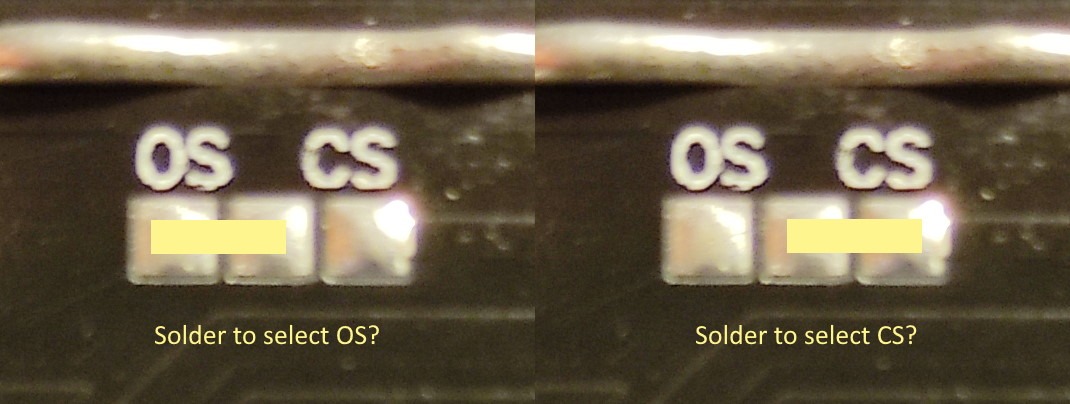

I have asked the seller which configuration (OS or CS) my board is at right now. They replied neither, so apparently the board can be in one of three possible configurations. I asked them how each of the OS, CS modes is applied, and I am awaiting a response. Although they said they do not recommend the change to either one, I don't know why.
I'm currently guessing the configuration mechanism is soldering the two left most pins on the board, or soldering the two right most pins like this:
This is what I sent them to verify the mode selection mechanism. But I don't know if given the above diagram something might blow up this way.
Just by looking at the diagram with my inexperienced eyes does give me some hints. The two caps to the right are probably stabilizing power to the op amp that comes from somewhere outside the picture. Earlier in the thread, a member mentioned I can replace input resistors to increase impedance (hopefully in a clean manner). Signal goes through a 2.2KΩ resistor then right into IN+ of the NE5534, so that's clearly a candidate for replacement. I have no clue where IN- input comes from however, or what other resistor I have to change if I change the one that goes to IN+.
I am guessing the output of this stage is pin B of the top capacitor, although I could not trace where it goes after this stage.
Any comments on what might happen if I solder the left or right pair of contacts? A reminder that the descriptions are:
OS: "Op-amp used for a buffer"
CS: "Capacitor direct connection"
Do these make more sense after the connections shown on the PCB?

Hey, so what is it you'd like to accomplish? Can you possibly redraw this as a schematic? Problem is you can measure continuity through components too, so it's probably distorting slightly what you think is connected.
The last thing I'd want to do is kill your amp, but if it was my amp I'd be playing around with it a bit.. I suspect if you take a resistor, like a 10k, and put in in parallel with the 55k one (touch both legs of the new resistor to both legs of the soldered one), it'll reduce the gain..
