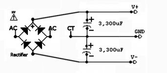

Synesthesia said:Really though, when I connect the negative wire to the negative end of the capacitor it becomes really hot. Is it possible that capacitors use a different system then what I learned in school? I was taught that the negative end gives off the electrons and the positive receives. Could capacitors go by the positive emits electrons and the negative receives?
No, no, no! Don't put the caps in the wrong way. The caps should stay cold. If they become hot, either the voltage limit of the cap (having a lapsus, I can't remember the word in english) is too low or you connected the cap in the wrong way. Minus goes to minus, plus goes to plus. Look closely on the cap, the marked pin isn't always the minus. If you put it in the other way you can get a very unpleasant explosion which can really hurt you. The voltage drop can be caused by this. It happened to me many times due to polarity reverse by mistake.

I recommend you to go back to Nuuks informative site, for some more time until you really understand the basics.
You have mentioned several times that your transformer doesn't have a "ground" wire.And you also questioned why all the transformers simply can't have two input and two output wires.
You are so close to solving the problem there(I suppose).
Your transformer has 12.6-0-12.6Vac secundaries.When rectified you are supposed to get aproximately 18-0-18Vdc.
When you make the dual supply PSU,you will have +18,0,-18.The zero there,the third wire is your power ground.
So, you can see the three wires are needed.(Or a transformer with four wires,or two transformers with two wires.) but you have a transformer with three wires so let's concentrate on that.

And be aware of the potentials. The cap with (-) at V- connects with (+) to ground. The cap with (+) at V+ connects with (-) to ground.ratza said:No, no, no! Don't put the caps in the wrong way. The caps should stay cold. If they become hot, either the voltage limit of the cap (having a lapsus, I can't remember the word in english) is too low or you connected the cap in the wrong way. Minus goes to minus, plus goes to plus.
Maybe it is easier, if you imagine that you are building two separate DC supplies. And when they are finished you stack them (electrically) on top of each other, i. e. V(+) of one supply connects to V(-) of the other and that connection is at the same time your ground potential.

What are the benefits between a 2 diode rectifier approach (one on + and one on -) and a bridge rectifier (4 diodes)?
the two diodes are a full wave rectifier.
the Bridge ensures the transformer is equally loaded in both windings and is more efficient in delivering full power, except for the extra 700mV diode loss.
There is a third option, two bridges, one across each secondary and then series coupled on the DC side.
