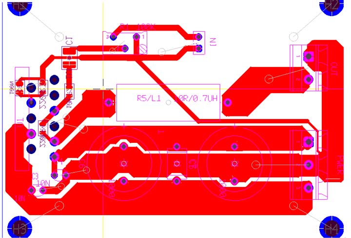

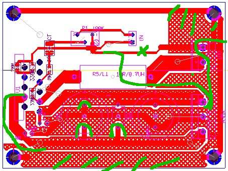

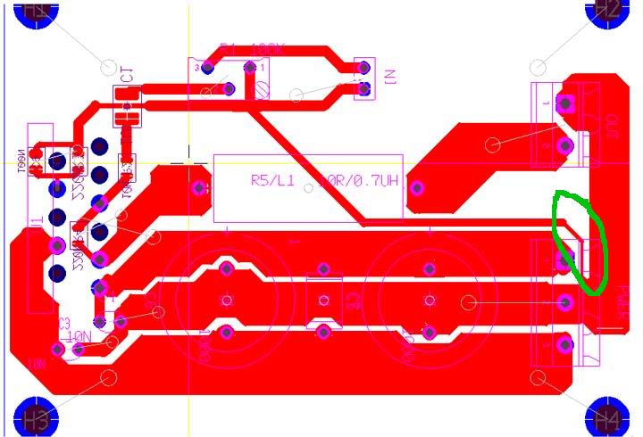

It looks better.

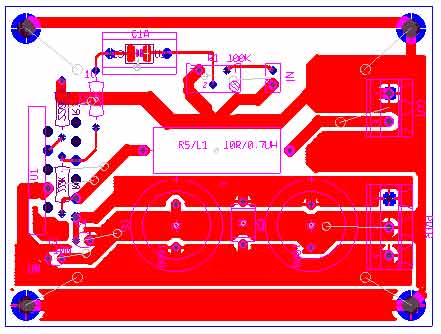

Sorry I didn’t mention it on the first place. Keep traces connecting the 1000uF caps wider. There is enough space. The gnd plane on the lower part of the board is not that necessary. No high impedance there. Same around the speaker output. Actually adds more capacitance to the load. If you are going to use gnd plane use it around the input stage (relatively higher impedance) rather then the power supply and the output (make those as wide as you can). Think of them as pipes. Any narrow section will limit the current flow. Also, the speaker and the input share the same gnd loop which is not good either. Run a separate trace (it doesn’t have to be wide because the currents are small there) from the gnd-star to the input gnd. And use that gnd connection to connect the gnd plain for shielding the input stage. I suggest you download and study AN-202 from the Analog Device site (http://www.analog.com). Do a search for it. It’s a pdf. And always refer to it. I find it very helpful.
Hope I didn’t confuse you more.
Greg
Greg
Regarding out and in of the amp having common gnd loop: Works like this. If the pipe from the main to the house is not large enough, every time you take a shower upstairs and someone uses the washing machine downstairs at the same time you’ll be pretty upset because of the inconsistent water flow. So whenever the speaker needs more current the input of the amplifier will be affected. So the larger the pipes the less interference but the best is to use separate pipes from the main to the washing machine and to the shower.
The schematic is very simple so there are no reasons not to have perfect PCB layout.
Greg
Greg

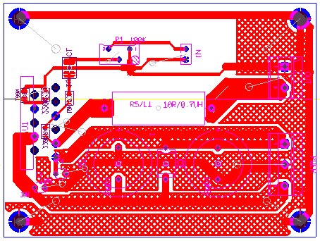

Yeah, reminds me of college -- 8 of us in a suite -- if someone you didn't like was in the shower we'd coordinate flushing the toilets on a couple floors (this is the days before cell phones!).GregGC said:Regarding out and in of the amp having common gnd loop: Works like this. If the pipe from the main to the house is not large enough, every time you take a shower upstairs and someone uses the washing machine downstairs at the same time you’ll be pretty upset because of the inconsistent water flow. Greg

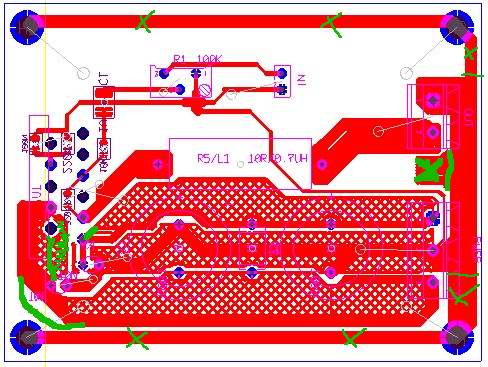

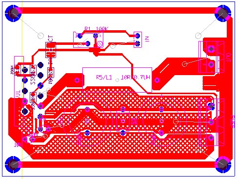

OK, You are almost there. If you leave the gnd connected to the four screws you may get some funky ground loops. I’d use paralel RC group to connect the star to the case and isolate the input connectors from the case too. I’d try to clean the area around the + and – power pins of the chip. I see some funky little trace there. You don’t need gnd plane there. The signal gnd looks fine. If you can make it a bit wider would be nice, but it should work fine the way it is. Keep it the same width all the way. On the picture it looks a bit narrower at the gnd star. Of course all the traces will be solid. I didn’t check the correctness of the connections (I don’t have the schematic) but I’m sure you’ve dun that.
Good work!
Greg
Good work!
Greg

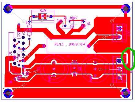

That looks great. O, I ask you to make the signal GND the same with. It just bugs me that way. It’s contra-intuitive. I know that it may work just as well, but I would correct it. And don't forget at the end the paralel RC to metal case and keep the input connectors isolated from the metal case.
I'd like to know how it sounds.
Greg

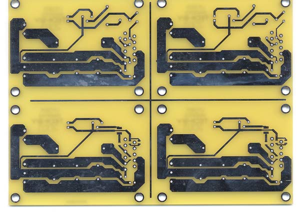

helps to have a gerber viewer too -- "all is not as it appears" !
i suggest that anyone following this oddysey download "Viewmate" (it's a free Gerber viewer) --
The pictures you are submitting are in jpg format, so I don’t think gerber viewer would help much in this case. I do have a gerber viewer but unless you post the gerber file I can't use it
Greg.
Greg.
I post-process to Gerber RS-274, then look at the file with "Viewmate" -- saves tears.
